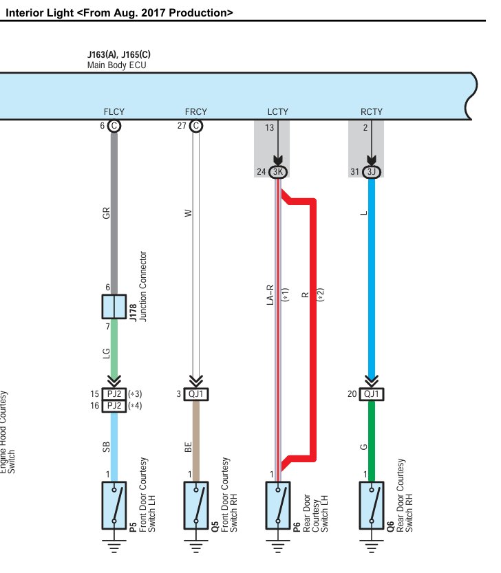

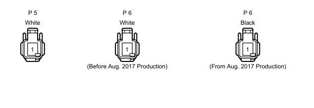

    Welcome to the forum.
    I would pull each door switch and test it with a DMM.
    Check for power and good ground.
    Bypass the switch to another ground and see if they come on.
    Be a little odd that both switches are bad..:confused:
