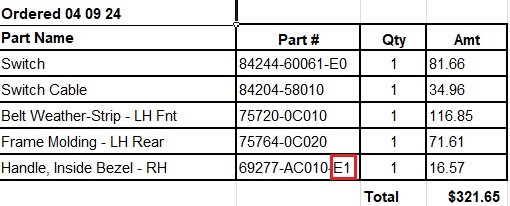

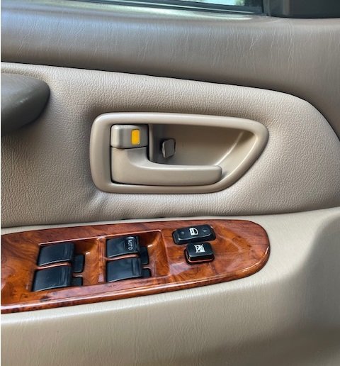

    If you're definition of "beige" is a light brown, Toyota labels that Fawn E1, which is what I ordered last year from Ourisman for my passenger door....69277-AC010-E1 which fits 04-06 and 69278-AC010-E1 for driver door. If he orders B1, he'll get gray.

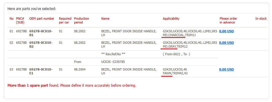

    Shit. So @lorenzor512 listen to Bubba. I just edited my post to give you the number/color choices - it may not matter, and my next reply will explain why, although I mentioned it above. I'll explain this in a sec what I saw, @BubbaW, in the next reply.
    Yes, looking at EPC, this is what barfs out for front door without using his VIN (i.e. using the links above), which does the lookup using only the model/chassis code, not the explicit VIN. Underlining the pertinent bits of what happens without using his VIN here: You get three different color options.

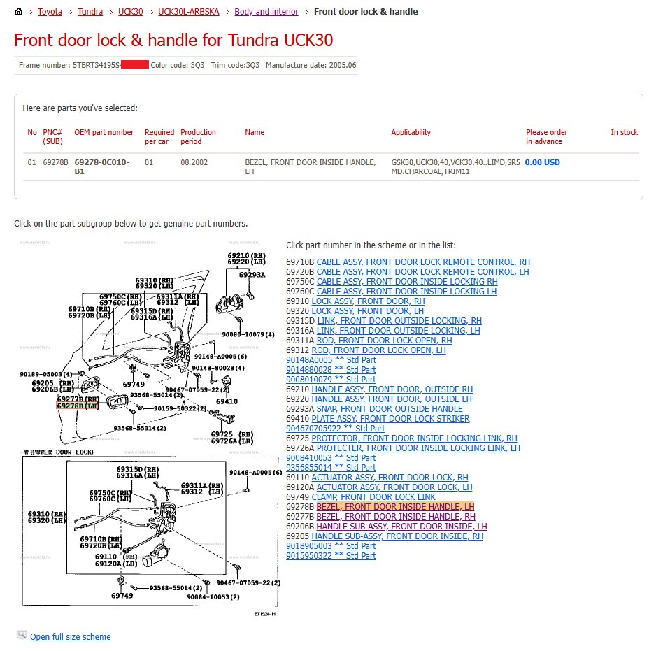

    Now, this is what the system spit out with his VIN. Only one option. And the option is Med. Charcoal, as if his truck has FB11 or FB12 (same as my truck).
    I've obscured the VIN for privacy reasons. Note the color code and trim code EPC has in the system, both are 3Q3 (Salsa Red Pearl) I haven't seen that before, and wonder if it's related. Glitch in the system?

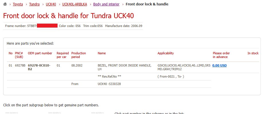

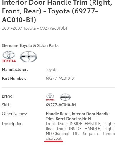

    Last but not least, run that part number, and you'll see why I told @lorenzor512 that was the number.
    I see what EPC says, but this is what Toyota says for its part, and I think it's for the reason I supplied in reply #2 above: Toyota has started pumping everything out in beige, it's exactly what happened with my rear half-door window latches.
    Do I understand why? Hell no!

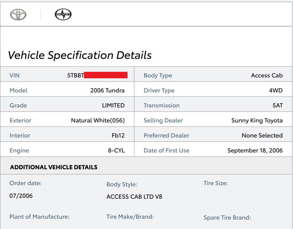

    Quick comparison on that. It's saying my color code is correct (Natural white / 056) but it also lists my trim code as Natural white 056 ?!!
    And it dfinitely gives the correct color part in the return.
    Data on my truck from Toyota with the interior (trim) and exterior (color) codes.

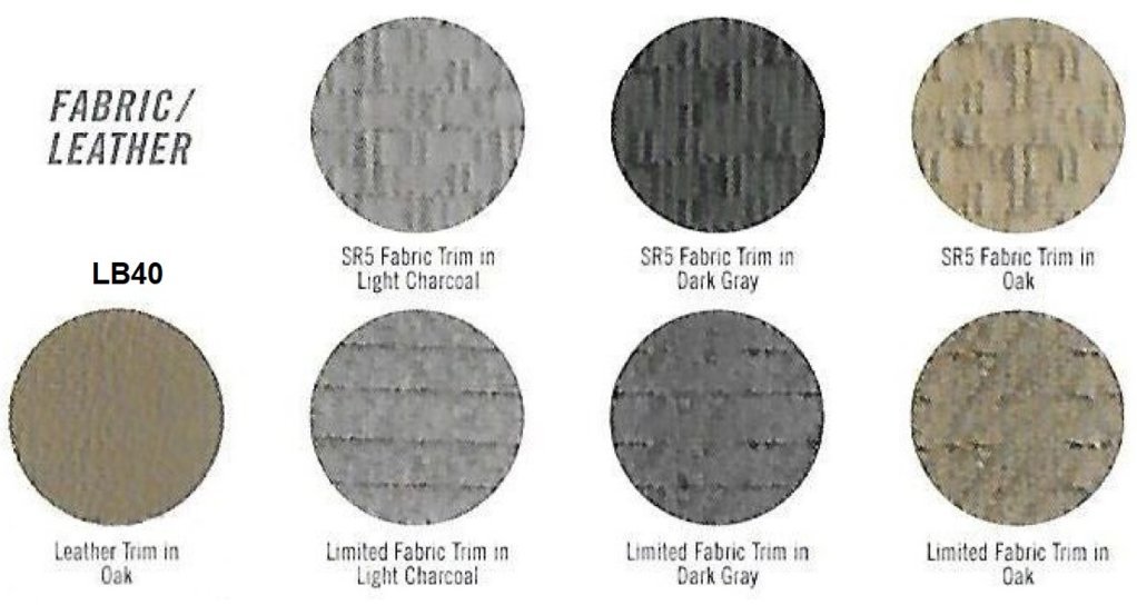

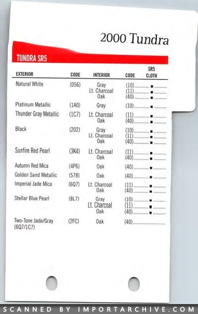

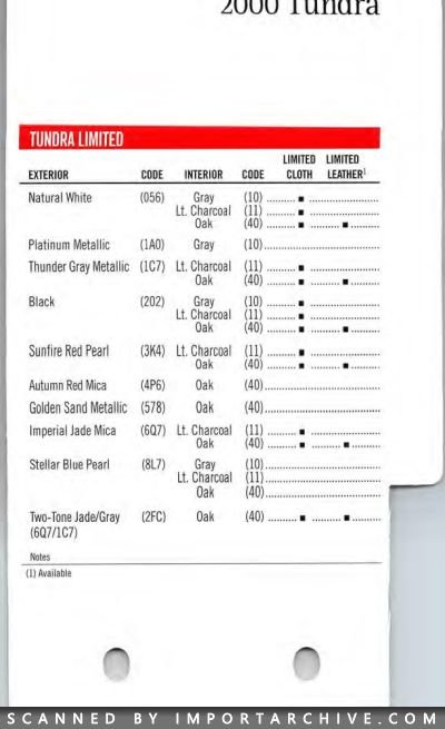

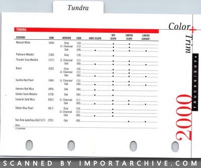

    Yep, found that out a few years back given greater % of our items after 25+ yrs are NLA.
    Back in the day,...
    1X= gray family
    4X= brown family, which is what my 04 interior is.
    colors:
    0x = Ivory/light colors
    1x = grayish colors
    2x = black color
    3x = reddish colors
    4x = browns
    8x = blues
    https://partsouq.com/ gets it more right than EPC for my purposes, which I recommend if anyone ever asks. Searching part categories way easier than EPC but that's a personal opinion only.

    looking up a few things over the years, and trim is b/c/e for families. I noticed that third letter because of Moon Mist, I think? Like maybe there was a "blue" family or something.
    They couldn't make it any more confusing, really. Even though I know we've rehashed this topic about 100 times.

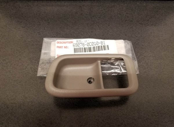

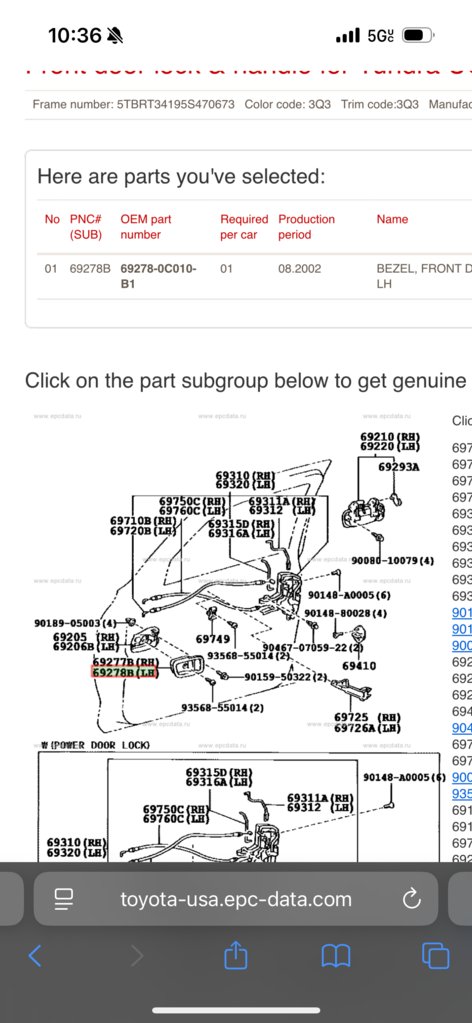

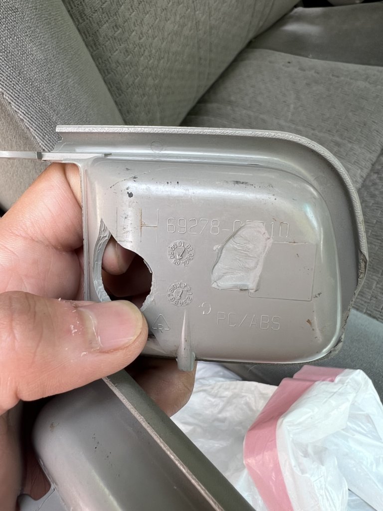

    thanks yall! I went with the B1 as EPC suggested (md charcoal per Toyota). I guess my old bezels looked md charcoal, I’ll live with my choices either way:cool:

    Good call given that’s in the gray family as are your fabric seats and not in the brown family.
    BTW, did someone use a crowbar to remove that ? Plenty of videos showing how to properly remove that and the door card if you need one.

    Looks like someone ripped them off for sure lol they cracked where they screw in and eventually broke off. Saw some videos on YouTube seems easy enough thanks!
