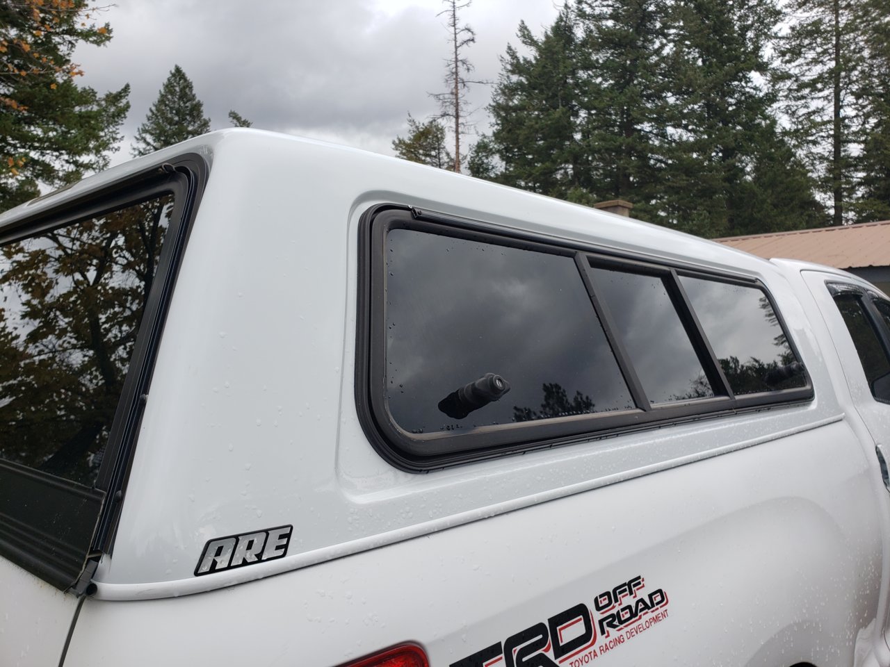

    Looking at adding a Yakima sliding rail system to my ARE topper. Has anyone installed it themselves?
    Dealer quoted $400 installed for rails only. No towers and no crossbars.
    Not alot weight will be up there, just need a place to store fly rods in the summer....

    There is a YouTube video about the install. I believe they used a specific Yakima rails that is made for fiberglass topper. They basically drilled into the topper and used rubber washers and sealant to make it waterproof.

    When i bought my 14 tundra up in Kalispell the topper came without the rails, even though i had requested them. A very reputable shop in Missoula installed them for me, and Toyota paid for it- unfortunately they leaked after a few years but luckily I was able to get it covered due to the issue and having a dealer install them (not normally the case).

    Got ahold of the ARE dealer in Kalispell. They carry Rhino systems in stock and installation of the system is only $200. The leaking was the main worry for me installing myself.
    Watch a video on YouTube, and im pretty sure it would take me a bit to install myself correctly. Just going to take it in the spring, before fishing season.

    I've got a Rhino rack to install, just haven't done it yet. My buddy who owns a truck shell sales company said if it's got "carpet" on the inside of the shell, have someone hold a piece of wood tight to the underside to reduced the drill getting tangled in the carpet.

    I installed Yakima rails myself. The sealant come with them. The hard parts, my cap has a thick section in the middle, don't drill the holes through the transition bevell. Also nothing is square, hard to get consistent measurements. If you have someone to help hold a straight edge, no problem.
