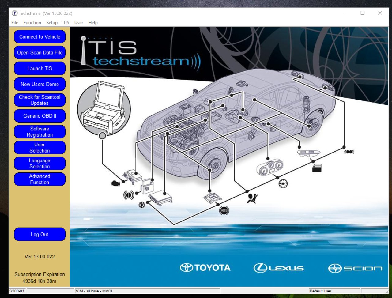

    Mine installed/works fine. 64bit version 13.00.022 in windows 10.

    did yours ask for a key

    yes, and techstream.exe and mainmenu.exe were swapped out
