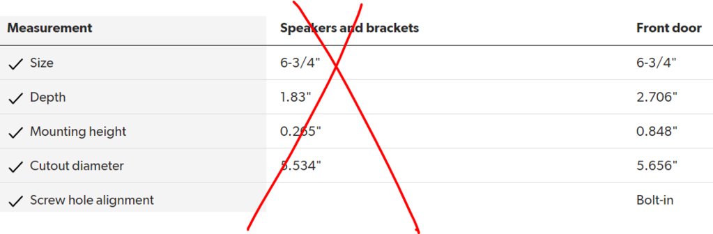

    So I can't speak to the 6x9's exactly, but a couple of pieces of info that might be helpful. Crutchfield says the GS690's won't fit, but what do they know. From CF though, you can get some measurements that are useful:

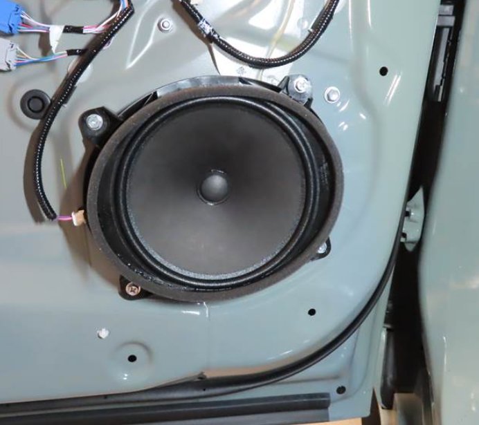

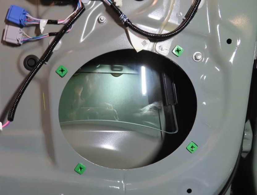

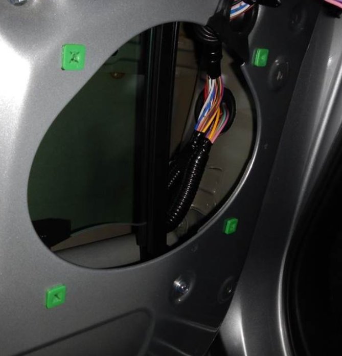

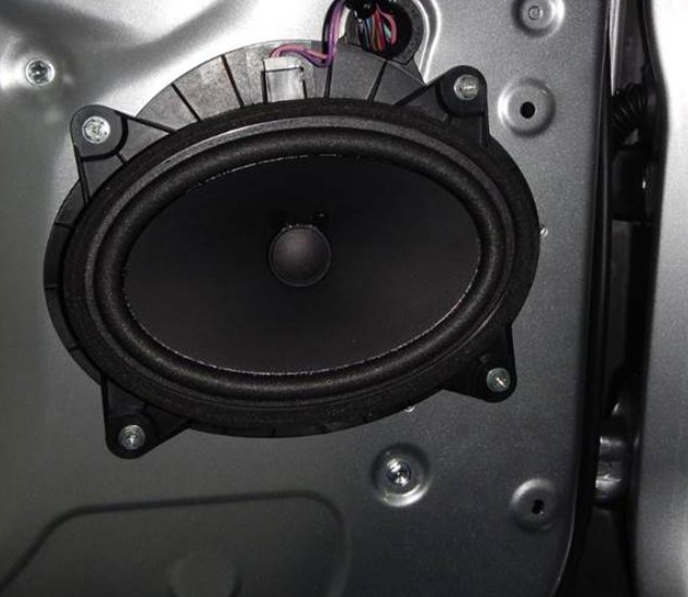

    Ignore the speakers and brackets column. They used to show measurements for speakers even if they didn't fit a selected vehicle, but it looks like within the last couple weeks they only show measurements for speakers that fit. Regardless, you can see you've got a ~2.71" depth, the GS690's have a 2-7/8" depth which is very close. Can also get a couple useful pics from CF. Left is a 2022+ front door opening and speaker, compared to a 2021 front door opening/speaker on the right.
    Previous years had a true 6x9", whereas the 2022+ has a ~6x9" bracket but a ~6-3/4" speaker.
    I found one Ebay listing for someone that makes 2022+ ABS adapter brackets. That said, I'd guess that if you reached out to a fine company like SoundsGoodStereo they'd be able to custom cut a pair with an ovular rather than circular cut out.

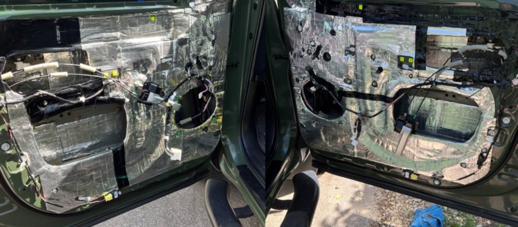

    For sound deadening, although I have a 2021, the doors are more or less the same. Here's a couple pics of my front doors. Be forewarned, what I did is overkill. I've heard a lot of folks say the 2022+ doors have a lot of rattles. I would probably focus on around the actual speaker opening, and then on any loose plastic bits in the door card or any wires etc. in the door panel.
