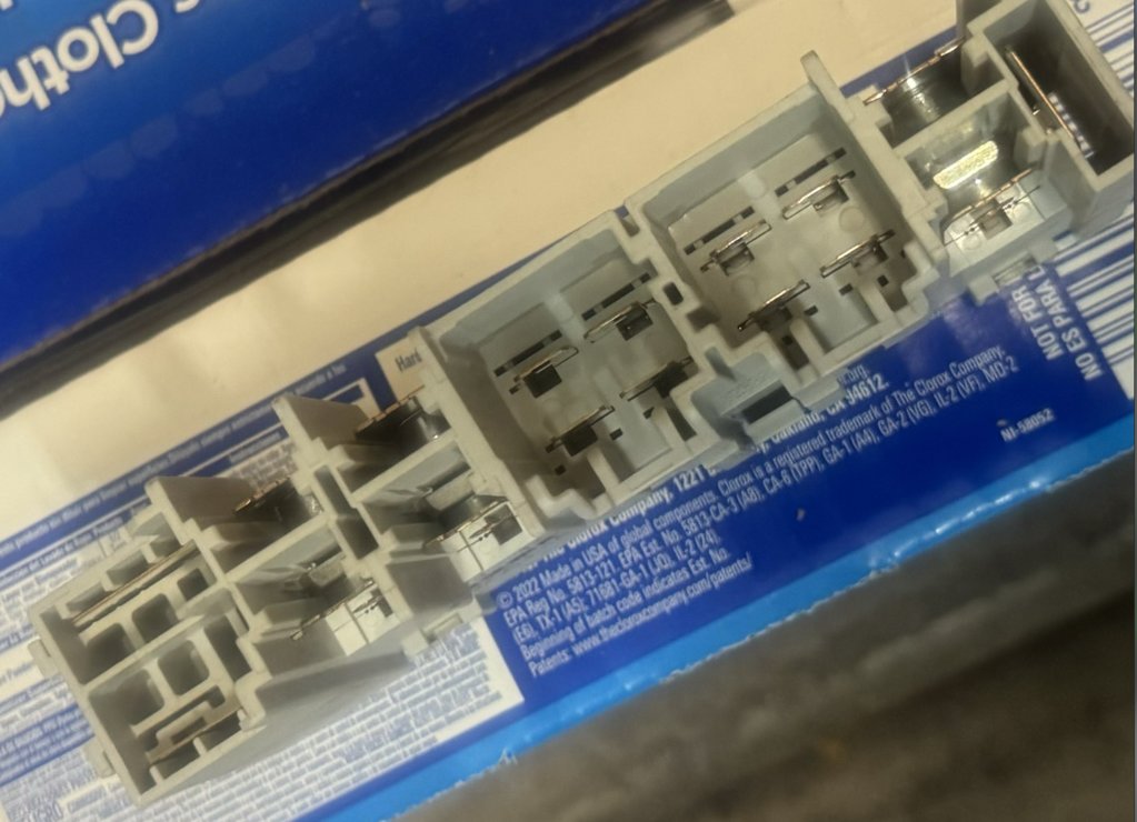

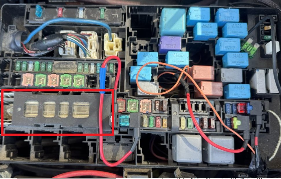

    I have a 2013 Sequoia Limited. In my typical negative lottery fashion, I hoped to get more air volume from my HVAC & installed Land Cruiser blower 87103-60560 as have numerous others.
    After the install, I had nothing. Connected the harness to the old, working 1 minute earlier motor, nothing. Fluke reads 0.3 to 0.7 or so with the AC running full bore. Rear AC is working, all dash indicators show the AC working, nothing else is not working.
    I checked EVERY fuse & searched & searched for possible solutions and see there is a relay in the diagram but can't find it. Can anyone help please?
    I ordered the main fusible which I can't tell if any of the segments are blown but would hate to r&r it to find it's not the issue.

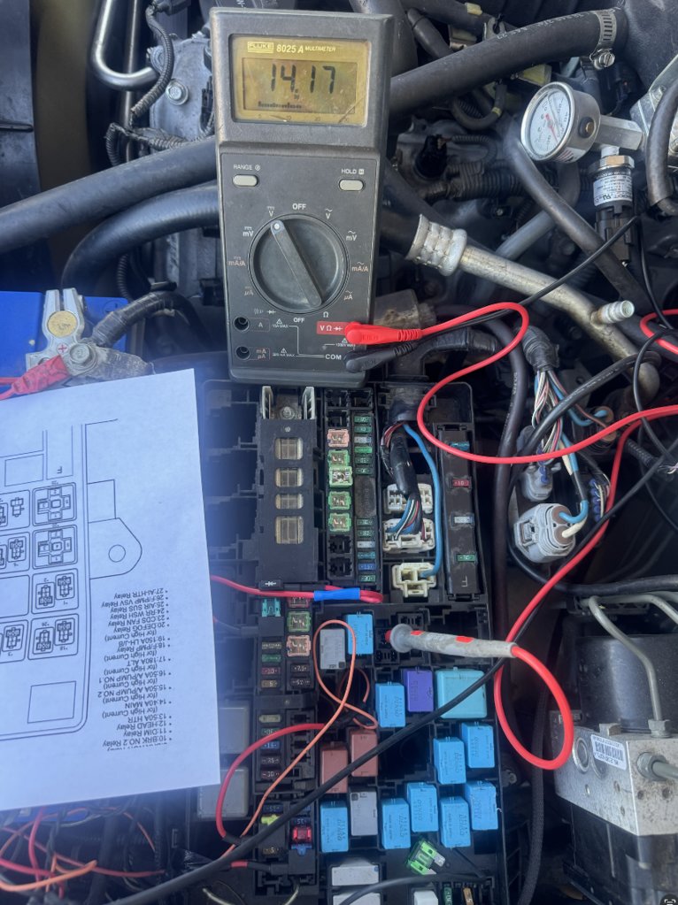

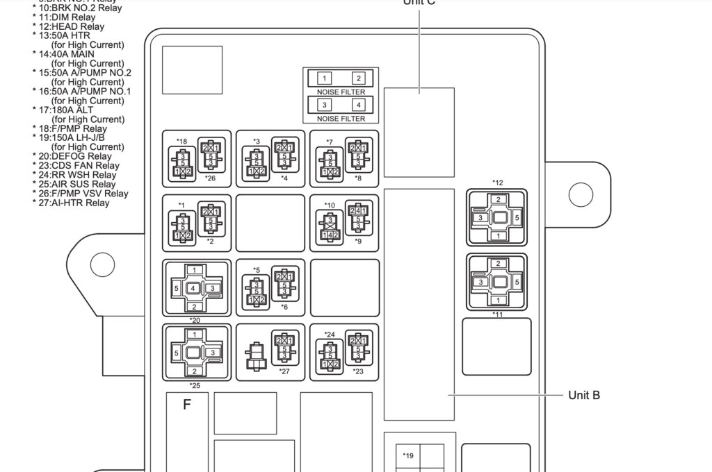

    This is from the diagram for 2008-2013 Sequoia.
    It seems, # 27 is the HTR relay, my fusebox looks nothing like this.

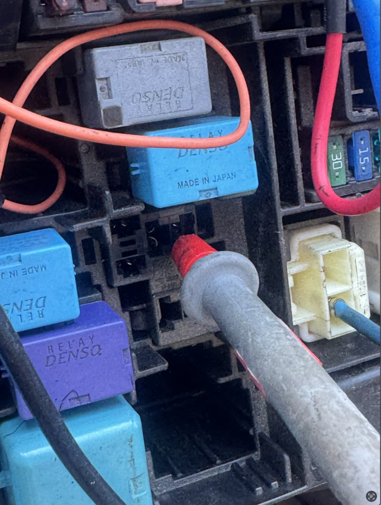

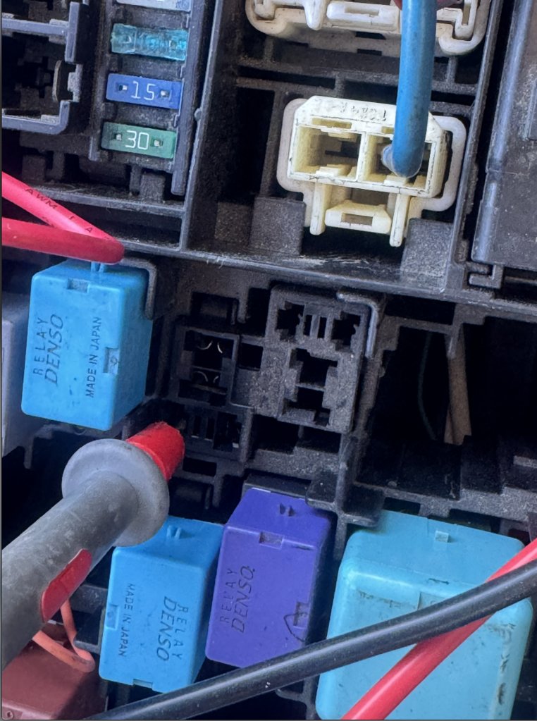

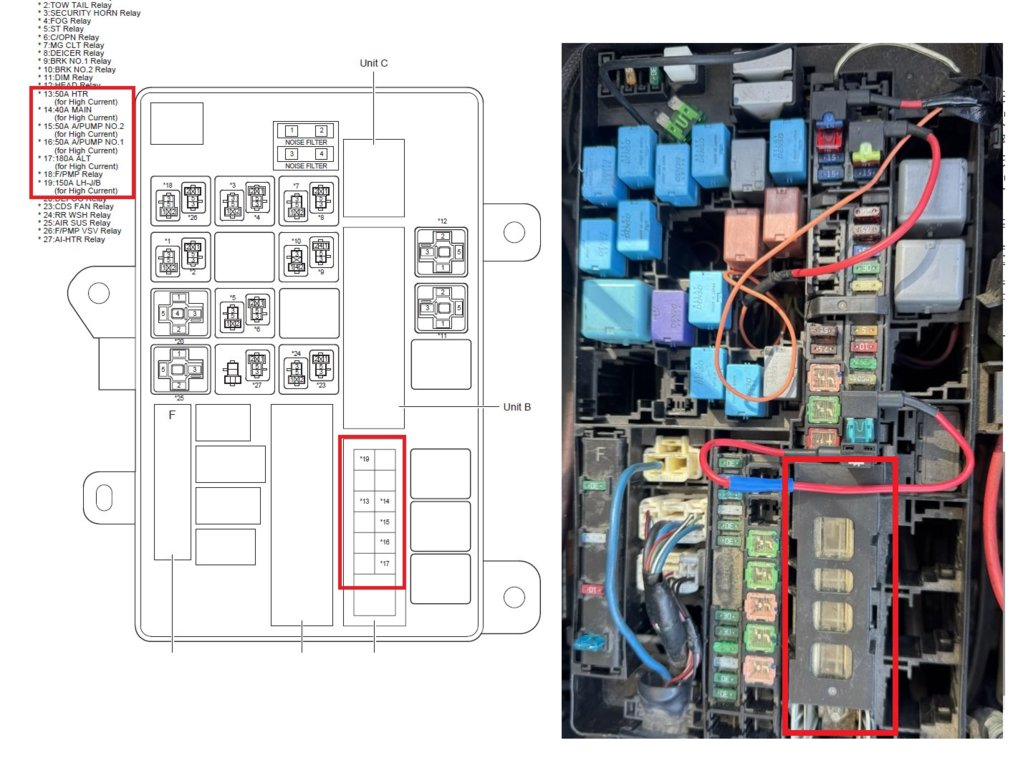

    I think I found the relay, I have 14v at the single top pole & bottom right, nothing in the middle.
    Maybe it's not the right one, I got P144C while I was swapping the relay, evap error is what I see when searching the code.

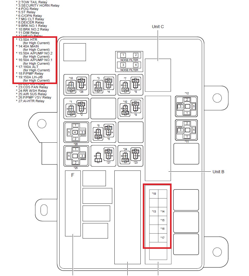

    Its not a relay, the AI-HTR relay is for the ECM and is not related to the blower motor.
    You are looking for the 50A HTR fuse. No relays involved.

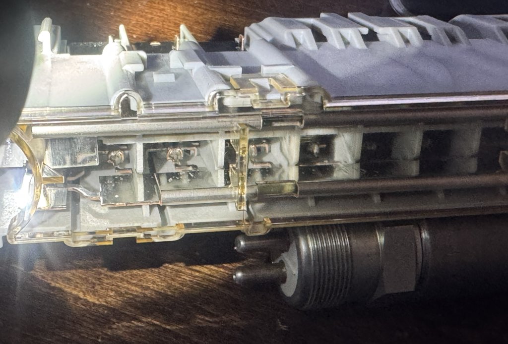

    Its #13 and part of the main fuse assembly. 13-19 are all fuses in the "main fuse"

    Try to look down in these clear windows to see if any of the fusible links look burned up.

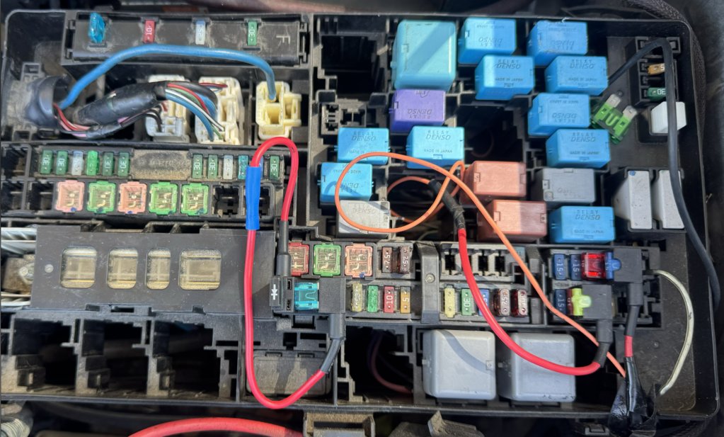

    Can't see anything in the main fuse deal, I checked every fuse including pulling/replacing them. That was the diagram from Rainman rays helpful diagram thread.

    If you have 0V at the blower motor harness, part of your main fuse is blown. Fusebox has to come apart to replace it. Some videos on youtube show the process.
    Also its the right diagram you just have to turn it to the right perspective.

    Blew my fusible, it is out (NIGHTMARE) but the dealer sent god knows what.
    I wasn't driving it without the blower, sure as hell can't now.

    I mickey moused a 50amp fuse in and put the broken one back, ordered another from another dealer based on vin search. This is freaking crazy.

    The end of this mess is new motor & fuse in, there is more volume from the new fan, I had to reverse the wires. The fuse is a bitch to replace, it got easier the 4th time. For a '13 Sequoia Limited, the PN is 82620-00300 but that is superseded by 82620-0C030

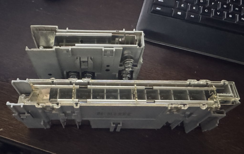

    Bluetooth fuse.
    Movement is from cutting into it.

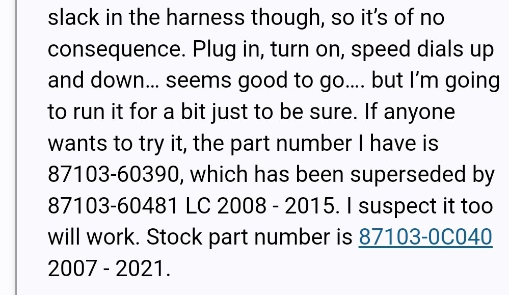

    Sure wish I had, now I have an extra oem fuse (ordered one from a dealer and another from Amazon) to be sure I had the right one and for 40 bucks keeping the extra one to ensure (the way things go for me) I’ll never need it.
    Also have the new fan I killed it's logic board and the functional original
