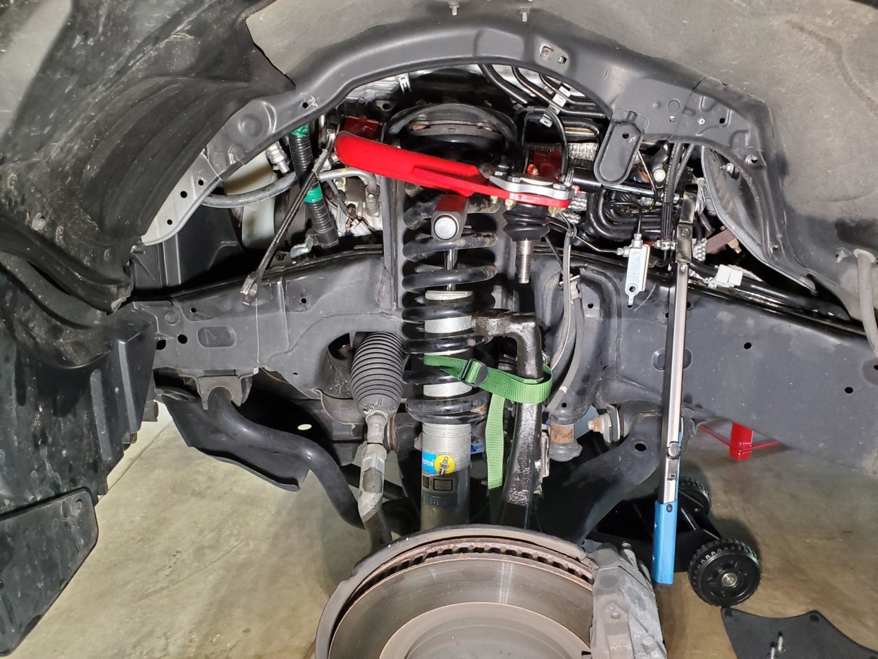

    Hey fellas,
    Looking for a little help, figuring out how to get a torque wrench on the nut of the UCA pivot bolt. I have watched and read everything I could but haven’t seen mention of this yet. Nor have I seen anyone moving those lines/clip. There’s some kind of clip holding 3 or 4 hard lines right where my torque wrench needs to be. When I finish the passenger side tomorrow and get back on the ground, I’ll get a better guess at it. The pic was to prove that it Did happen!
    TIA
    Cheers
    AggiePhil likes this.

    Only a photo posted. It looks like you've just about got it buttoned up. What's the question? Let us know.

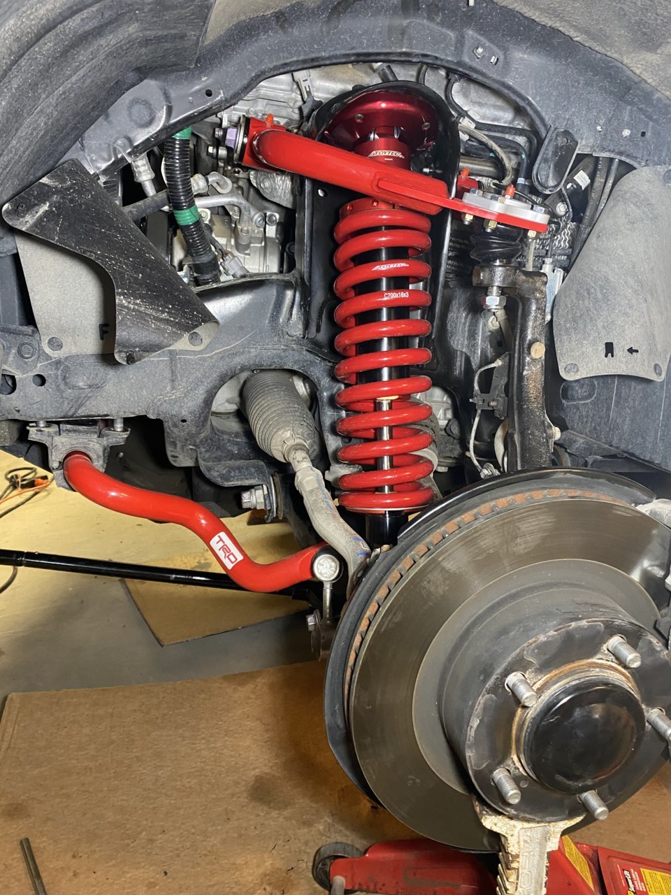

    Good question. Somewhere on my phone I have a picture of the combination of extensions I used. Will see if I can find them in a bit.

    There it is. I did this job last May, so there was some scrolling to find the pics. I loosened or removed the hardline bolts and used a 6" extension and shallow well socket.
    RobertD likes this.

    Great pic, says it all.
    Thank you!!
    Only other issue was the LCA to frame bolts, but I got’em up to 150ftlbs, that will get me to the alignment shop safely.
