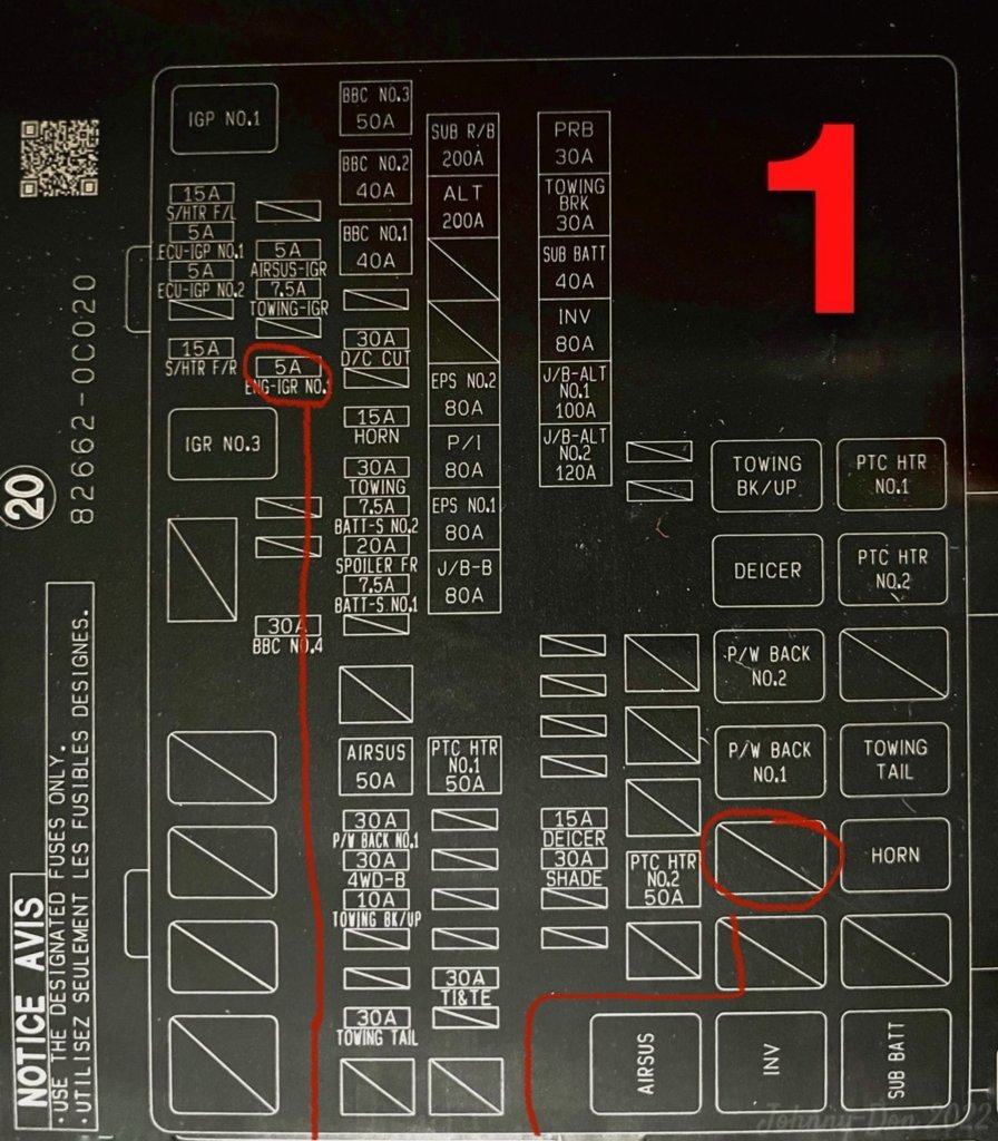

    There is a positive post in the fuse box. I put my pos there and neg on the bolt next to it.

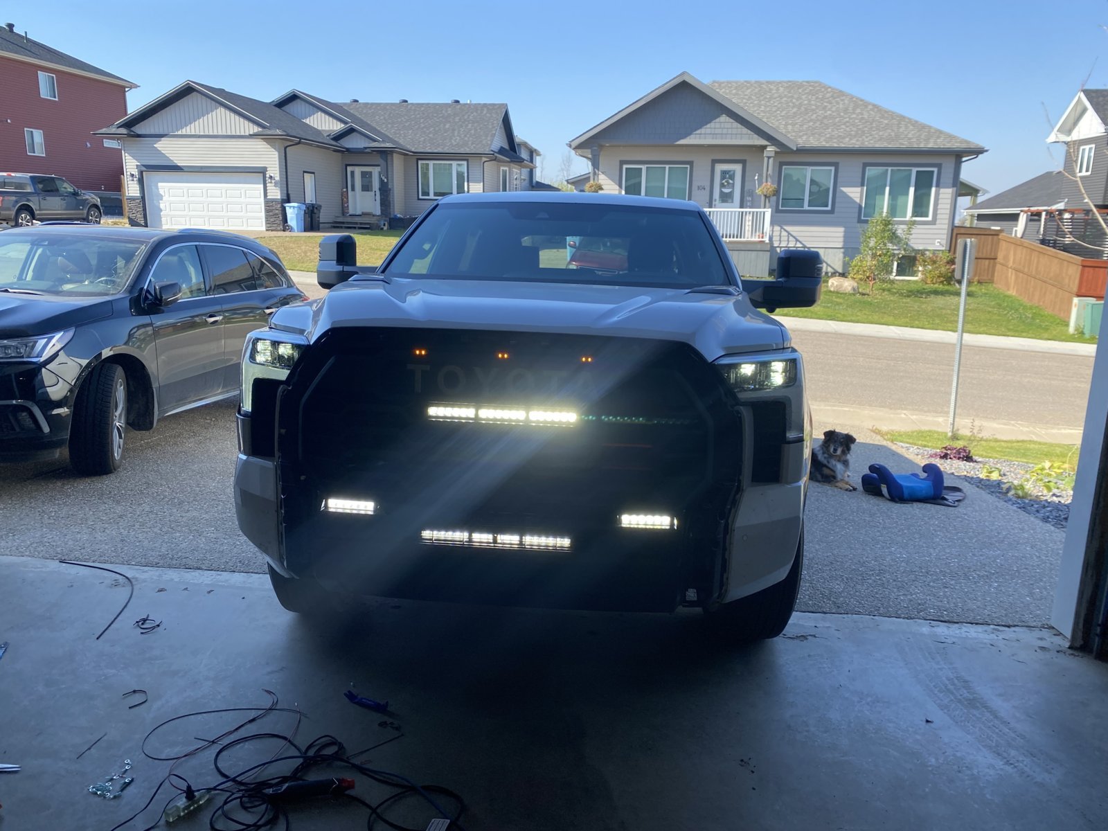

    I got a driving for the grille and a combo for the stealth, as well as the fogs.
    DD has a duel harness. I used this for both bars on one switch. Wiring is fairly clean. Probably could have done slightly better, but I’m okay with it.

    here one before the color matched surround was put on. I’ll try and get one the next few days haha.

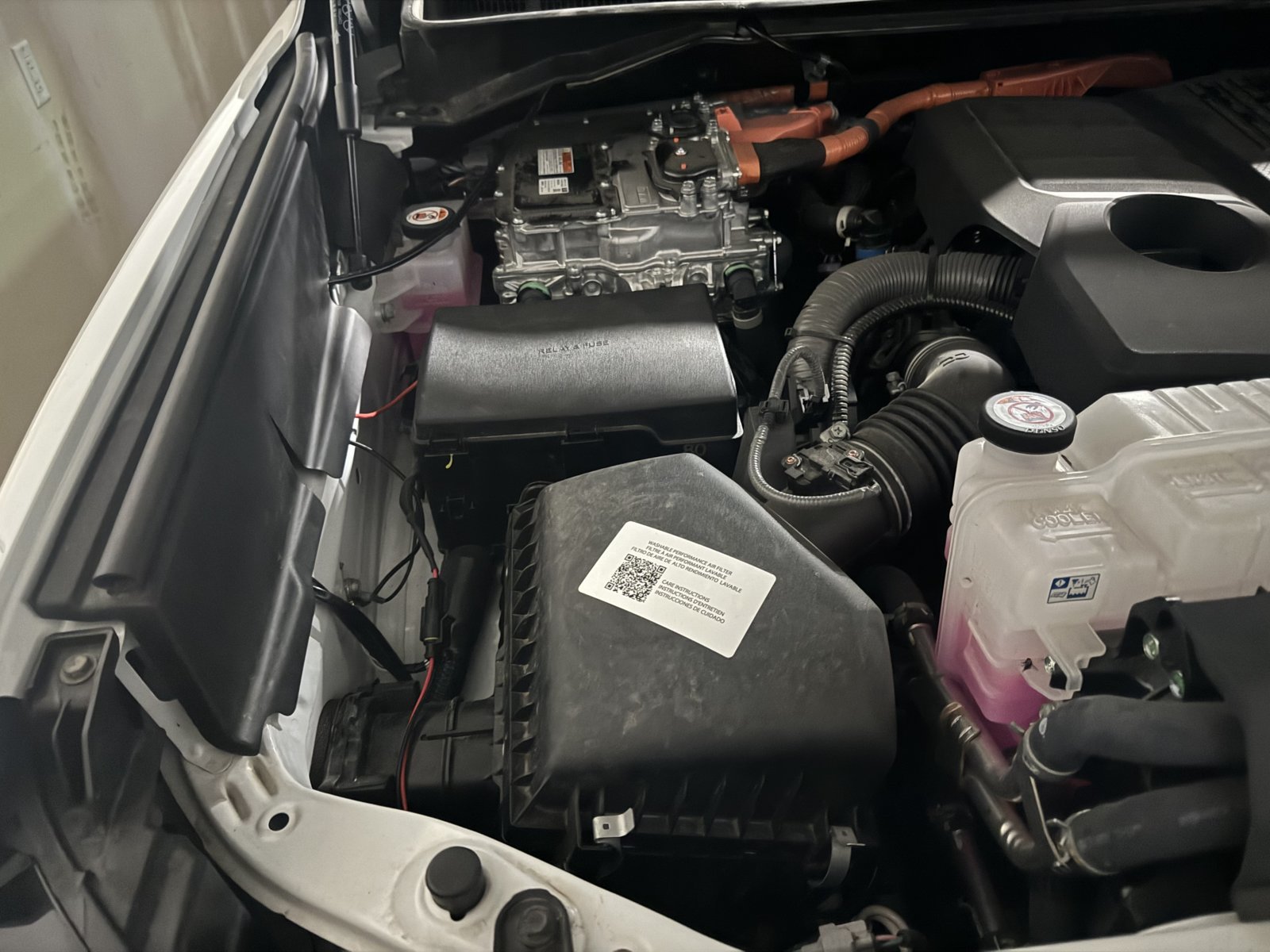

    Here my wiring. Most of the wiring follows an oem wiring harness. The exposed red and black will be put into loom and routed with the wiring harness that goes under the air box. I had to redo the wiring after the shop ripped it out instead of using the quick disconnect (they’re for my marker lights)
    the light bar harness goes under the cowl on the passenger side where the relay is mounted with a nut and bolt. Then the harness goes inside the cowling near the windshield across to the driver side.
    again it’s not perfect, and I could have done better but I’m happy enough with it.

    Would you happen to have a pic of that positive post in the fuse box? I can see the positive jumper cable location but I'm not sure about the post.

    I don’t. But it’s the only one in the left side.

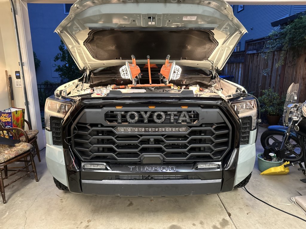

    I just installed the pro grill from Yota Expedition. Came with raptor lights and a grill lightbar. https://yotaxpedition.com/products/pro-front-grille-tundra-2022-2025
    I ran the raptor lights into a 5A fuse for power on passenger side fuse box, piece of cake (minus having to run wire into top of fuse box since no way to pull from below in the hybrid). In the instructions, YotaExp powers the lightbar with the positive terminal on the battery right next to fuse box. Since my hybrid battery is in the back, i pulled the positive into the fuse box as well. I connected it to a 50A that was unmarked in the diagram. The lightbar powers up fine, but when i shut the truck off it stays on unless i hit the switch (and the switch red green indicator is always on). Is there a different power source you used that flips on and off with truck ignition?
