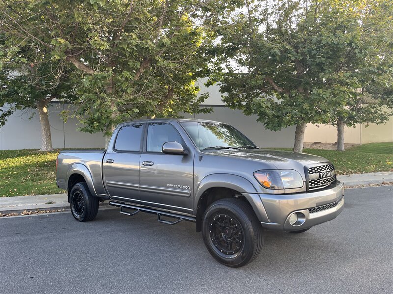

    Looking for my future 1st Gen Tundra
    1GT gang - I'm working on a deal for a truck through a dealer. solid price and truck looks groovy. going to try and get a full inspection on it - 2006 limited double cab - anything I should specifically ask them to look at? Or do inspectors for inspections generally do their own thing? rough 180K miles on the truck. Appreciate the feedback

    Need to have a deeper in depth phone conversation with the mechanic but he said overall truck looks good however it needs a new right axle, he mentioned one of the lug-nuts is missing on one of the wheels (lol but not really lol), and the A/C(air condition) needs work - whatever that means.
    again need a deeper conversation - he just left a voicemail - question for the group - you think he's talking about the CV Axle? and if 1(passenger side) is shot/needs replacing do you think it's worth just replacing both at the same time? I would think yes. and only using OEM parts, correct?

    Could be CV Axle, could be rear axle housing, maybe lug nut is missing because the stud sheared off, and he thinks a new axle is needed?
    The downside to using people for PPI who don't know these trucks is, simply put, he could see the CV axle's boot is torn, and be thinking, "Welp, needs a new CV axle, this one is toast!" when it's pretty simple to re-boot the CV, and OEM's will keep on kicking with torn boots for a looooong ass time, based on a few anecdotals from others on here. It costs way less to re-boot your OEM CV, and if that CV is OEM, you'll get way more life out of it rebooting than you would replacing it with new-aftermarket.

    Hey, at least you did the right thing and did a PRE purchase inspection. Can't tell you how many POST purchase inspections come up with a laundry list of woes. So, kudos. He is probably talking about the CV axle. There's really no way to inspect the rear without serious dismantling. Yes, replace both at the same time with ONLY OEM. There's a possibility that you can just re-boot if it's not too far gone AND it's OEM. But most shops are just going to want to replace the axle if they go that far. If you're mechanically inclined it's not too difficult of a job, but not for a newbie. Missing lug nut is a problem because it probably means the stud is fucked too. May need to be replaced if the threads can't be cleaned up. In other words, I wouldn't just slap a new nut on there. There's a lot of questions about the A/C. What's the problem? Simple recharge, or new compressor? Big difference.

    as originally thought. it needs CV axle to be replaced then recommended alignment
    I believe just a charge / service for the A/C - said it most likely has never been done

    $16 grand for the truck $186,000miles - seller
    Is real antsy
    Maintenance about $1100

    Wow. I think I would offer $13K. See what they come back with. What's the history with the timing belt, water pump, and LBJs? If no history, you can definitely plan on doing those things immediately. And then $13K is totally justified.

    Yup timing belt was done at 86,000, but if it’s every 100K, seems about right to replace / get new again.

    Yep. It's actually every 90-100K. And that's IF OEM Aisin parts were used. You're probably going to need a radiator too. Search "pink milkshake" and "brown radiator". The price keeps going down!
