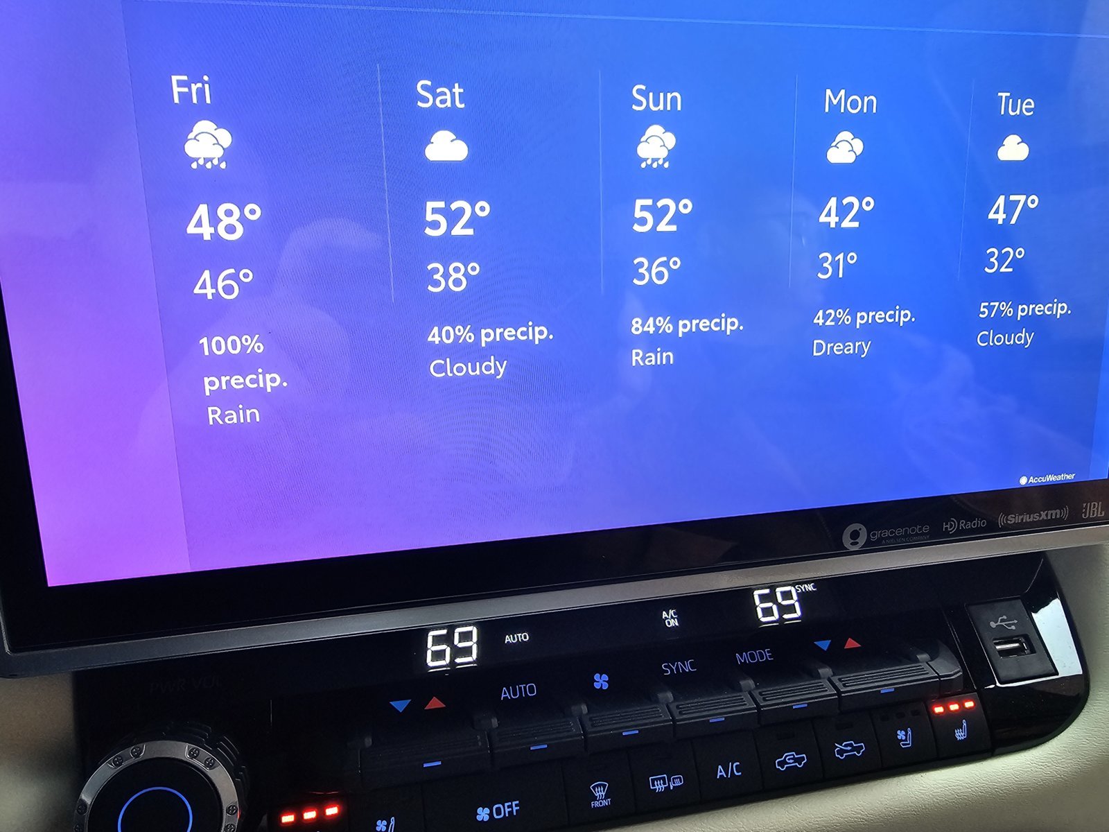

    I just tested it on mine. I drove around the parking lot(nothing higher than 15MPH) it works driving and parked. It pops up the weather with a picture(not weather radar) from accuweather. I wish my one buddy was at work, I would ask him about this. My truck still has all the trials going I believe, I wouldn't think it's dependent on those. If you are comfortable, send me your vin via a private/direct message, I can check the telecoms and maybe a few other things to see if something is blocked.

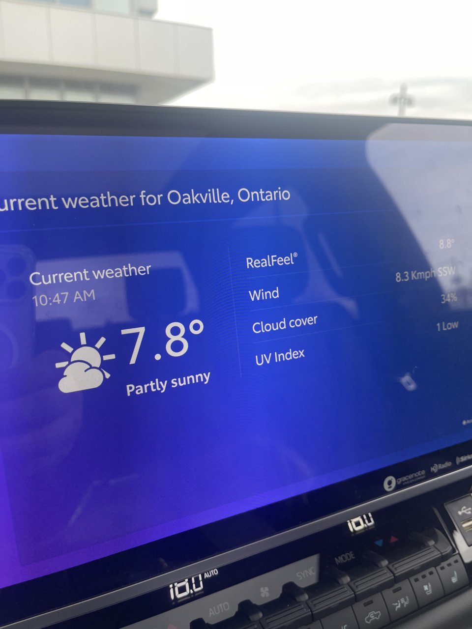

    Thanks. I got in my truck before I seen this and pushed the mic icon, and asked. Then a TalkBack told me. I thought well at least it says it, then it popped up on the screen. I then tried asking for other areas around the world. My son asked where's the coldest place in the world and it said Siberia -90° or so.
