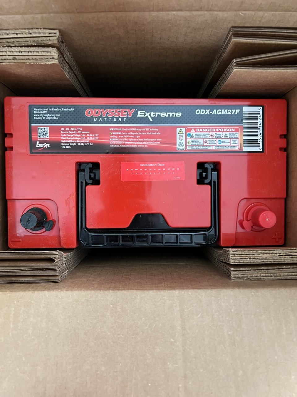

    I won’t be running a 2 battery system. Got myself one of these…

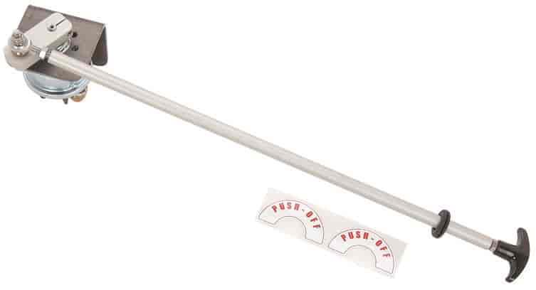

    Easy access disconnect. With a key or a lever like a drag car.
    lots of gromets.

    E2EB4862-83A3-4601-841F-FC5E1EB80FF1.jpg Something that closes the electrons quick and easy.

    Thanks. Why would this be needed? In case of an electric short or fire or something along those lines?…

    Exactly. Or a bad accident or a runaway winch since most don’t use fuses (more common than you think)
