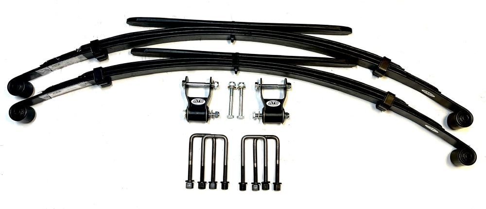

    Get the ATS HD springs. Link in my signature below. You will get likely 1.5” lift out of them. Should be less than $600 shipped for anyone in the CONUS, I paid like $40 or something. Skip AAL, but if you do want to go that route, avoid ICON. You’ll only get 3/4” without the overload, and if you leave in the overload you get 1.25” but it’s risky because of where the rivers make contact. Tons of people running these, average height was 1.5 - 1.75” lift regardless cab type. Really bolsters things up in the back. Jump on your jumper before and after, you’ll see the difference immediately in how they function.

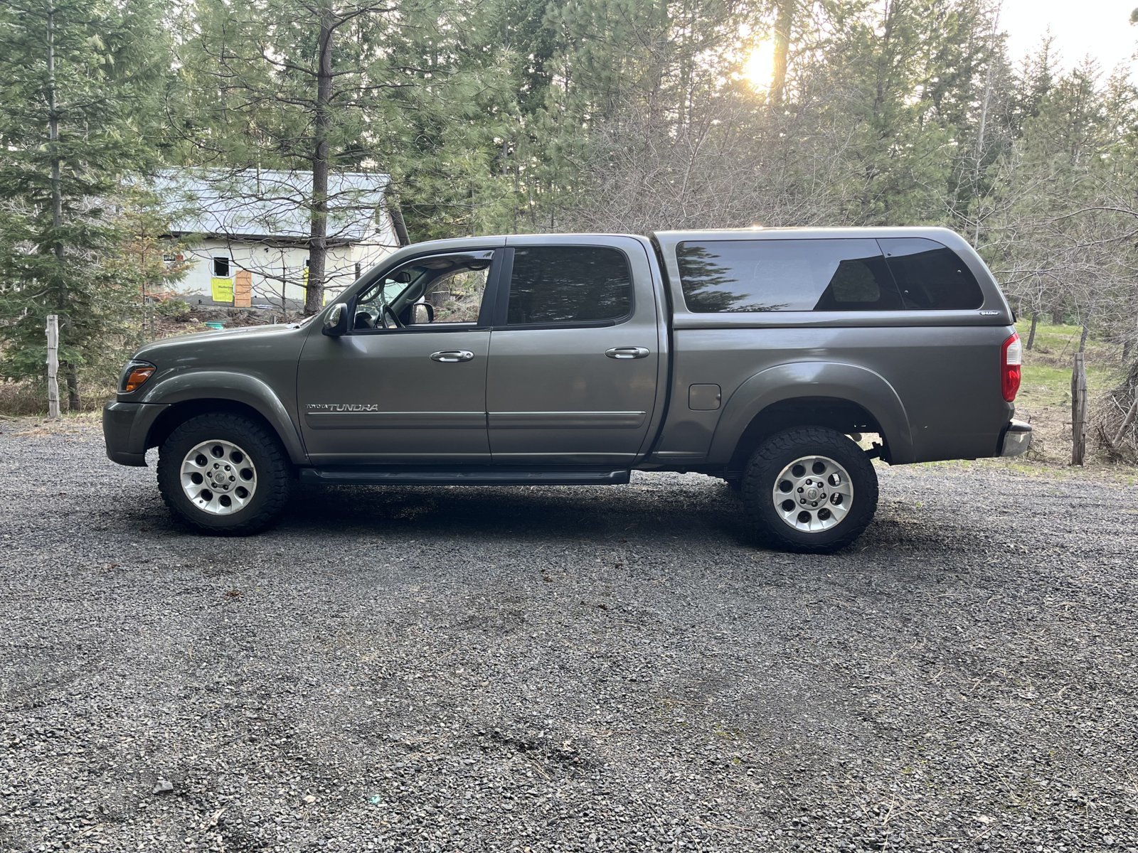

    Go with the ATS HD. They gave my DC 1.5" in rear with canopy.

    That's the way I'm going. Even though shipping is $100 for me it's still about $600
    looks like it does not include U-bolts, etc. so still got a check in to see what else I need. that might run the price up a bit

    I put 6125 in front after these pics - but these give nice idea. They ride great after a year. Love em and would do it again.

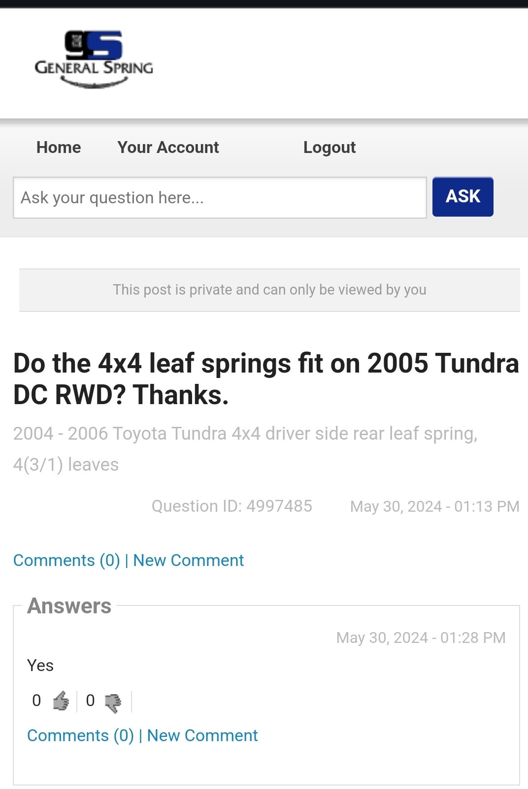

    General Spring only lists springs for 4x4 models so I asked if they would work on my RWD. Just posting for additional info.
