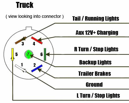

    Is there a ignition live in the rear of the bed, or tap into the trailer wiring perhaps that has a wire that goes live once engine is on?

    Try the hot wire on the 7 pin connector. Just tap it and see if it works.
    This picture isn’t specific to the tundra but gives an idea.

    I've used the trailer wiring for a tailgate light bar.

    Yep, this seems to be the best, and perhaps only option. Any idea what is the fuse rating on this 12V?

    I’m pretty sure it’s a 40A fuse for the trailer charge circuit / 12V ign power (pin 4 of the diagram posted by @timsp8)
