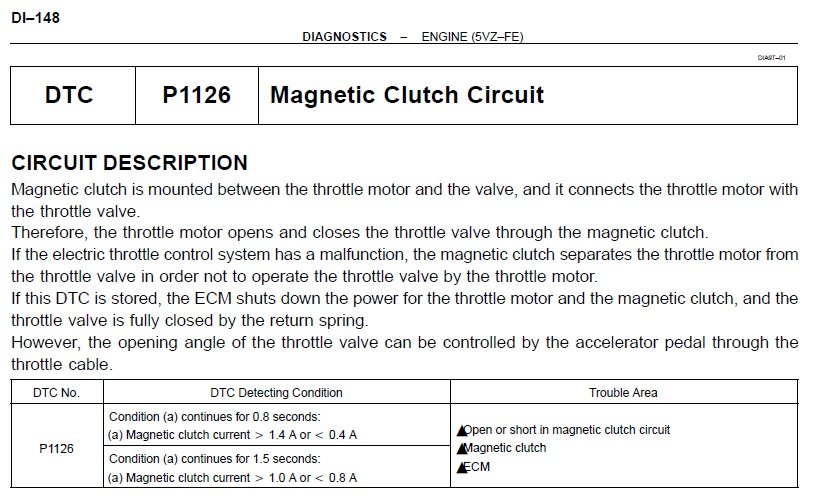

    P1126 is the throttle body circuit, if you unplugged the (4-pin?) harness on the (passenger side?) of the throttle body assembly, it would've done that, IIRC.

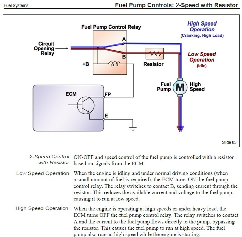

    If you are meaning key is in the IGN ON position, whatever you're hearing isn't the fuel pump.
    Adding to what @Shifty said, we have to be cranking for fuel pump relay to energize. The smelling of fuel would be something to look further into also. I would consider checking fuel pressure if you're equipped to do that.
    from Toyota Techinical Training....
    • Engine start: During cranking, current from the ignition switch to the starter relay (ST) coil turns the relay ON. Current also flows from the ignition switch to the STA terminal of the ECM. When the STA signal and the crankshaft position signal (NE) are input to the ECM, Tr is turned ON, current travels through the coil of the circuit opening relay (C/OPN), the relay switches ON, power is supplied to the fuel pump and the pump operates.
    Definitely re-check for that code and accuracy of your scanner because the 2UZ(V8) does not utilize a magnetic clutch but you would find that code in a 5VZ(V6)

    If the timing (crank position sensor) were bad, it would then not be operating the fuel pump so there would be no pressure?
    And if I were to get pressure then something is causing the injectors not to fire right?

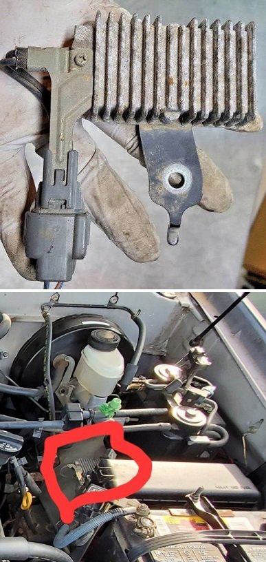

    Perhaps I am doing it wrong but I am getting no fuel pressure at all.
    i may have broken the fuel pump relay trying to check on it so will be replacing that.

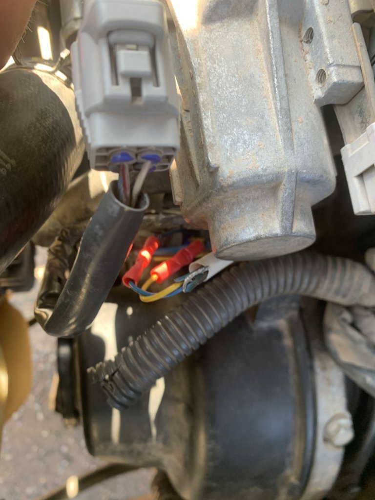

    I am now worried that the wiring fix I did on the harness that connects to the cam position sensor is still bad.
    truck is trying a little harder to fire, not much but it’s intermittently trying stumbling not just cranking.

    What method and at what location are you checking pressure ?
    As for the relay, it's somewhat of a multi-purpose relay. If you have an Advanced Auto close by, they have the same type 12vdc 20A 5 prong relay type relay you could use in a pinch until you can order a Denso OE or get from Dealer after Holiday.

    Before purchasing try jumping that circuit
