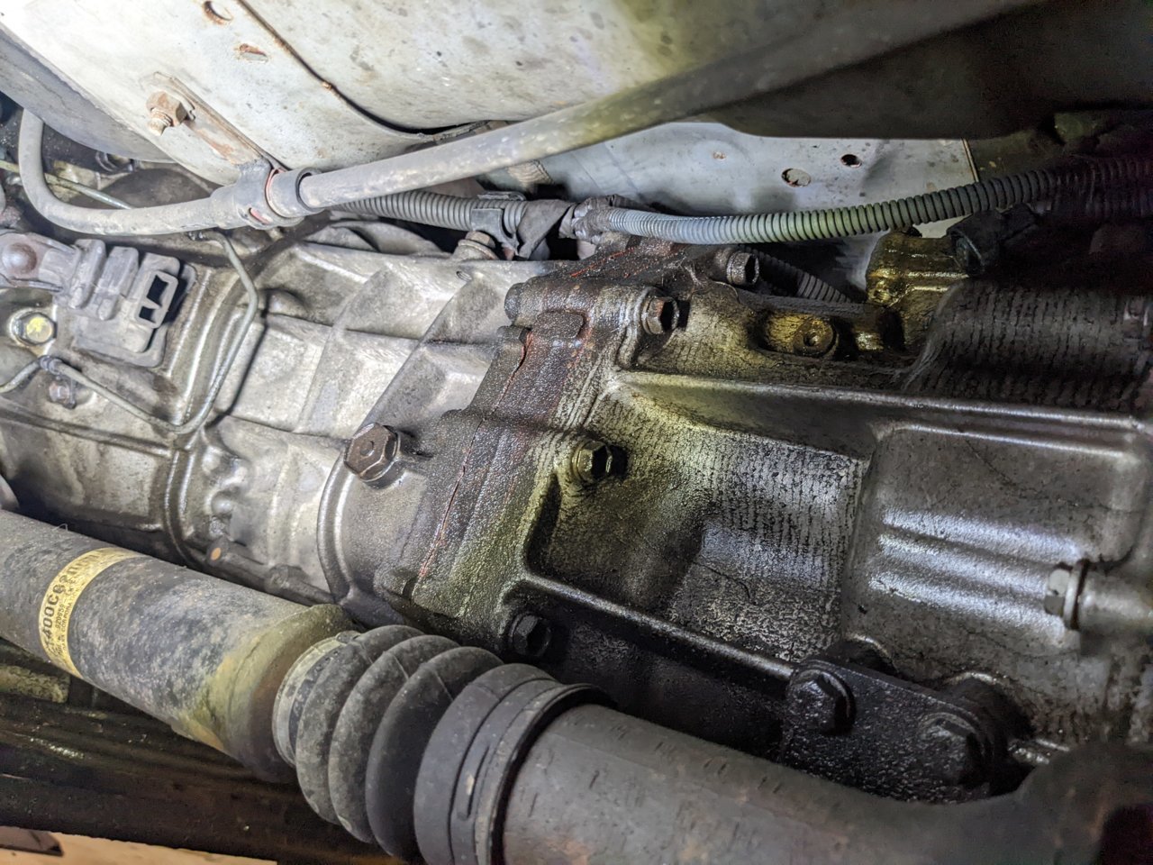

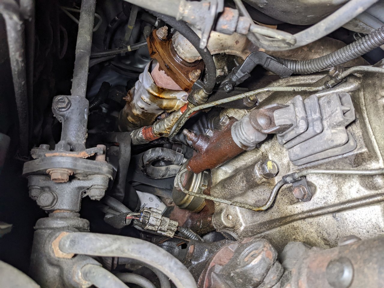

    I have a 2000 Tundra 3.4L V6 manual with just under 200k miles. I would like to identify the various fluid leaks around the transmission. I know that the valve cover gasket is leaking, which I plan to fix. I also see leaks around the transfer case and transmission, but I am not sure what exactly is causing the leaks (see the attached photos). I plan to clean things up to see where the leaks are occurring; I'll post those pictures later. Can someone give me an idea of what repairs I need to do to fix these leaks? Do I need to remove the transmission?

    Thinking you may have a couple of leaks, one of which is your valve covers. I don't know a ton about the V6.

    Valve covers for sure. (The 3.4 is famous for it) Transfercase might need to come off and replace the seal between the case and trans.

    Thanks. Neither sounds bad. What about the transmission?

    Gotta clean everything real good, then look for ‘fresh’ leaks. They’ll lead you to the seal that need work.

    That must smell like ass after driving with how much oil is leaking onto the manifolds/manifold shields from the valve covers. That's pretty significant, even with a much smaller leak from my valve covers, I lost a quart over the period of about 5-6 months. That should be enough risk alone to warrant fixing.
    Gunk makes a pretty decent foamy engine cleaner, it's like $6/can at my local chain parts store: https://gunk.com/product/gunk-foamy-engine-cleaner-feb1/
    Get a stiff bristle brush like what's pictured below unless you have something better that'll get around things and into tight spots. Hit it with foamy gunk cleaner and let it set for a bit (read the instructions on can). Then carefully but firmly hit it with the brush.

    Looks like the tcase needs seals, and VC’s. Gotta make it clean before we can find the juicy bits through pics.

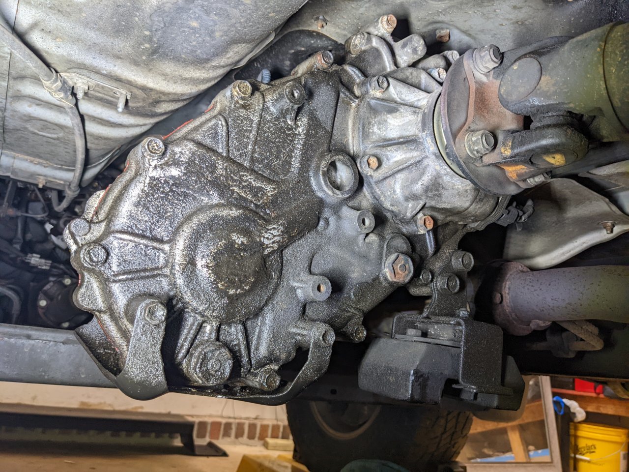

    Pictures after cleaning to follow. Gunk and brush ordered - thanks for the tip, shifty.

    Clean, wait a day, clean again. Let it dry and drive 50 miles before pics.

    That's not a leak, just normal seepage on a 22 year old truck. Are you really going remove, take apart, reseal and replace the transmission or transfer case just to save a few bucks of fluid per year?

    Agree with this. What you have is auto-rust prevention. It’s slowly applying a rust blocking salve from the available reservoirs. Until I can’t make it between oil changes, I’m not worried about it.

    Good points above. My plan is to replace the valve cover gasket, which is not a small oil leak. Then clean everything to assess what else is leaking, how much, and the amount of work needed to fix. I am also looking for reasons to hangout in my garage...
