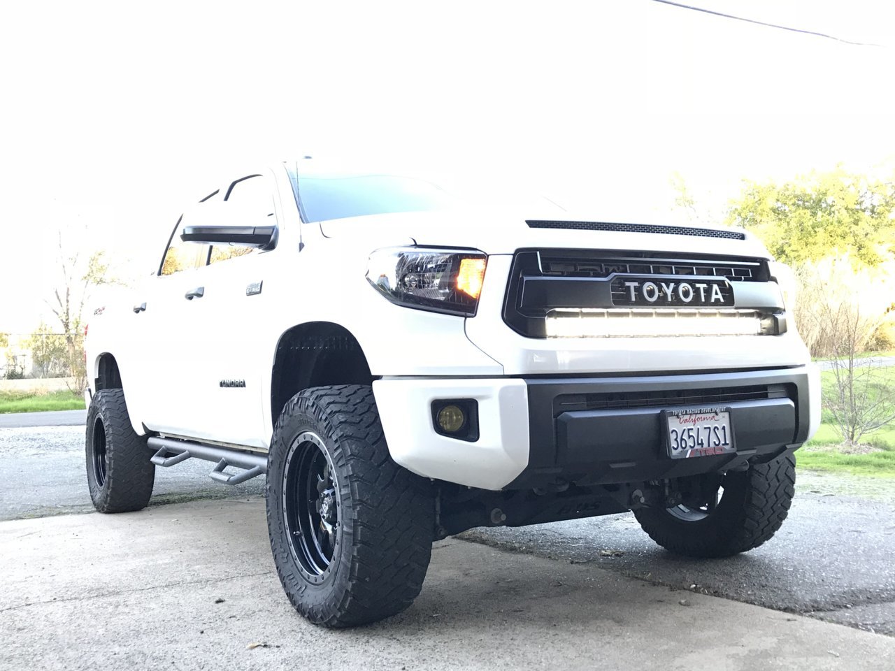

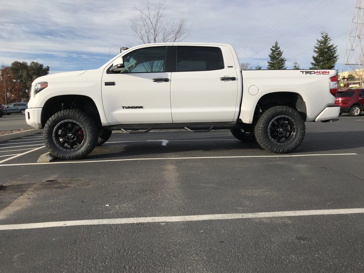

    Everyone will till you what they have. If you Offroad tow or hunting go for 3” If you don’t Offroad or tow heavy just want look cool go for Zone 5 but you have to cut your crossmeber. Just want to get your a idea this is my BDS 4.5 With 35/12.50r20 20x9 +1 offset with 75k M on this lift 0 issues ( now with the ICON coilover so I can setup 4.5-7.5” any where if i wants) I have ICON stages 4 before install my bds, bds hands down!
    But your money go for what you like..good luck.FC46C4D1-330E-4A05-8261-13FFB14AB6B4.jpg647393F1-C7FA-4921-BC9F-22080E162750.jpg
