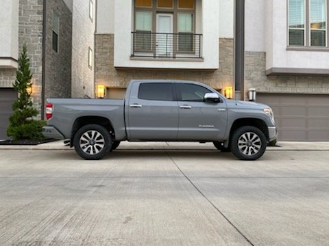

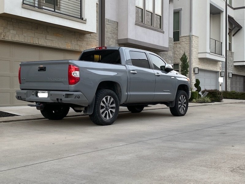

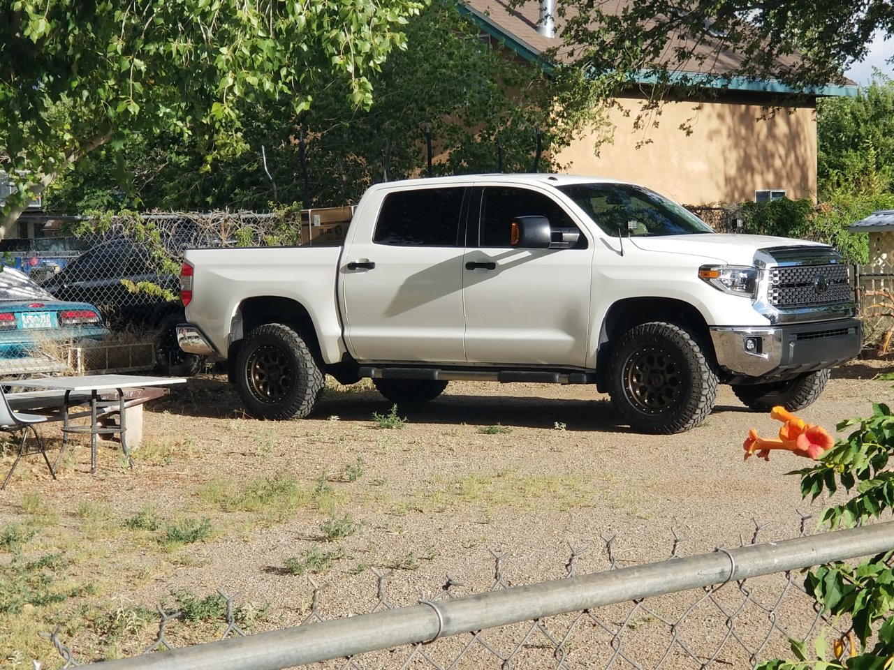

    Any pics want to run the 295 same front level as you and CB plus 3
