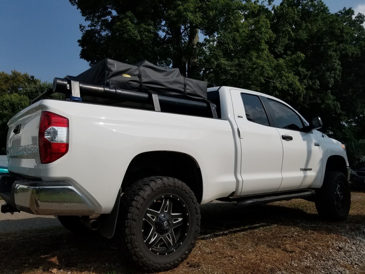

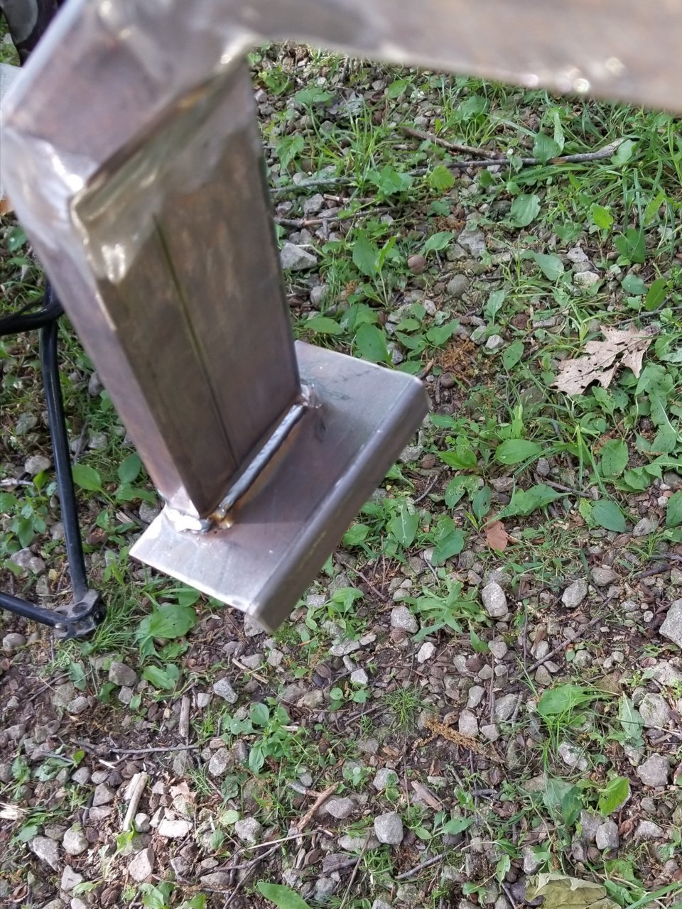

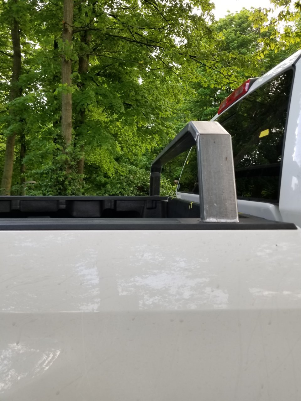

    Here's my rack...my truck isn't bashful, stare all you want :D

    Looks pretty good! I really like the design. Simple, sturdy and functional.
    But....cold lap, lack of fusion on the tie in, spatter...god I hate being a welder, I naturally inspect the hell out of everything. :sorry: :welder:

    It won't bust apart, that's for sure! I'm just being a typical welder. Ignore my pettiness. :cheers:
    Assuming you welded it yourself? Turn your heat up a touch and slow down your travel speed a bit. That should clear up the cold lap. You could also do a bit of a whipping motion with your nozzle, but that's hard to describe without phsyically showing you. Wrapping the corners will help with the fusion. Spatter...perfectionist bullshit, don't worry about it. LOL

    thats really cool . I like the simple design .

    Dont know if that's my weld or not, I dont particularly like a mig. :)
    The noise a mig makes, does make me go to fast !

    I hear ya. MIG's noise does that to me sometimes. Try wearing ear plugs. My welds, with all processes, are better when I wear earplugs. It dulls the noise and I can focus on puddle control better :)

    Sorry for the thread Jack OP!
    Will try that next time!
    When that rack was made that was the first I laid a bead in 15 years...boy I miss it too!

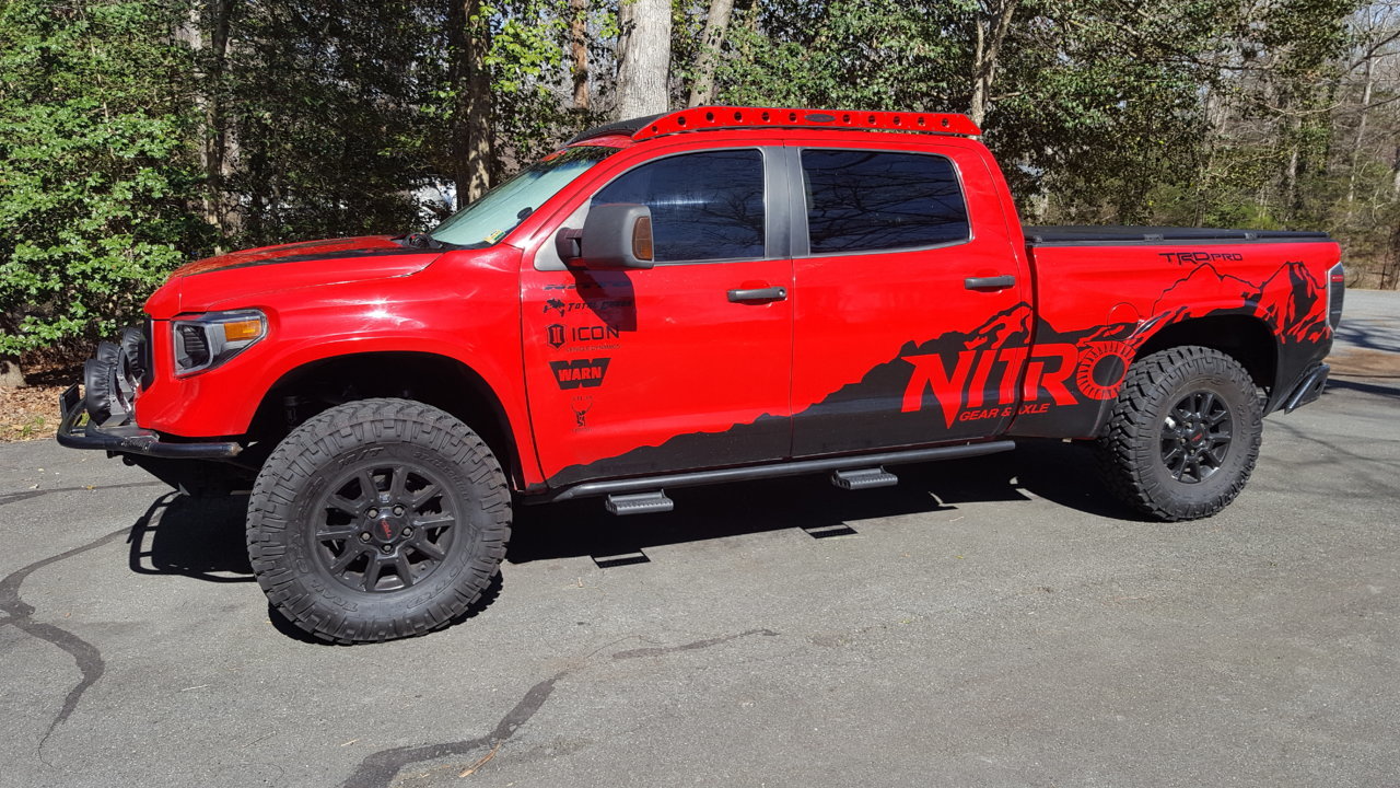

    I really dig my Coachbuilder roof rack. Well built, installation was pretty easy, solid. Great for my surfboard and my kayak. 10' kayaks would fit on this really well on a CM. I admit, it would be a bit of a bitch getting em up there, but it would be great for developing those lats for kayaking. :thumbsup:

    Holy shit! thats freakin sweet!
