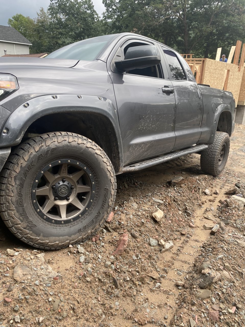

    Running the Toyo at3 35*11.5*17 on icon vector 5 which have the same measurements. Running the elka 2.5rr with sbc uppers. No rubbing but had to remove from and rear mub flaps and use a heat gun to push the front plastic fender forward about an inch. I hated the idea of the bmc.

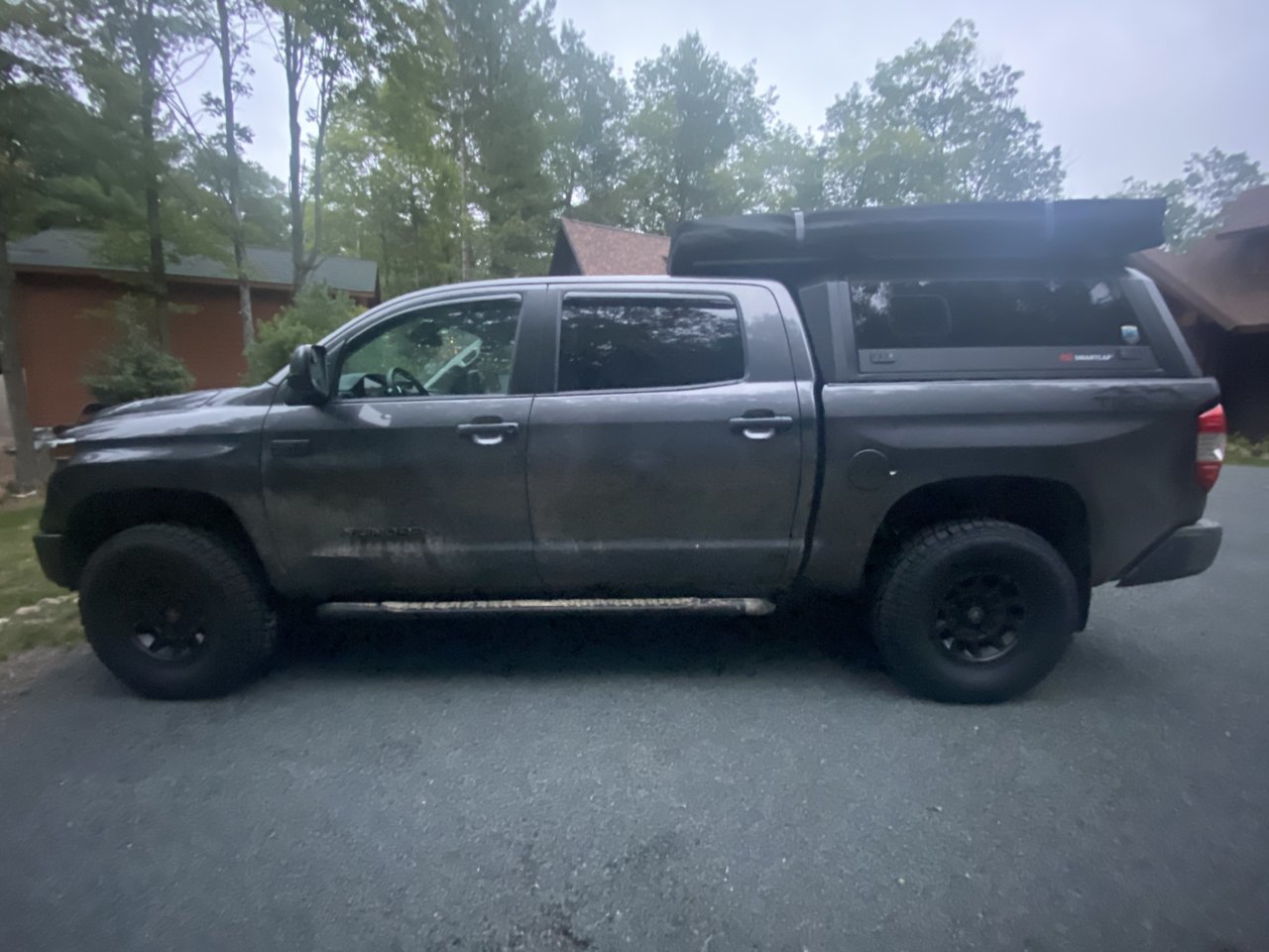

    I’ve got icon thrusts with 35” terra grappler g2s. Coachbuilder kit to clear and no rub and no bmc

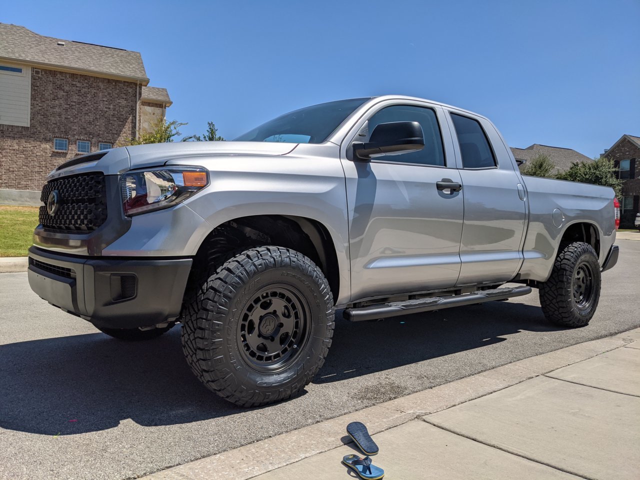

  9. Sep 11, 2021 at 12:46 PM
    Mr. White
    Mr. White [OP] Poco Loco
    Aug 12, 2020
    #50707
    204
    Steve
    San Antonio
    2020 Family 4x4

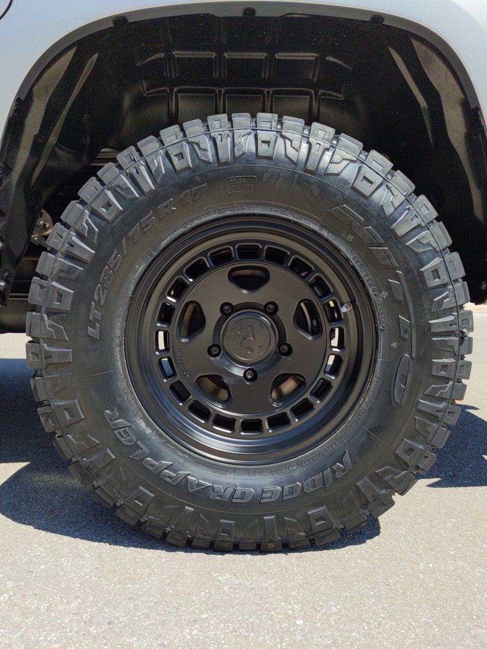

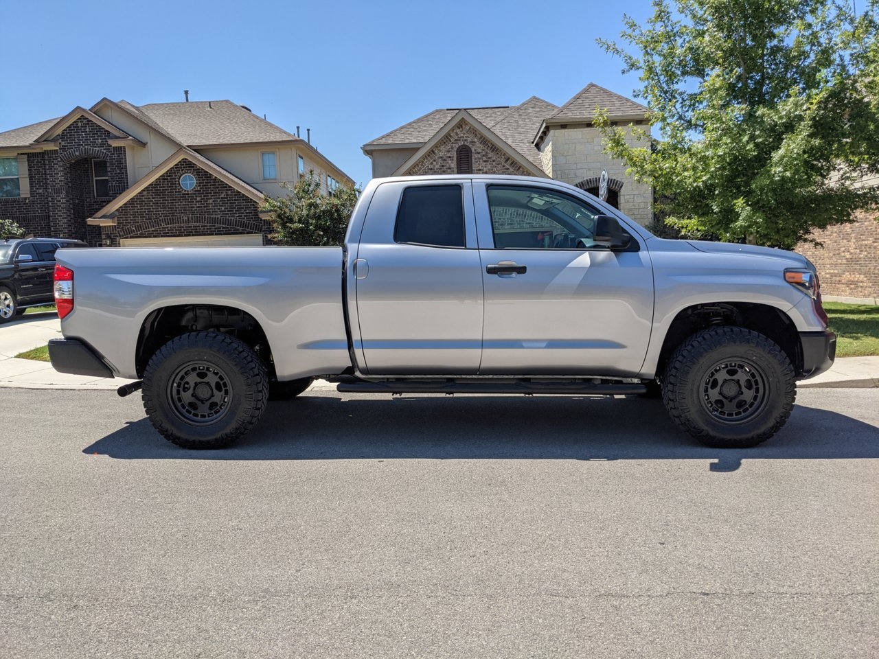

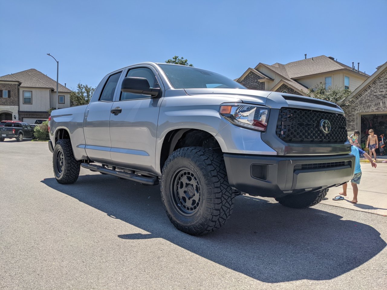

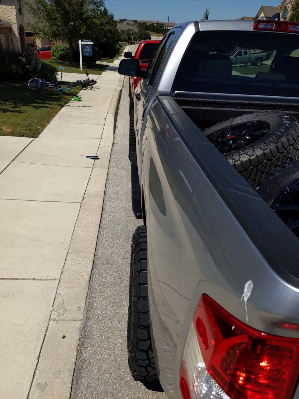

    So, didn't go with the setup I was planning on because availability...
    Fifteen52 Turbomac HD Classic - 17x8.5 et0 with Nitto Ridge Grappler's 285/75R17. Love the look, hate the rubbing on the front bumper. Gonna have to modify...
