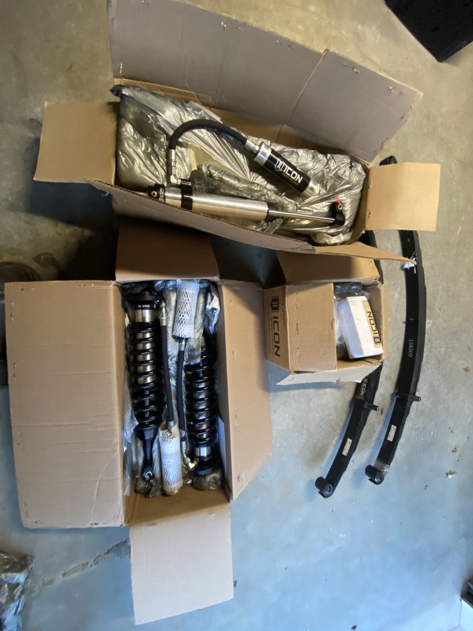

    Hey everybody, so after doing much research, I was going to have the Bilstein 6112/5160 setup for my truck...ive heard some problems with them leaking at an early stage...so instead of buying them over and over, I was just gonna BUY ONCE CRY ONCE.
    I know the stage 9 is huge but I would like to have complete control of the suspension system.I really like how they are rebuildable as well. I talked to toytec for like an hour and they were very helpful. They were very detailed in the process and explained it to me wonderfully.
    Reason im trying to get some help is that I have the Method NV 18x9 +25 offset/6 Backspace and they were saying that I might come really close to the UCA's with that setup if I put 35/12.5r18 tires on there...originally I was gonna have 295/75r18 for the truck but if im gonna buy this system im sure as hell going to use it and make sure it looks good too lol
    I also saw that people are having a hard time aligning the truck with their control arms...anybody know of that?
    Can anyone chime in on this and help a brother out? Ive been searching and searching and not a lot of ppl are running this setup with the ICONs

    so after talking to multiple vendors today...I ended up purchasing the stage 8:spending:lol Excited for what's to come for the future....now time for some 35's then some epic pictures :burnrubber:
