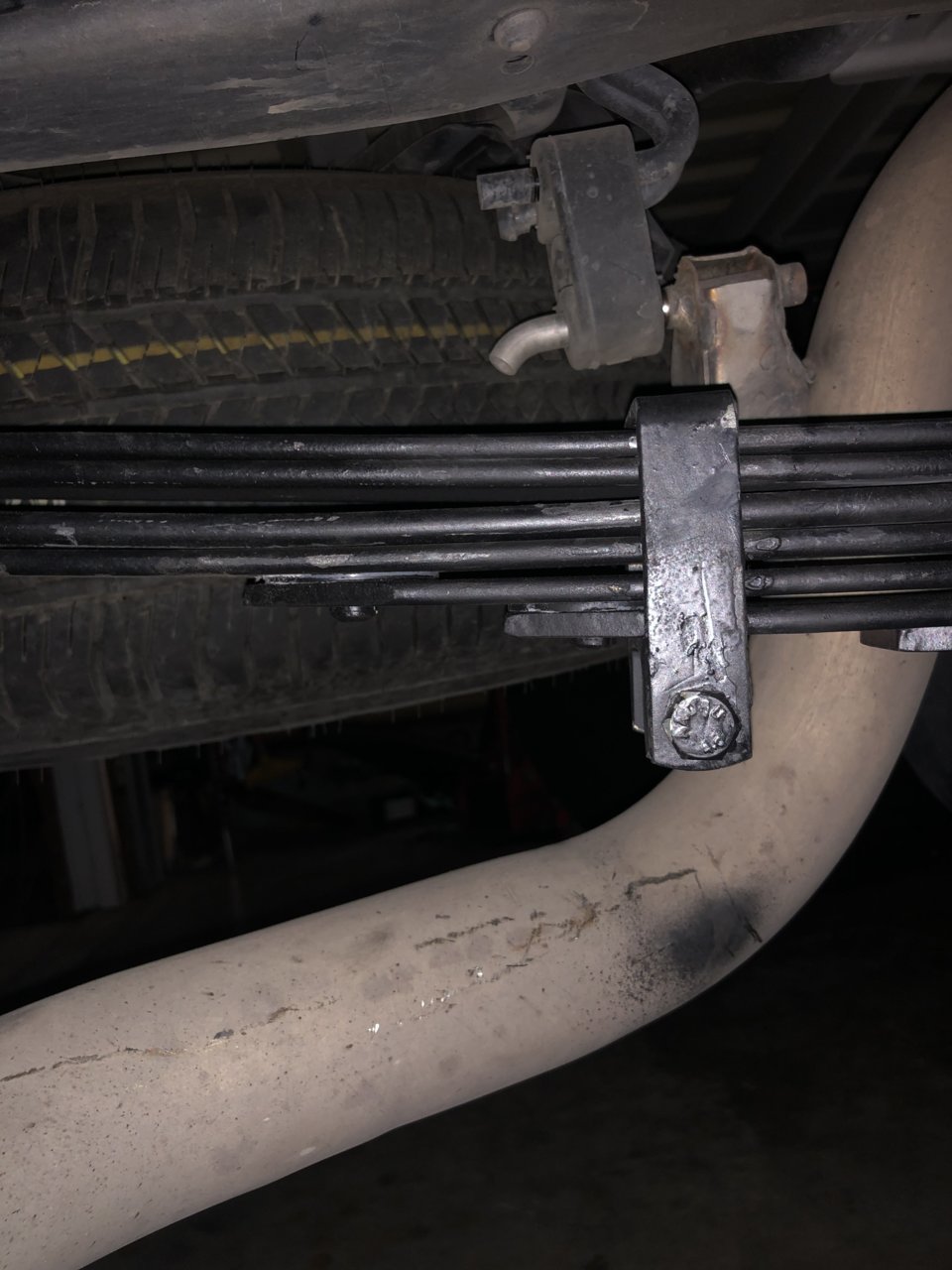

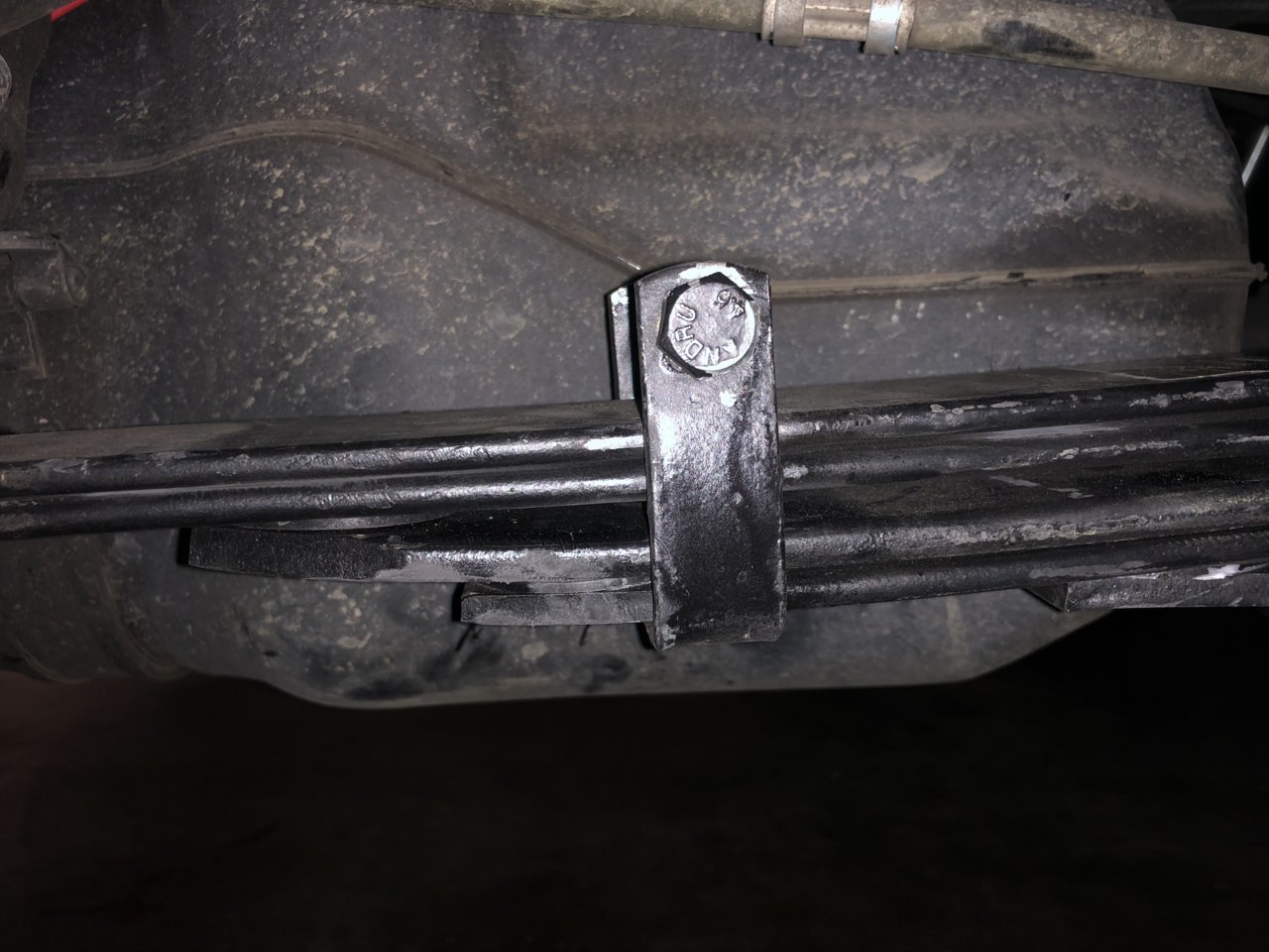

    So I went to option 2 and with only the she’ll roughly 165-170 lbs I’m only at
    1 3/4” of lift and now there is a gap between the original 2nd spring and the new 3rd spring. It is consistent on both springs in front and behind the axel. Icon is saying it’s normal but I don’t know about that. Thoughts?? Please also see my post above.

    There is a post or two about this issue that a few guys have tackled or are in the process. Short point of a long story is we should have 3 inch wide leaf springs instead of the 2.25 or 2.5.... whichever it is from Toyota. Our trucks are so damn heavy that if you do anything other than drive down the road all the time with nothing in your bed, then the leaf springs will start sagging.
