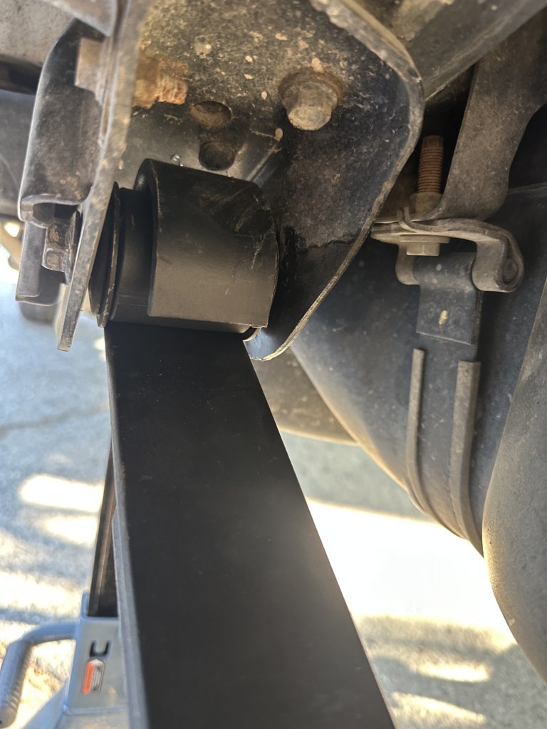

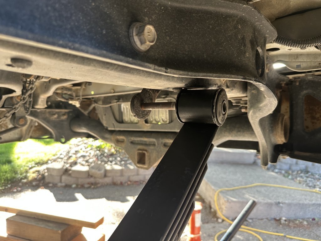

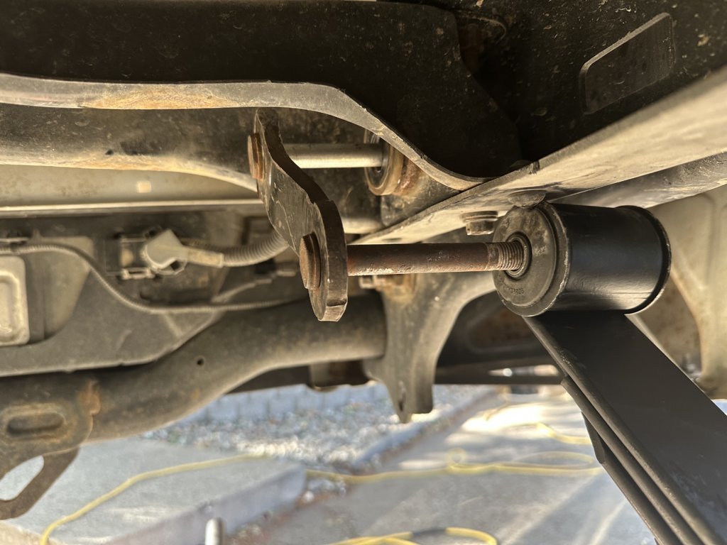

    I bought a set of Icon RXT leaf packs, installed the extra spring for “stage 3” weight load. I have the military wraps toward the front, front of spring is bolted, free floating from the axel and this is where the rear shackle hits. Not even possible to get it in and it’s a roughly a 45 degree angle.
    Did I get sent the wrong pack? Manufacturing error? Or am I doing something wrong that I’m not seeing. Spent about 30 minutes before closing trying to get Icon on the phone but kept getting sent to voicemail. Any input appreciated, thanks in advance
