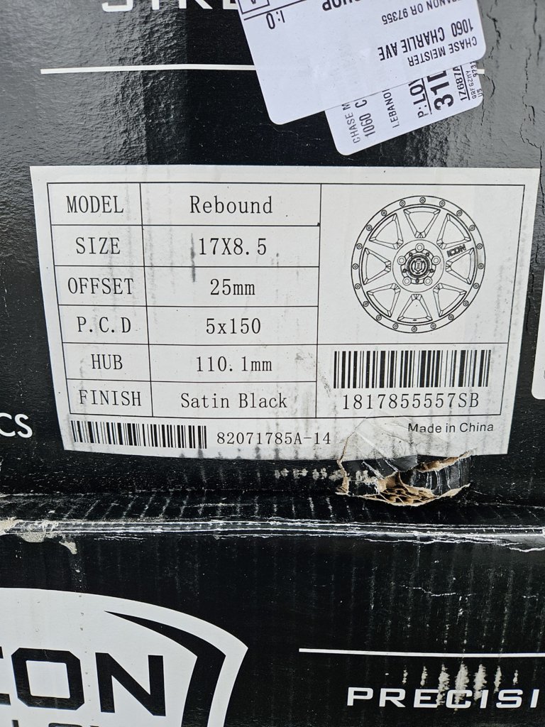

    Do you have the boxes? Or any type of order info? We want to see if the hub size is correct.

    Assuming you got the right wheels, hub centric vs lug centric....I would expect it is an improper balance job or a tire defect. Check part number on your rims to confirm, just because they bolt on doesn't mean they truly fit.....tundras need hub centric.

    Here is the wheel info.
