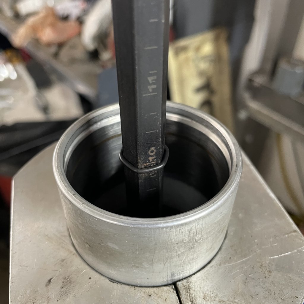

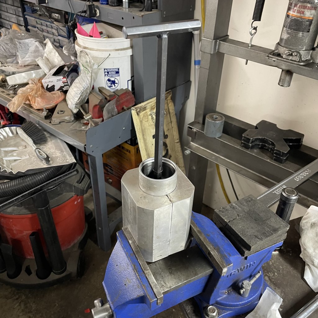

    I’m rebuilding my 07-20 Icon non-resi 2.5 coilovers and wondering if anyone knows what depth to set the IFP at. Hoping to finish them up this weekend and Icon is closed till Monday. Thanks!

    In case anyone is looking for this in the future it is 1.6” from the top of the shock body.
