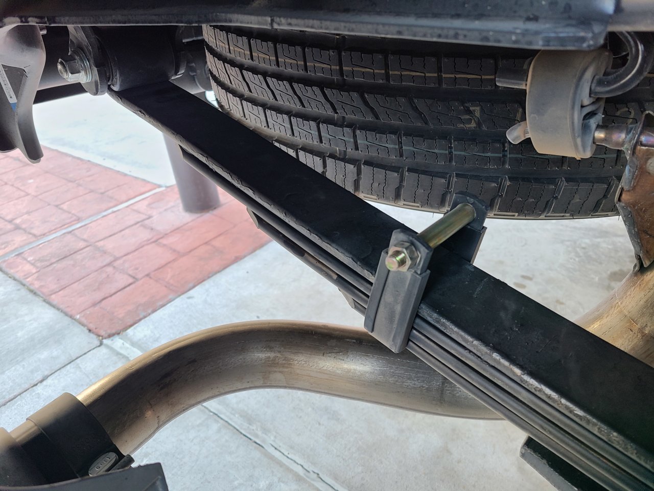

    First pic

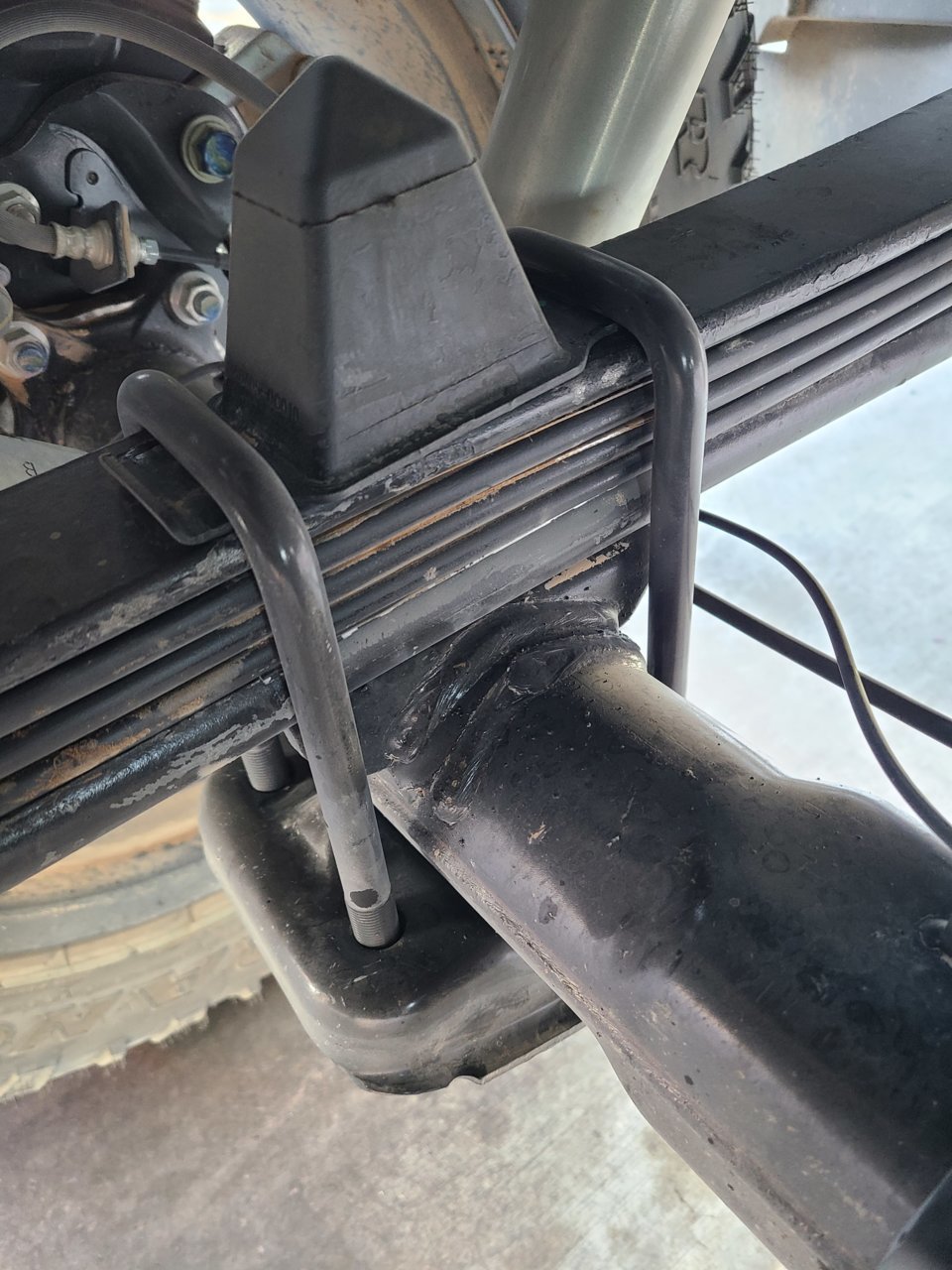

    Second pic

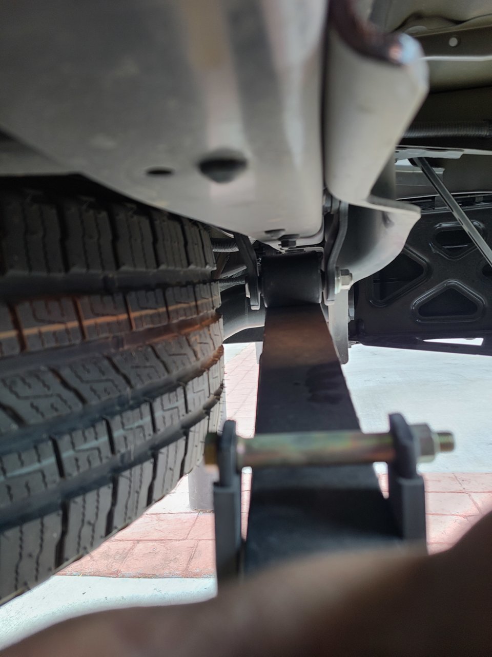

    Third pic

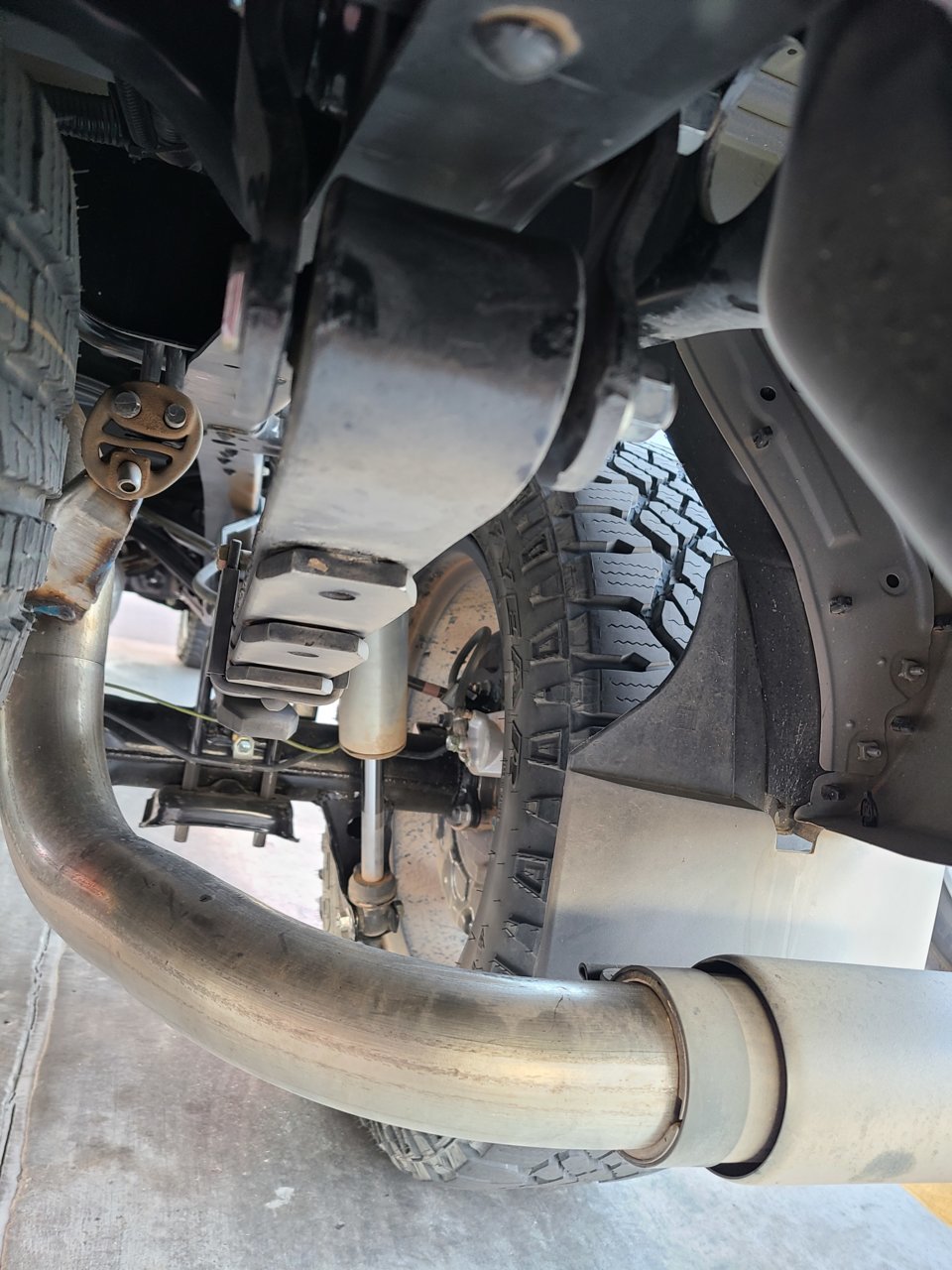

    Fourth

    Well I’ve got nothing useful here, but that helps levelset at least. The only thing that I can see different from my setup to yours is that you have sleeves on the pack guides where as mine is metal-on-metal. I don’t think that would cause the extra lift though.

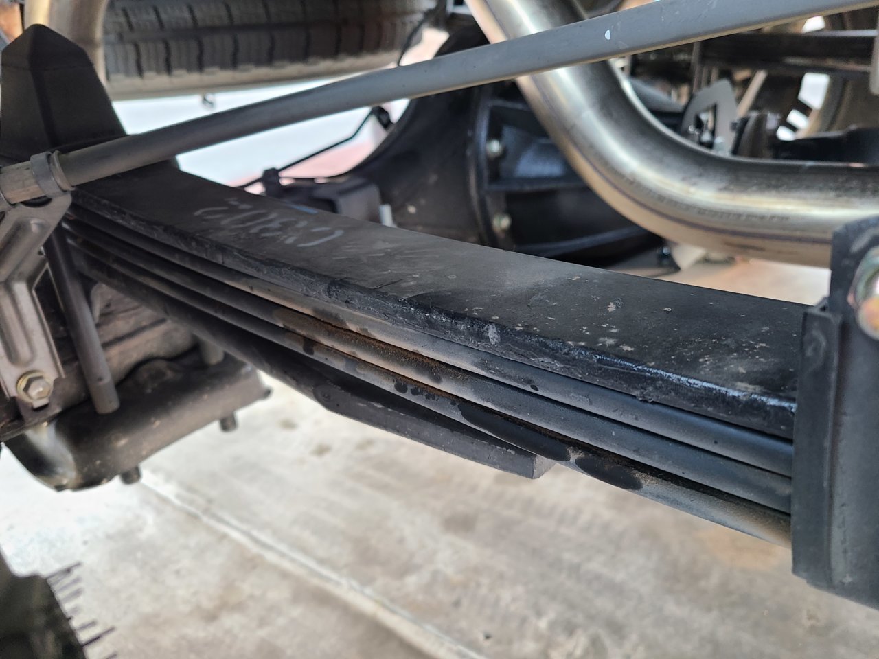

    looks the same as mine, too. you sure its the 51200 pack? should be marked on the leafs somewhere in white paint.

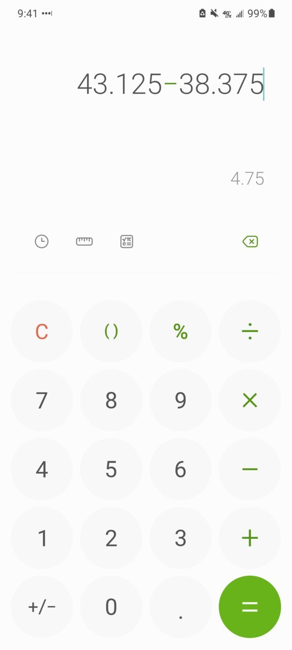

    Before and after, same tires, same Psi, parked same spot

    That's from ground to fender

    I didn't think to check the numbers, I just verified they were the same (no left vs right), dammit
