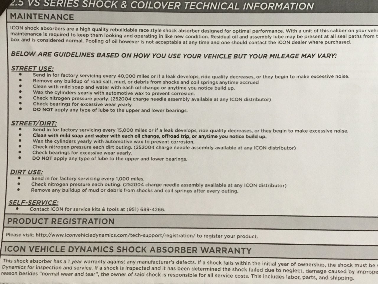

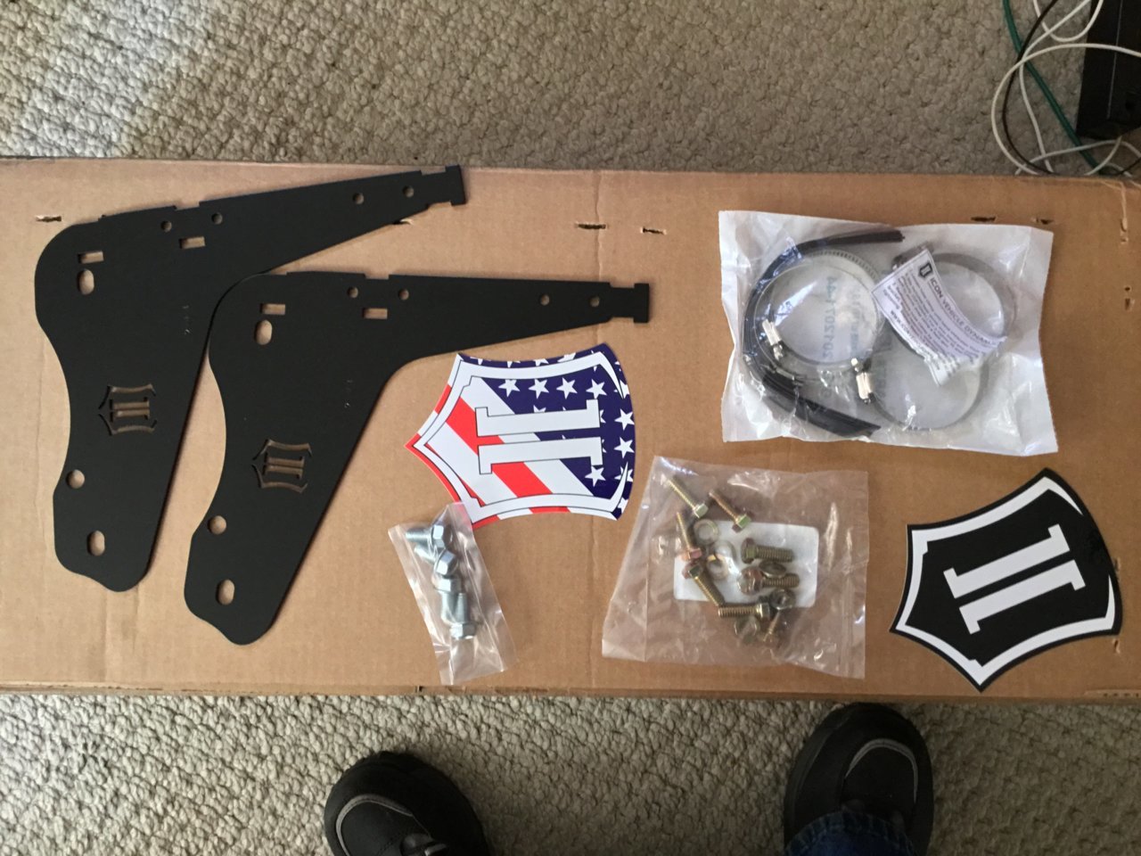

    Thank you.... here’s a few pics of the icons 2.5 with resi....and cdc....along with maintenance recommendations from icon....looks like every 40 thousand miles street use....

    All a rebuild is replacing some seals, oil, and visual inspection of the mounts, shafts for any pitting that would rip the new wiper seal. DIY for under $150. The oil being the expense. If not capable of DIY, then it’s going to be the turn around time to whoever is performing the rebuild. Plenty of places that may be local or sent out to the actual manufacturer, or distributor/shops that rebuild.
    if it’s a street queen truck, then I would not bother until 50k miles atleast. Keep an eye for any leaks until then. Periodically check the nitrogen pressures.
