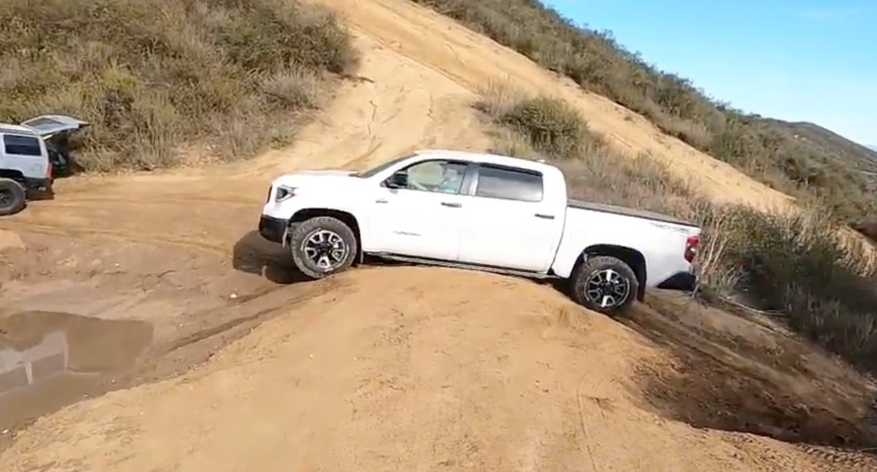

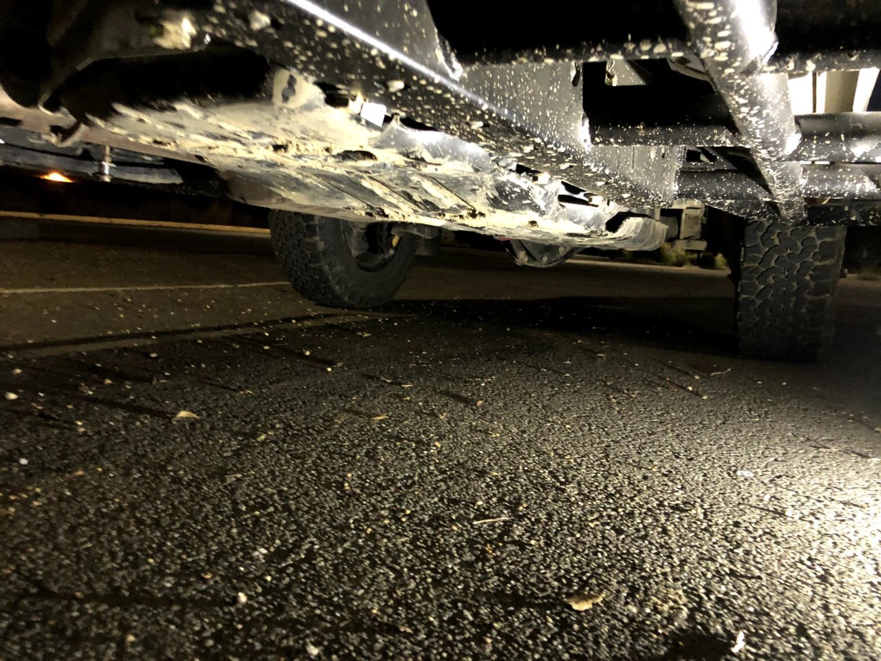

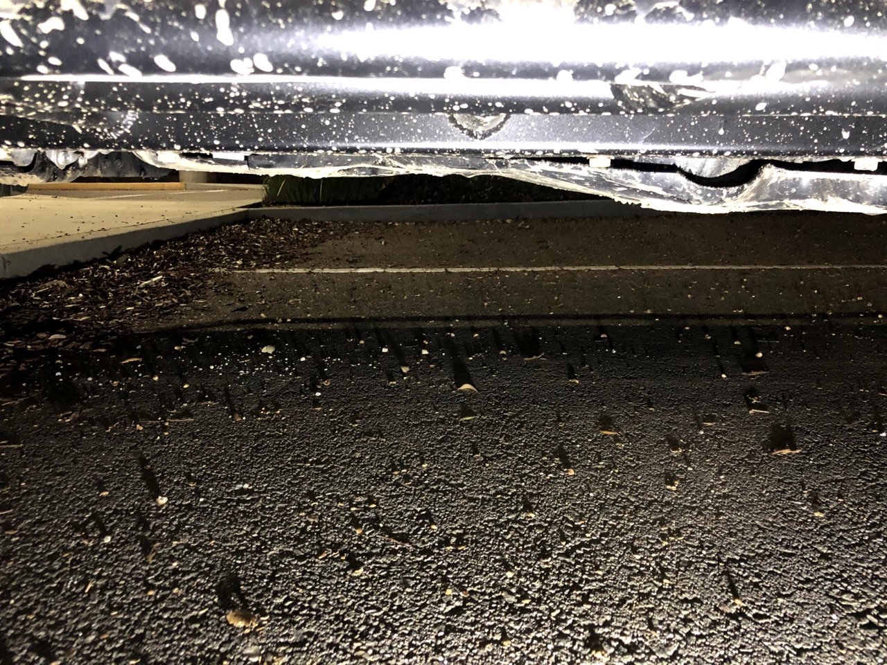

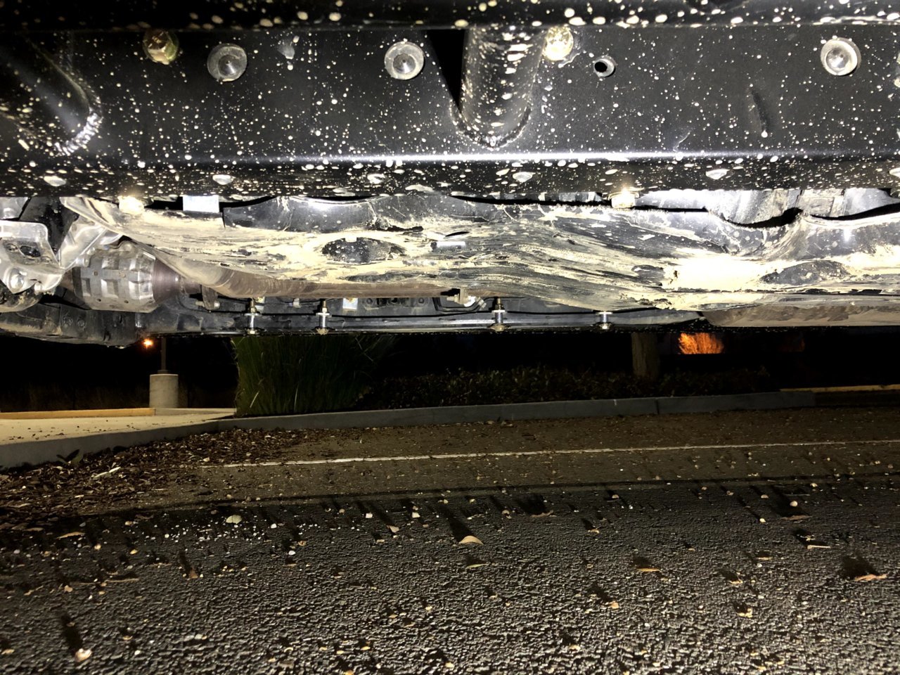

    Hi everyone,
    I did some off-road yesterday and I was a bit fast when going over a bump. I did feel the bottom of the truck was touching the ground for a moment. I believe the gas tank was high centered. I will post better pictures later. Is it bad? any idea?
    Thank you

    If it runs, doesn't leak, and your gauge seems as accurate as the non-accurate stock gauge, you're fine.
    I'd probably carry 5 gallons with you until you run it through a tank and make sure the fuel light and fill up are when/what you expect it to be. I've had dented tanks where the needle stopped at 1/4 and I didn't realize and then ran out of gas before.

    Pull the oe skid and replace with any of the aftermarket alternatives. Your tank could be just fine, but the oe fuel skid looks to have seen better days

    The pictures look like the OE skid?? If so did you drop that to look at the actual tank?

    I think it’s fine. The frame took the brunt of the load.

    Those plastic tanks usually pop back out with the weight of the fuel. Usually in a case like that, the "skid" takes the abrasive forces and the tank just flexes.

    Yeah. There’s guys running trucks fast on here with that OEM plastic gas tank skid. It’s very strong, well-designed, and protects the tank. Just high-centering (and sledding off) won’t cause a problem.
