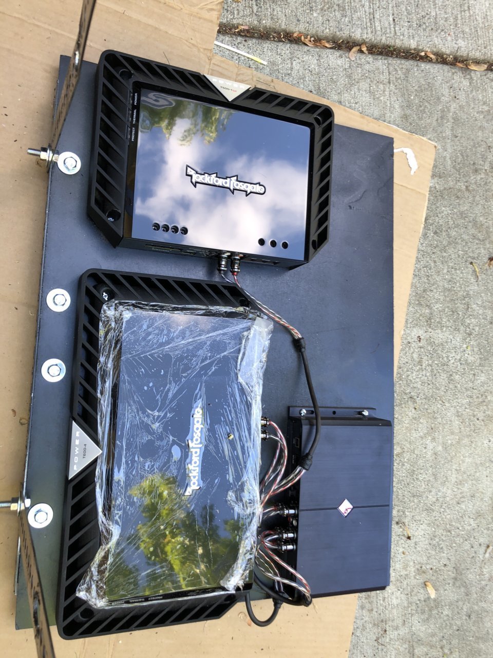

    5942465E-1D03-4617-AD8C-63DD30E93623.jpg Hey man! When I did my audio setup, I used all Rockford amps. And still working to this day!

    setup looks good but i’m trying my best to condense everything into just one amplifier unit.

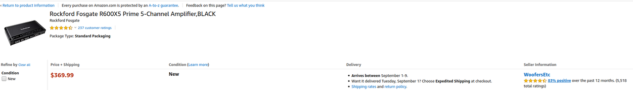

    I have had a 5 ch Rockford amp in my closet for a few years. I never used it because I wanted something different. It s a good amp, but it s for someone who isn t after a lot of power. It s a Prime R600X5 model. Basically it s four channels @ 50w @ 4 ohms, and a sub channel @ 200w @ 4 ohms. Or 75w @ 2 ohms, and 300w @ 2 ohms. This is the only one I m familliar with but there s many 5 ch amps to choose from.
    Note: Uhh, I guess it s been discontinued. They may still be on the market though.
    WoofersEtc is still selling it.

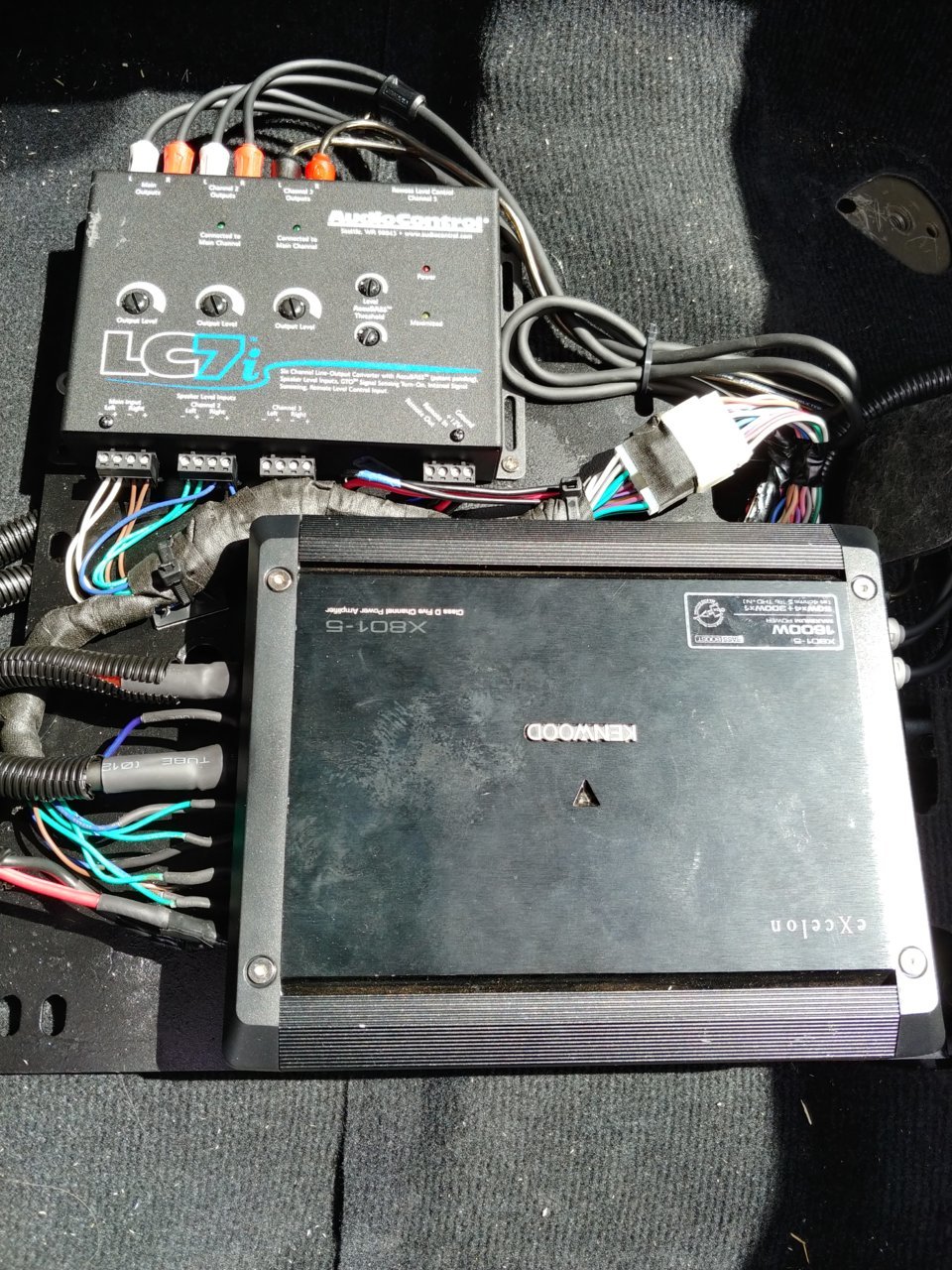

    I have a Kenwood Excelon X801-5, but now there is a newer model out. You should still be able to find one though
    Connected to AudioControl Line output converter LC7i.
    If you are keeping the Entune Head Unit you will need something to clean up the signal before it reaches the amp.

    Is that what the converter does? Cleans up the signal? Explain pls, I'm ignorant of these things.

    Yes Exactly correct. It also has accubass feature. A lot of factory head units "roll off" or turn down the bass automatically as you turn up the volume, to protect the cheaper factory speakers.
    You could upgrade a little from the LC7i and get a DQ-61.
    Has more options and provides equalization and signal delay along with accuBass
    I think others can explain it better than I or look up those items on Crutchfield.
    Im pretty bad at explanations...lol

    What happens if the amp dies after 6 months..? $369 in the trash. I don’t know who pissed in your Cheerios this morning but I wasn’t looking for any argument. Was just recommending an amp that worked for me. Not sure why you got so argumentative about it.

    If you buy a new unit from an authorized seller, (WoofersEtc is an authorized seller), the one year warranty still applies, so you are incorrect to imply otherwise. If the amp did break Rockford Fosgate would replace it with the newer unit that replaced the R600X5; the R2-750X5.

    I stand corrected. Thank you for the explanation

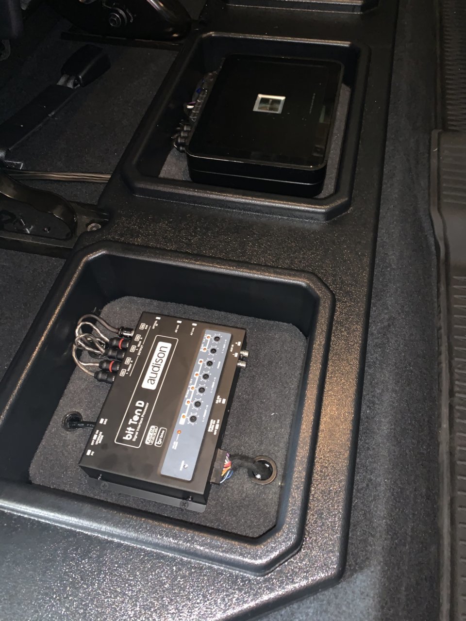

    Alpine PDX-V9 and Audison Bit Ten D DSP...first time to use Alpine amp, and so far very pleased...

    Very nice set up with the ESP storage. That’s what I had in mind but debating because I could really use that extra bit of storage.
    Looks great!

    Thanks, appreciate that...was planning on swing storage in bed, so the underseat storage turned into amp rack...
