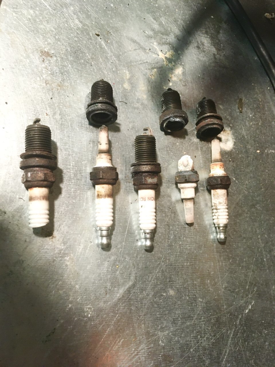

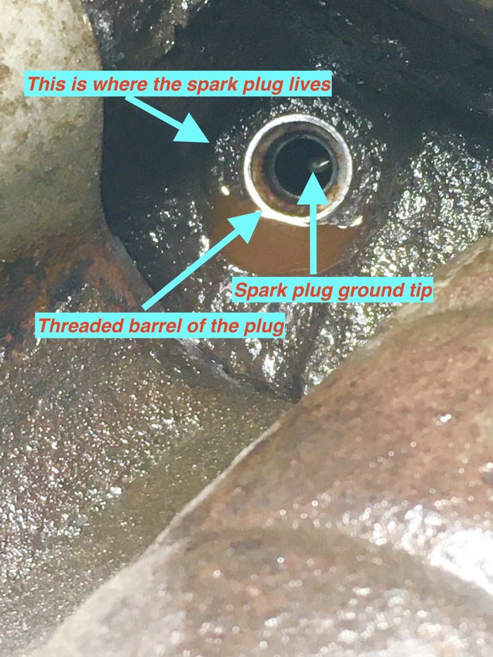

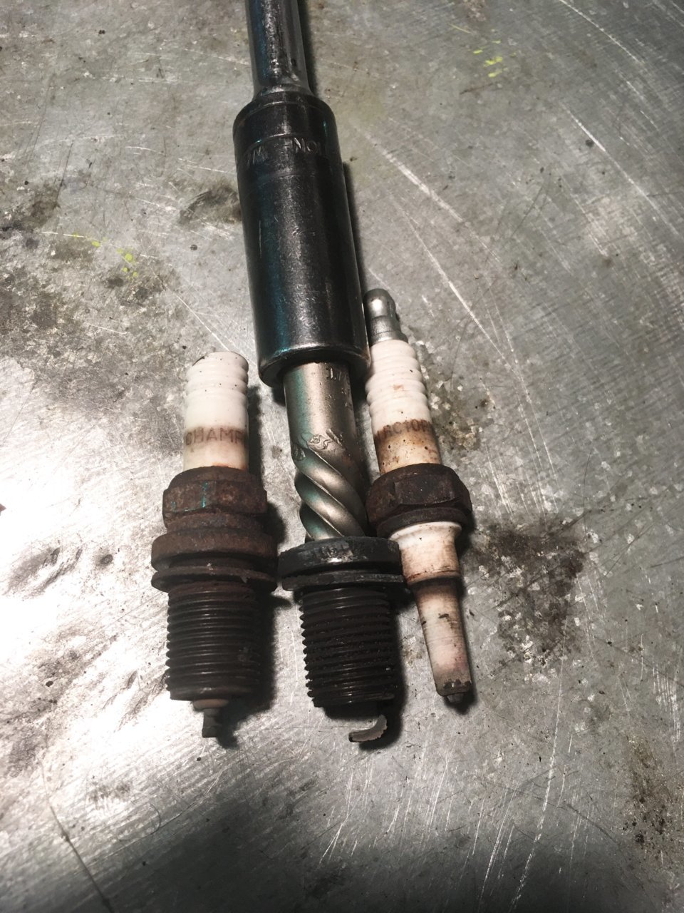

    I recently bought a Dodge 2500 4x4 plow truck (Plow Included) with 94,000 miles on it for $2500 and decided to do a spark plug change on the V10 engine. Well, long story short the passenger side 5 plugs were changed with great effort and the other 5 be waiting for a miracle to happen.
    Why why why are spark plugs breaking off in the heads these days?

    I bet they have never been changed

    Looks to me to be a poor design with that well around the plug allowing water to just sit there beside it. Also Champion plugs should only be used in lawnmowers. ;)

    You need to use anti-sieze on the threads only, prevents what happened. Dodge has used champion plugs forever. The old Ford 5.4 did the same thing. Aluminum heads and steel threads.

    Anti-seize is your friend in these scenarios just to save you the headache for next time

    Yep, Yep the left bank of plugs are slathered with Anti-Sieze.
