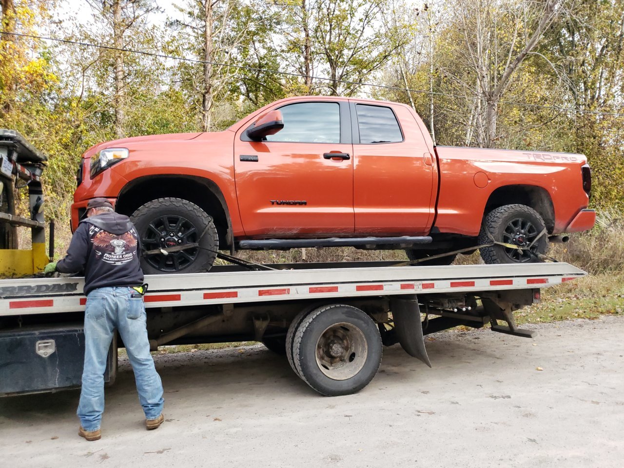

    This was mine this last week. The alternator stop working and then the battery died. I was out in a rural area and could not make it to the dealership. This was caused by the cam tower oil leak. The oil falls into the alternator, it was all wet with oil. I didn't think it was that bad because I never have to add oil and it does not leave anything on the ground. I am just going to have to have the towers resealed soon. I wish Toyota would help with this, I have called but no luck. The truck has just over 104,000 miles.

    Seems almost impossible for it to leak onto the alternator. Usually I see them leaking towards the back of the engine. Probably because it’s tilted that way. Not saying it’s impossible, I’m just surprised. Sorry you’re having problems. I never like to see a Tundra on the back of a flatbed.

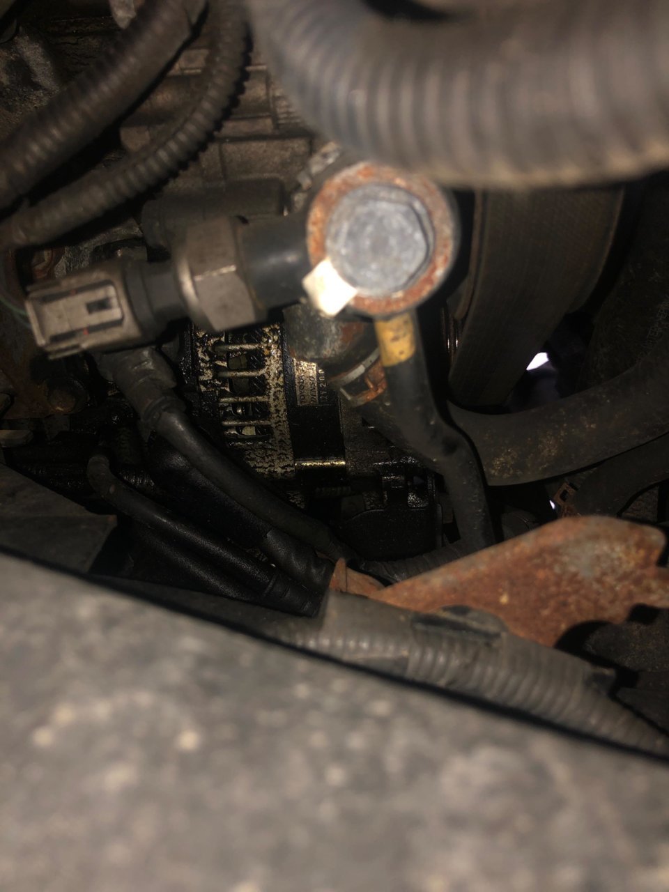

    Here is a photo of the alternator the dealer took

    My FJ Cruiser alternator failed at around 150k, and looked identical to that. I could barely get the damn thing out it was so slippery. On those I believe its the timing belt cover - and oil has a sneaky way of going in direction you wouldn't believe. Its not always just a drip down.

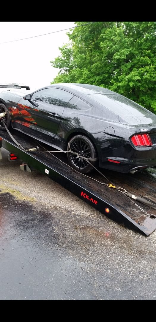

    Got a similar photo. Mustang was only a few months old at that point. Had a horrendous scraping sound coming from the back end. I feared a wheel bearing, but it ended up just being a rock stuck between the brake rotor and shield. The sticky summer compound tires that come on that particular GT configuration never ran over a rock they didn't want to keep.
