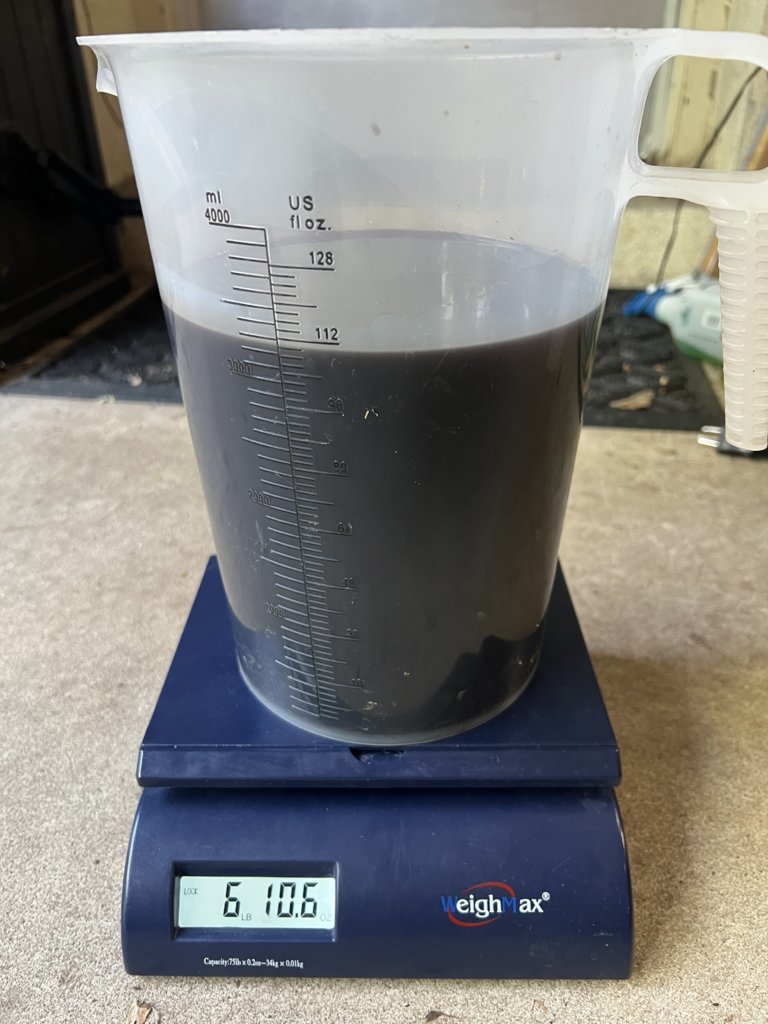

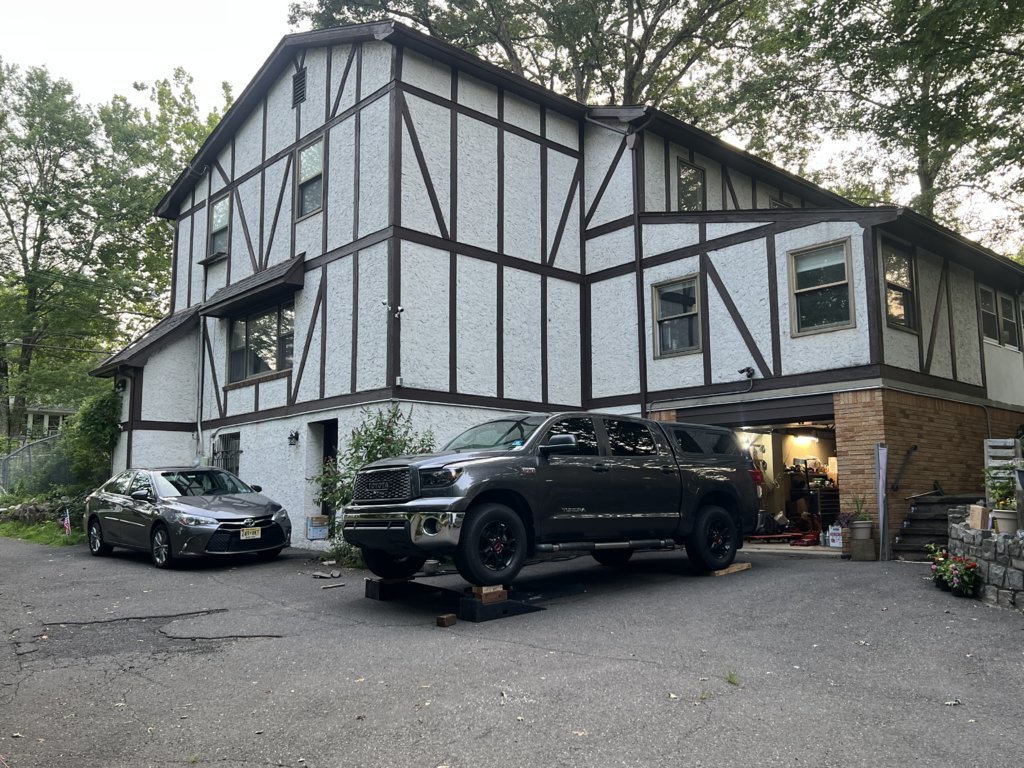

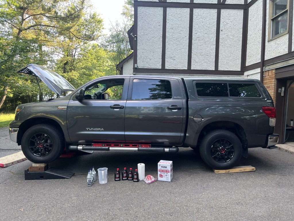

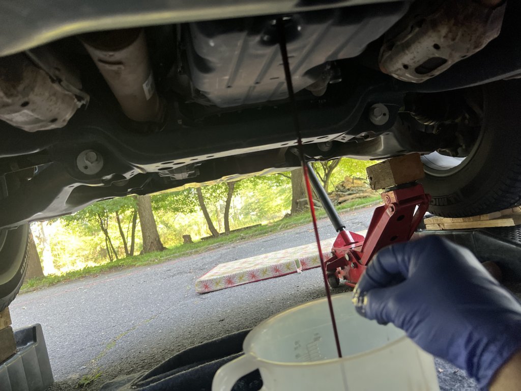

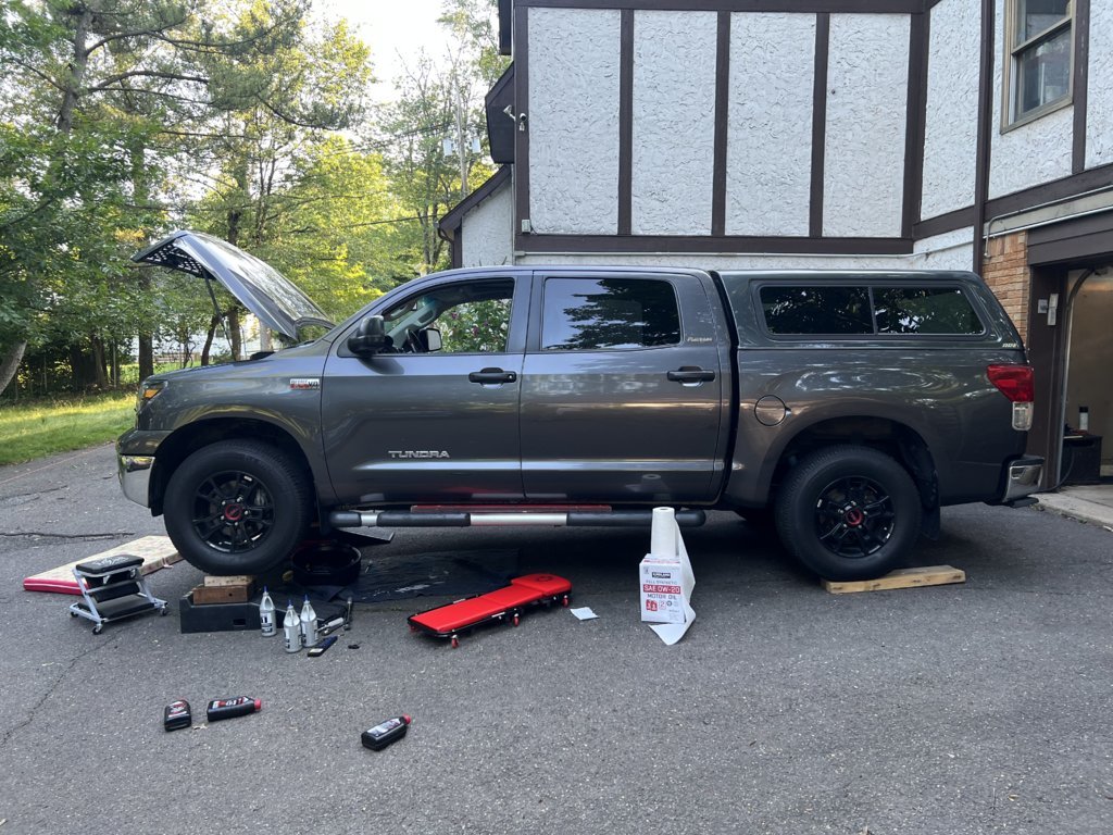

    Just over 4 years and shy of 51k miles in between, I did another ATF drain and fill. This time I did it using ScanGauge 2 at temp range of 99°-111°
    Drained almost the same exact amount, 0.6 oz. less than last time
    I drained 3.5 qts and ended up putting the same amount. This tells me that the method I used before should work, as long as transmission wasn’t low to begin with.
