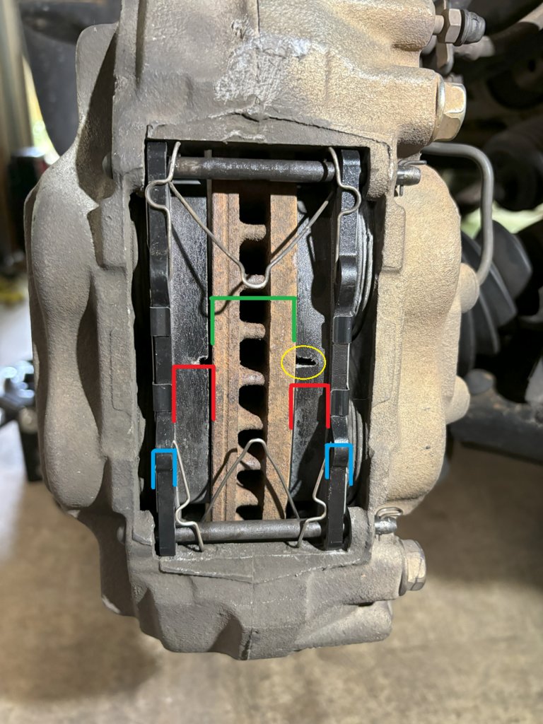

    I'll break up fronts and rears into two different posts. Front in this reply. Rears in next reply.
    Fronts are easy as pie. Take off a front wheel Find the rotor, the clampy thing mounted over your rotor/disc. One side has a slot. Look into the slot. The vented part (in green) is your rotor/disc. The blue part is the baseplate for your brake pad. The red section is the pad surface or stopping material, you see that notch in the center I circled in yellow? If your pad has it, andyou can't see that anymore, you need new pads, they're too worn. Otherwise, you need to have minimum thickness of about 2-3 credit cards still on the base plate, and if you don't, there's a squealer that can create a screech in miscellaneous conditions at higher speeds, one of which could stop if you tap on the brakes. Note: The pads slide out with 2 minutes of very basic disassembly. I can link you to a post that will help you change your own brake pads, it is REALLY EASY on these trucks. No bolts to remove, just clips, and you need to know the correct way to orient the pads, and you DO NOT want to use store brand pads. Buy Advics brand pads, they made the OEM pads and they give you all new hardware, and pre-glue all the shims onto the pad base plates, making it the most-plug-and-play experience possible.

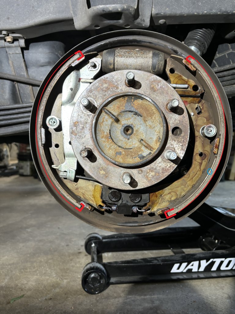

    Rears ... I'm going to show you what you're looking for, then link you with a video from JDM driveway that will show you how to get into the drum, since it's not obvious if you've never done them.
    Same deal here. Pad material is the semi-circle band Im showing in red. That's glued onto the thin metal strip the blue circle is highlighting, hope you can tell. You want to have (A) fairly even wear from end to end, though they're always off a bit, and (B) again, you want to have at least thickness of 2-3 credit cards of material on here. Though I don't think your rears are an issue, this is something you should be checking during an annual or bi-annual safety check on your truck. The adjustments Sal shows in the video below will also have your truck stopping on a dime if it's properly bled (i.e. you bled the LSPV if present, and you bled in the proper order after).
