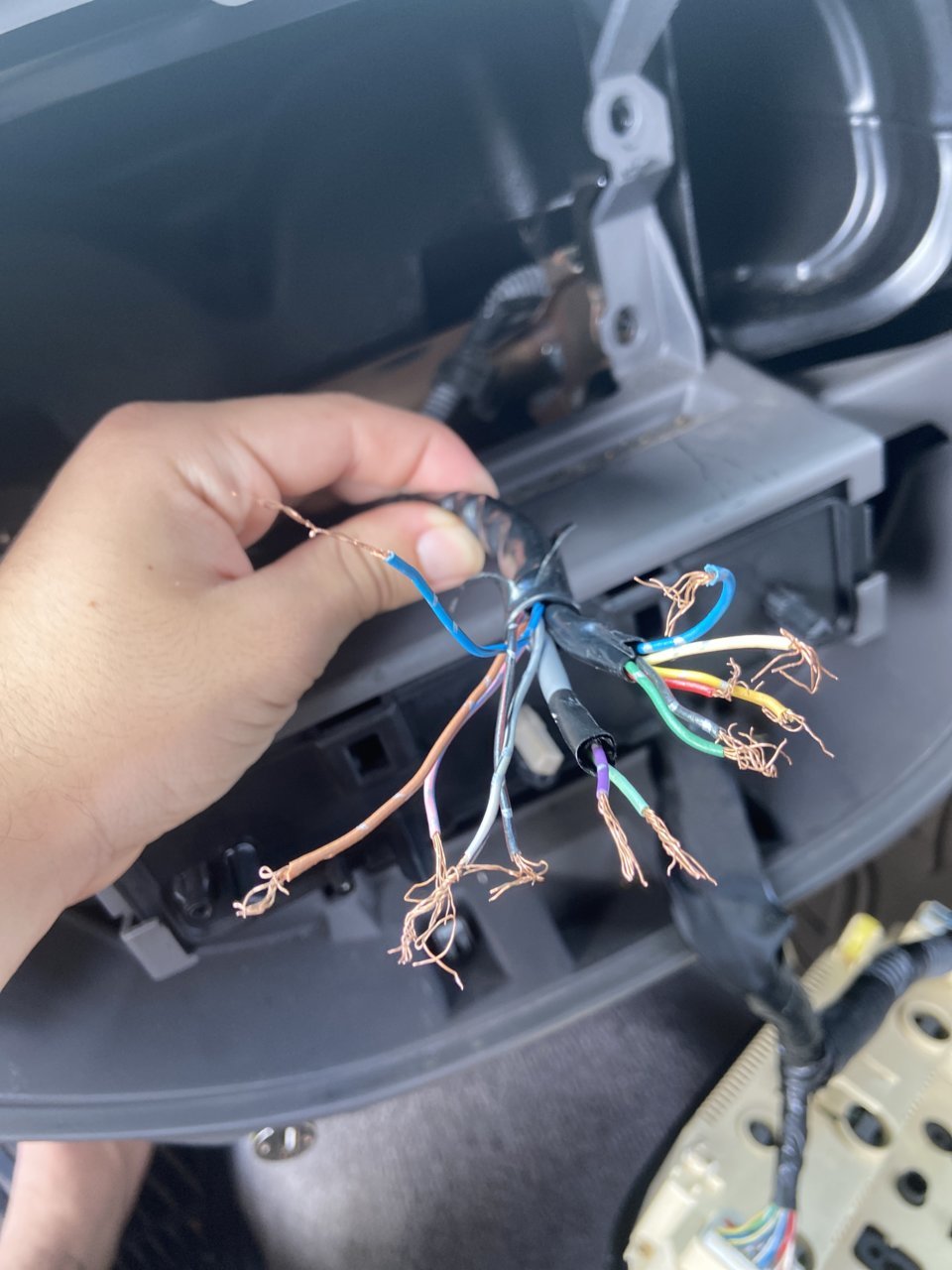

    Wow did you find it that way?? I think this may help, double check:
    edit*: the list below looks less confusing
    Do you have a mutimeter to check the at least a few of the colors listed in the link above, like test for 12V, 12V acc, etc. ?

    Constant 12V+ Blue/Yellow
    Switched 12V+ Gray
    Ground Brown
    Illumination Green
    Dimmer n/a
    Antenna Right Front
    Left Front (+) Pink
    Left Front (-) Purple
    Right Front (+) Light Green
    Right Front (-) Blue
    Left Rear (+) Black
    Left Rear (-) Yellow
    Right Rear (+) Red
    Right Rear (-) White
    This is a guide only. Some wire colors may not be 100% correct. This looks less confusing than the other link I sent.

    I'm not sure what you mean, you tried the diagram? Can you see if the yellow is reading 12v always?
    I guess if you dont have a DMM, you could grab the lightbulb out of your, say, dome light and connect the yellow and brown at the two ends and it should turn on. The grey brown will turn the bulb on when you have the key to acc position.
    The harness you have has everything labelled, you just have to make sure that the color code I listed is correct and then create a connection: twist together and electrical tape all the way to solder or other options in between.

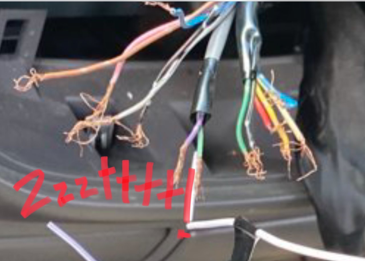

    The stock unit got power but me being impatient just went ahead and cut it instead of getting a adapter harness but when I connect the wires like it says and all the other diagrams I’ve tried it won’t turn on

    Everything is wired and plugged up except the speaker wires and it is still yet to power on I plugged in the antenna and checked the fuses nothing

    If you cut the factory harness plug off I would solder it back on for starters. If you cut the wires too close to the plug you can order a reverse harness.
    Scosche TA02RB
