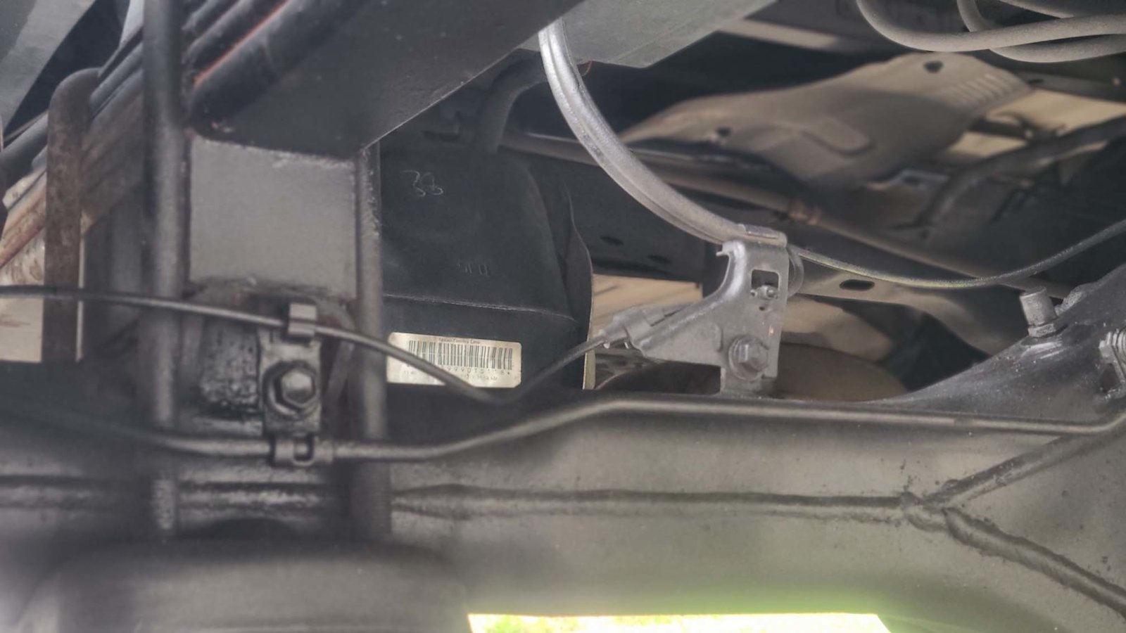

    Lift Block.jpg Gents,
    The used Tundra we bought has 2" rear lift blocks and silver Bilsteins. I can't for the life of me see anything up front that looks like the front was lifted in any way.
    Is a rear-only lift a thing on these trucks, or is this stock?
    Thanks for everyone's patience with my noob questions.
    KNABORES likes this.
  2. Aug 5, 2024 at 3:37 PM
    Hbjeff
    Hbjeff New Member
    Jan 20, 2019
    #24845
    5,114
    Huntington Beach
    2010 DC 5.7 2wd
    Def not stock
    post a pic of the front
    RobertD likes this.
  3. Aug 5, 2024 at 3:40 PM
    RobertD
    May 18, 2020
    #46765
    4,855
    Robert
    DFW, Texas
    Also a side shot. If they added 2" to the rear and left the front stock height, you should have some rather impressive rake going on.

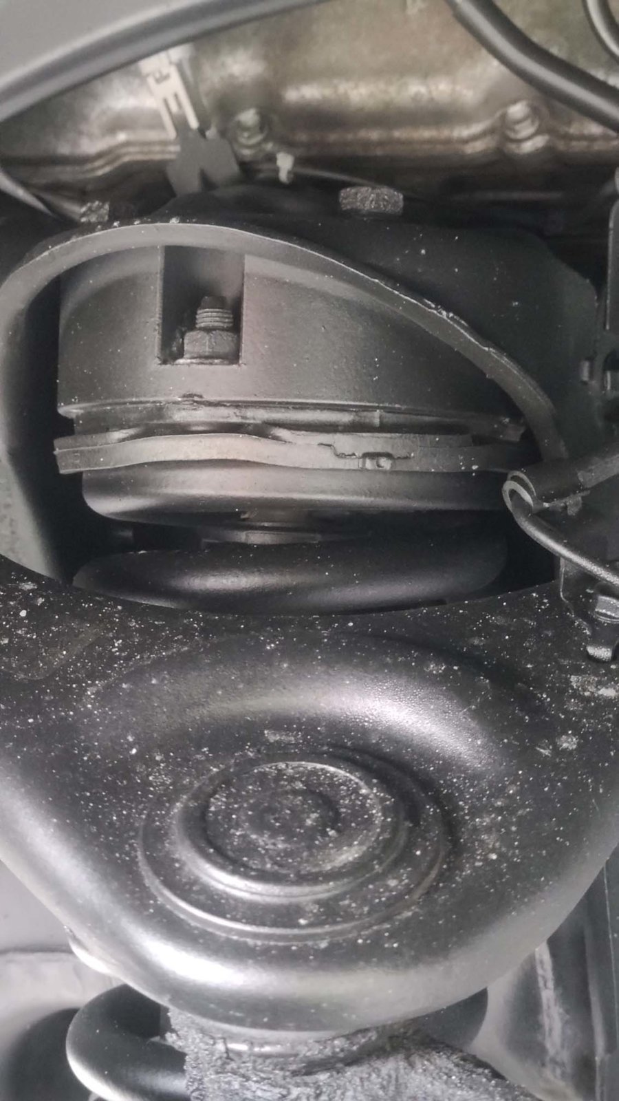

    Alrighty then... a little bit more searching of the internet and I believe I found it.
    I assume that's a 2" spacer at the top of the shock.
    Any safety concerns? My son (who is the actual truck owner) would prefer to keep the lift. I, on the other hand, wouldn't mind if it disappeared.
  13. Aug 5, 2024 at 4:18 PM
    Tundra234
    Tundra234 New Member
    Nov 30, 2018
    #22402
    18,016
    George
    Florida
    2020 Tundra DC SR5 Barcelona
    Alot of them
    Looks like you have the ReadyLift 3/2 kit. It's fine for onroad use....they just ride rough as hell. Don't do any aggressive offroading with that type of kit.
    Edit.....those front spacers are about 2 inches thick as you mentioned but they give a 3 inch lift. They are not a 1:1 ratio.
    KNABORES and GODZILLA like this.
  14. Aug 5, 2024 at 4:22 PM
    mountainpete
    mountainpete Explore more
    Oct 24, 2018
    #20928
    2,582
    2018 Cement Crewmax TRD
    Function before sparkle.
    Stock? No.
    Great lift? It's one step above adding hockey pucks as spacers.
    Safety concerns? If the truck runs straight and you don't have any unusual tire wear it's fine. Enjoy the truck.
  15. Aug 5, 2024 at 4:44 PM
    poormxdad
    poormxdad [OP] New Member
    Jan 30, 2024
    #111153
    62
    2012 Tundra Grade Four Door 4.6 4WD/ 2007 Sequoia SR5 Leather
    The truck runs straight and is actually pretty comfortable. I honestly have no complaints except for the loudness of the tires.
    Can I remove the front spacers without needing a spring compressor?
    I'm thinking we're going to leave the truck as is until the no name 33s need replacing.
  16. Aug 5, 2024 at 4:48 PM
    mountainpete
    Oct 24, 2018
    #20928
    2,582
    You do not need a spring compressor.
    Leaving it is fine. If you remove it you will need to have a wheel alignment done.
    Wynnded likes this.
  17. Aug 5, 2024 at 4:52 PM
    RobertD
    May 18, 2020
    #46765
    4,855
    Robert
    DFW, Texas
    You will also want to remove the block in the rear which will require new U bolts, if you remove the front spacers.
    If it rides fine and he likes the look. I'd leave everything alone until you are ready to replace both the spacer lift up front and the blocks in the rear.
    GODZILLA and Tundra234 like this.

  19. Aug 19, 2024 at 2:58 PM
    poormxdad
    Jan 30, 2024
    #111153
    62
    Folks,
    I do my own alignments on my track car. Our Tundra ABSOLUTELY has noticeable positive camber up front. I'm guessing more than three degrees. I need to take it to a level spot (while it's not raining), and put my camber gauge on her.
    Can I assume no alignment was performed after the lift kit was installed? I'd rather pull the lift kit than pay for an alignment. I'd bet I could guess and get it better than it is.
    Thanks,
  20. Aug 19, 2024 at 9:08 PM
    Hbjeff
    Hbjeff New Member
    Jan 20, 2019
    #24845
    5,114
    Huntington Beach
    2010 DC 5.7 2wd
    Stock ucas are gonna have camber issues with lifts that tall
