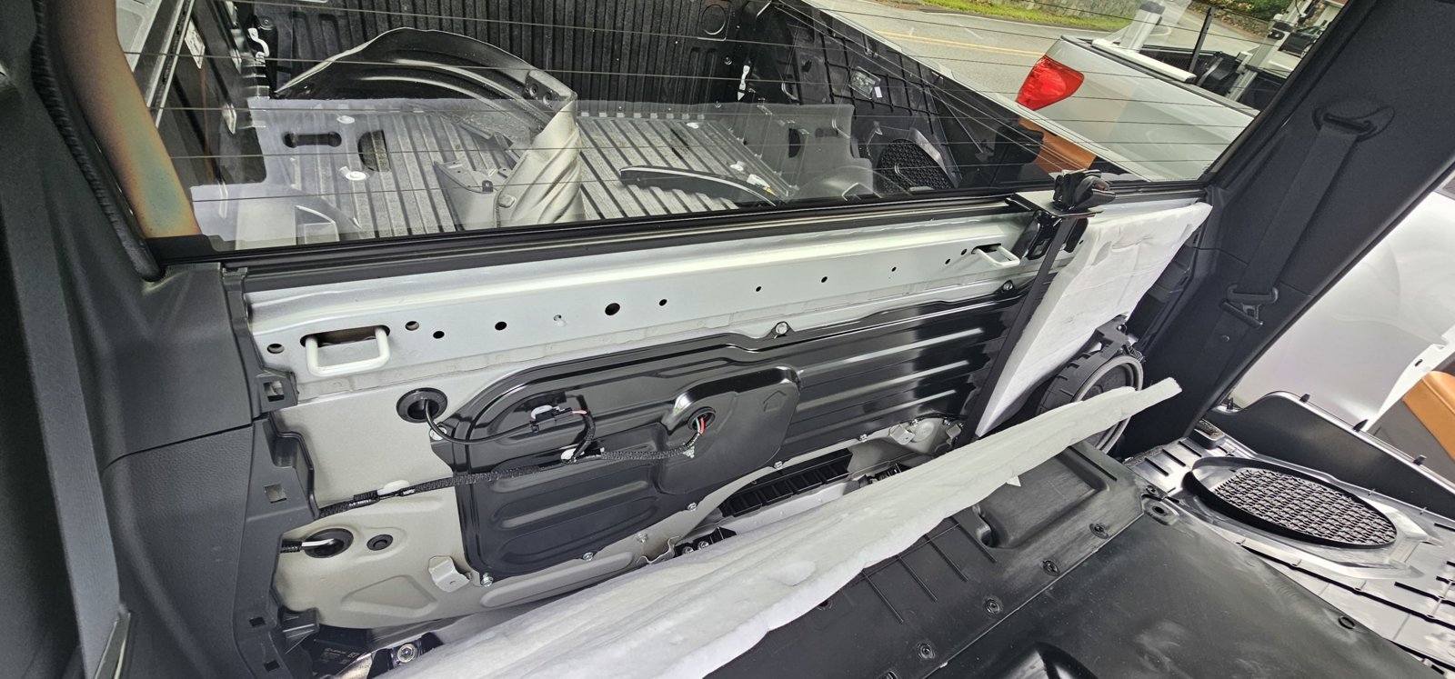

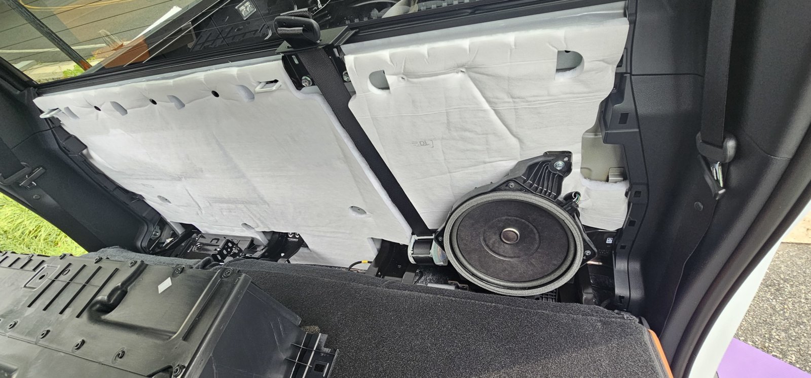

    Your best way to achieve what you want is to just plug the fridge into a DC outlet. Your fridge should have came with both DC and AC cords. The simplest way to do this is by using this...
    Amazon.com: ARB 10900027 Fridge Freezer Wiring Kit and Threaded Socket Mount for quick installation onto your battery, compatible with all ARB Fridge Freezers. : Automotive
    If you have experience wiring you can make it yourself for half the cost, just use good 10ga copper wire, not the copper clad aluminum (CCA) junk. Make it about 10' long and you'll be able to run it into the bed.
    You can wire it directly to the battery under the rear seat on the drivers side. Fold down your rear passenger seat, remove 3 screw/bolts (one holds the jack bag tie down on) from the panel behind the seat. Carefully remove the panel and fold down the batting between the panel and the back wall. Down at the bottom of the cab you'll see the vent.
    You can do one of two things, just push the cable through one of the vent flaps (it's just a thin rubber flap) and into one of the drain holes in the bed, reconnect the wiring to the cigarette outlet. Second is what I would do...drill a hole in the vent panel big enough to snake the wire through then into a drain hole in the bed. Silicone around the hole because water will follow the wire from the drain hole down the wire and try to get into the cab. If you just run it through a flap this will happen and water intrusion is highly likely unless you have a bed cover that is waterproof. I'd think you do since you're putting the fridge in the bed.
    Hope this helps.
