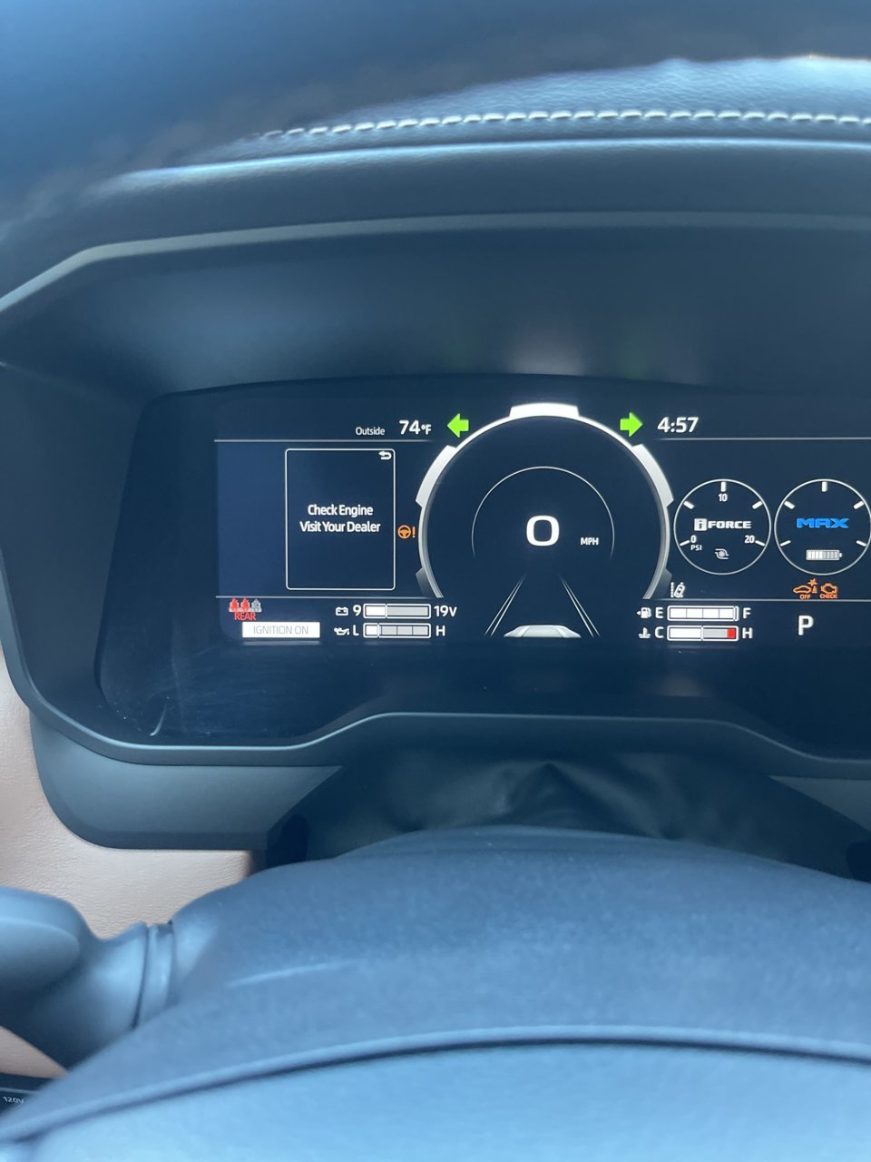

    Just left the car wash with my toddler in tow and my truck shut down and gave these messages. Getting it towed to toyota here shortly. Anyone have any beta on what this means?

    Sorry to hear your truck got the flatbed treatment. I'm really hoping it's something stupid due to the car wash and something getting wet.
    Any engine noises before the truck shut down?

    I had a Hybrid failure. They deleted the code and it runs like charm ever since

    Phew, they just called- tsb for a software update that they did and it’s good to go now

    Any more details please?
    What was the cause?
    What tsb?
    Wtf... It's a normal thing now for a brand new truck to shut itself off after car wash and require a flatbed tow?

    TSB for something to do with the transmission and the computer, didn’t keep my paperwork. It was a quick software update and used running great again
