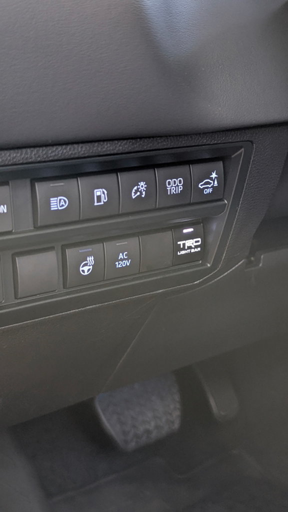

    A buddy and I just recently wired up the TRD marker lights and DD light bar on my 24 hybrid platinum. For the marker lights we tapped into the fuse box on the passenger side. For the light bar we tapped into the right fuse box and ran the wire through the firewall and added a OEM like button on the existing dash. The wiring DD supplies for the light bar is plenty long enough and you not have to connect to the rear battery.
    total grille conversion and lights took probably 2-3 hours.
    It’s very lean and bonus is I can turn on and off the light bar while driving if needed. I’ve heard from factory you have to be in park.
