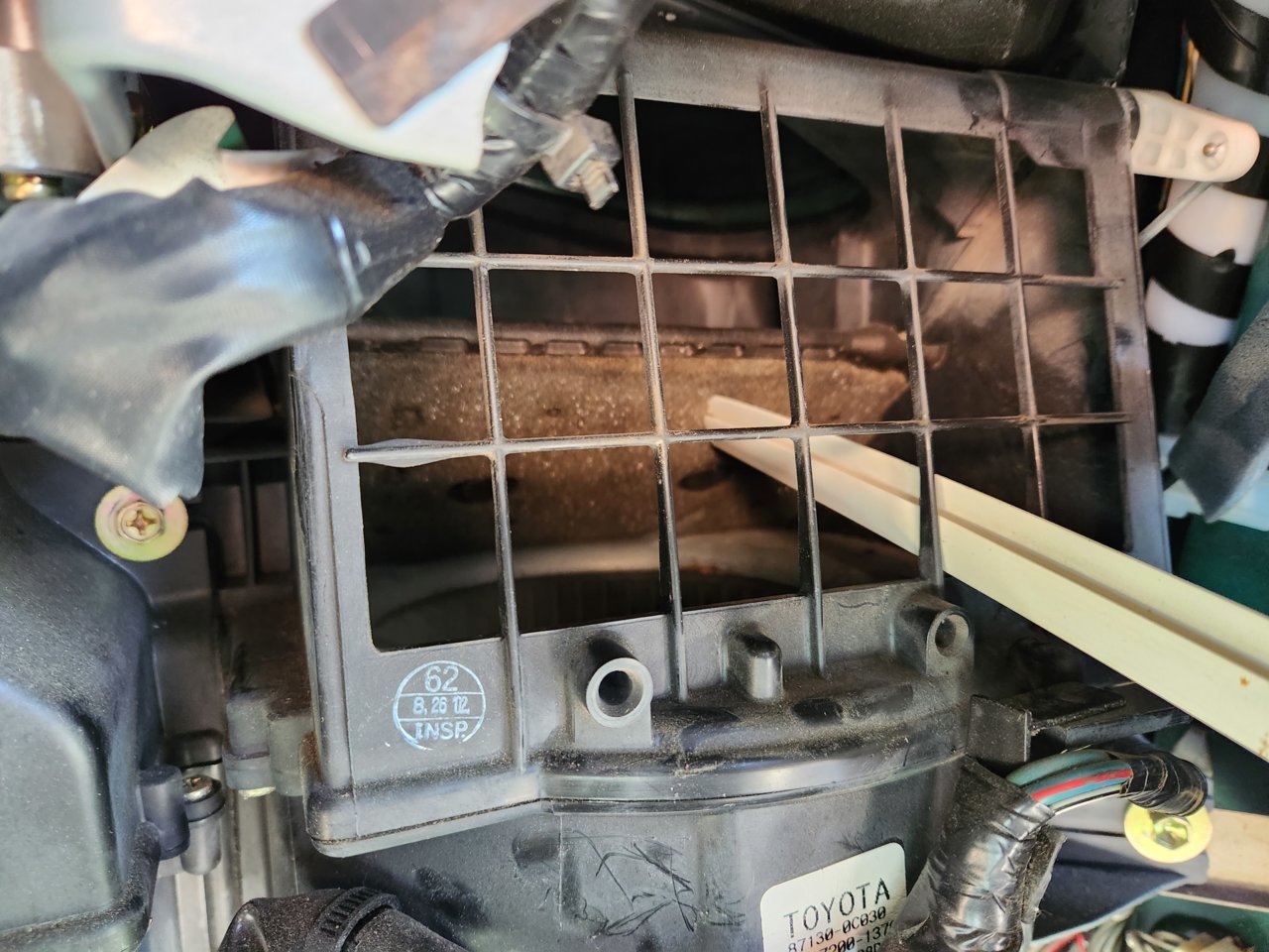

    Anybody know where the ac takes air from when in recirc mode? I can't find any place that's drawing air in. I'm trying to get some ac cleaner spray into the system after the heater core.
    Thanx!

    This is a photo of a broken record door just above the blower housing.
