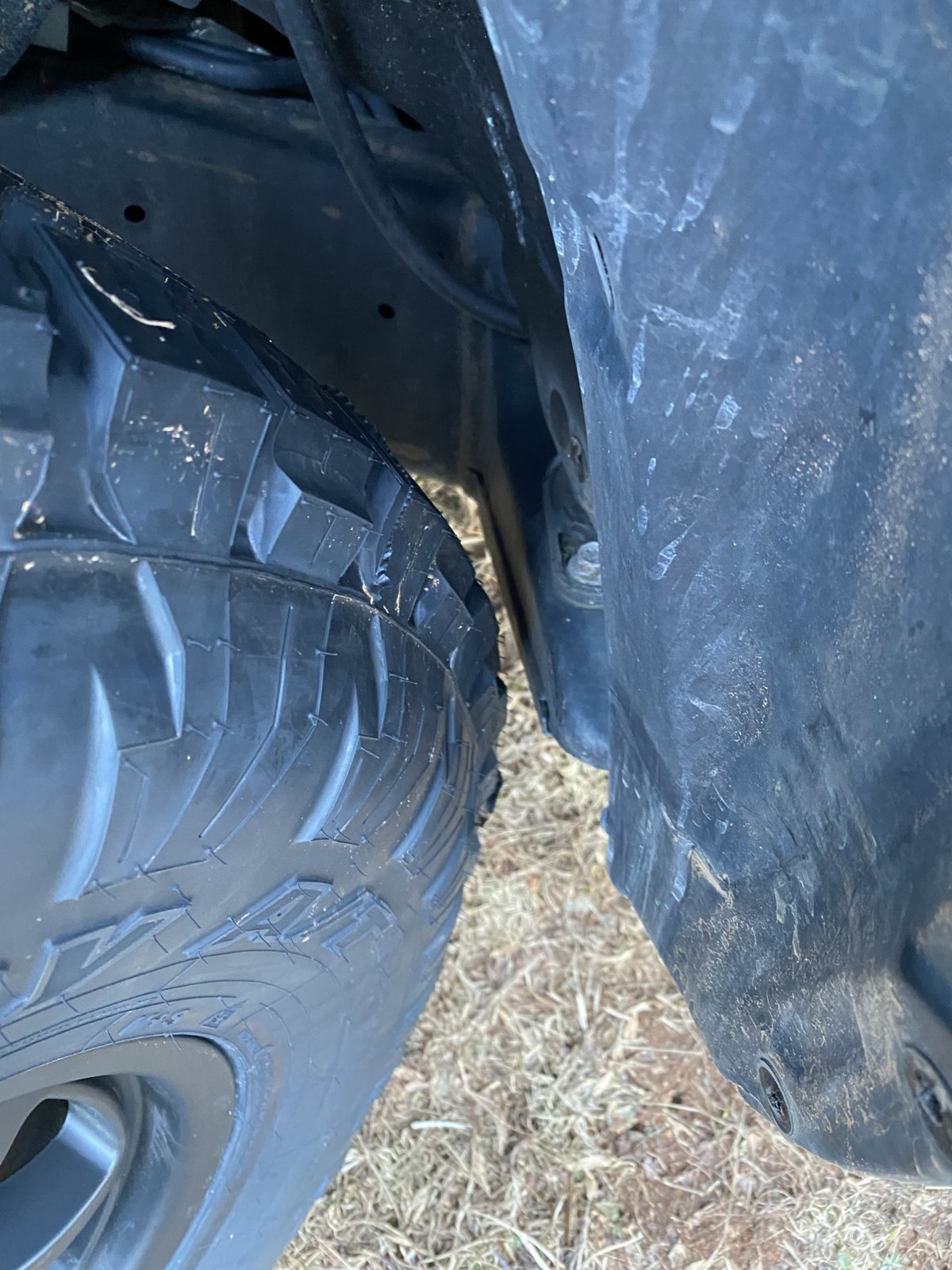

    Bilstein 6112/5160 Method 702 0 offet Toyo open country 285/75 17 Form led headlights OEM Toyota led fog lights Morimoto 3rd brake light Morimoto tail lights Amp Research power steps
    I just put 702’s on mine with 285/75R17. Lifted 1.9 in the front with 6112’s. Had to remove plastic but it clears the body mount.
    First time uploading a picture, let’s see if this works.

    You’ll probably clear the body mount. The 0 offset is the biggest thing to overcome. I’m at +7 and run a 287/70/17 - had to lose the mudflaps, push in the liner and I”ve got coachbuilder bumper shims.
