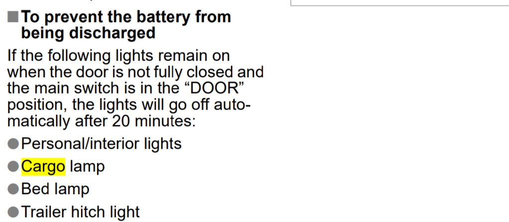

    Also
    22whatwedo, 1lowlife and Raven67 like this.

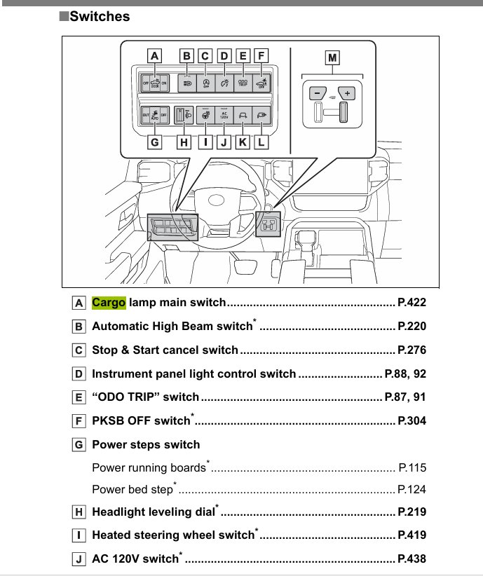

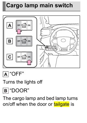

    They turn off after your car is shut off in probably 15 minutes give or take. There is a button to the left of your steering wheel if you get anxiety. Maybe you know but the plug in your bed isn’t strong enough to run that I’m sure and the plug only works with the truck running
