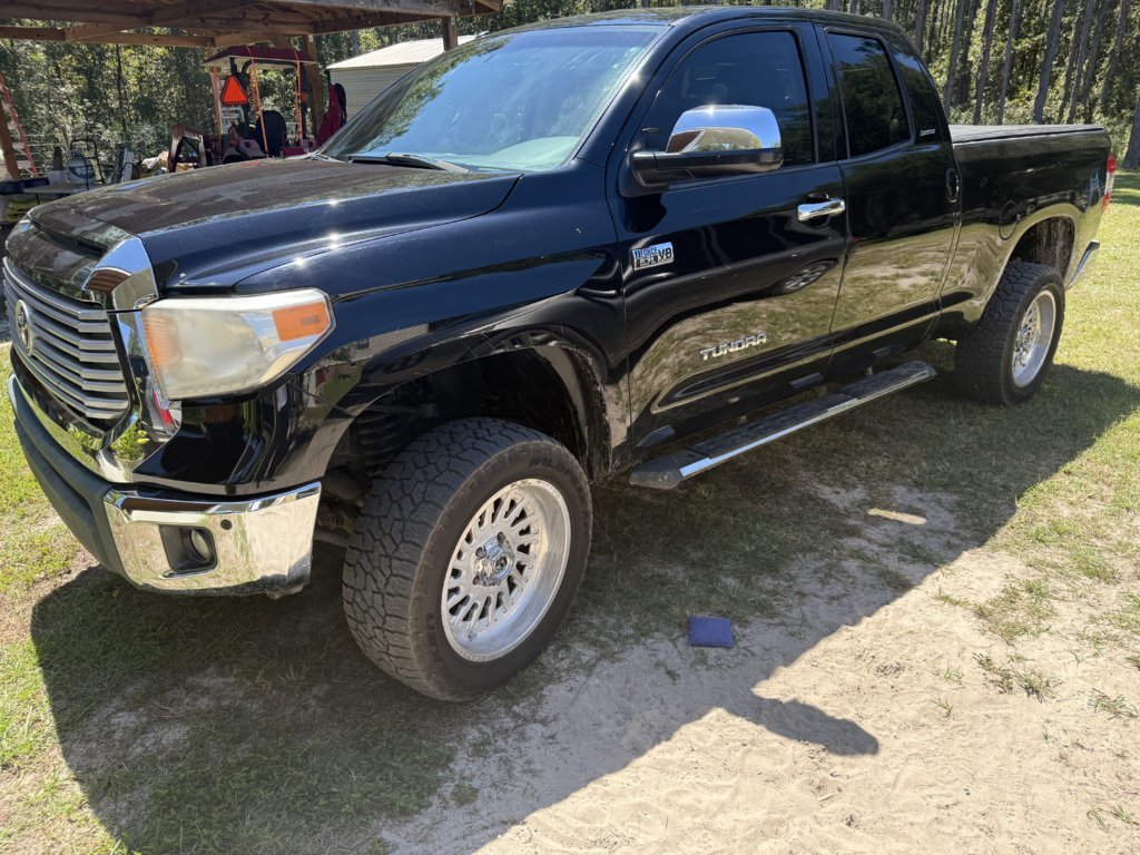

    2015 Black Tundra Limited

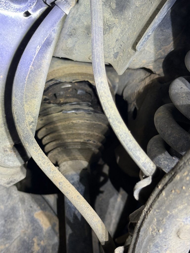

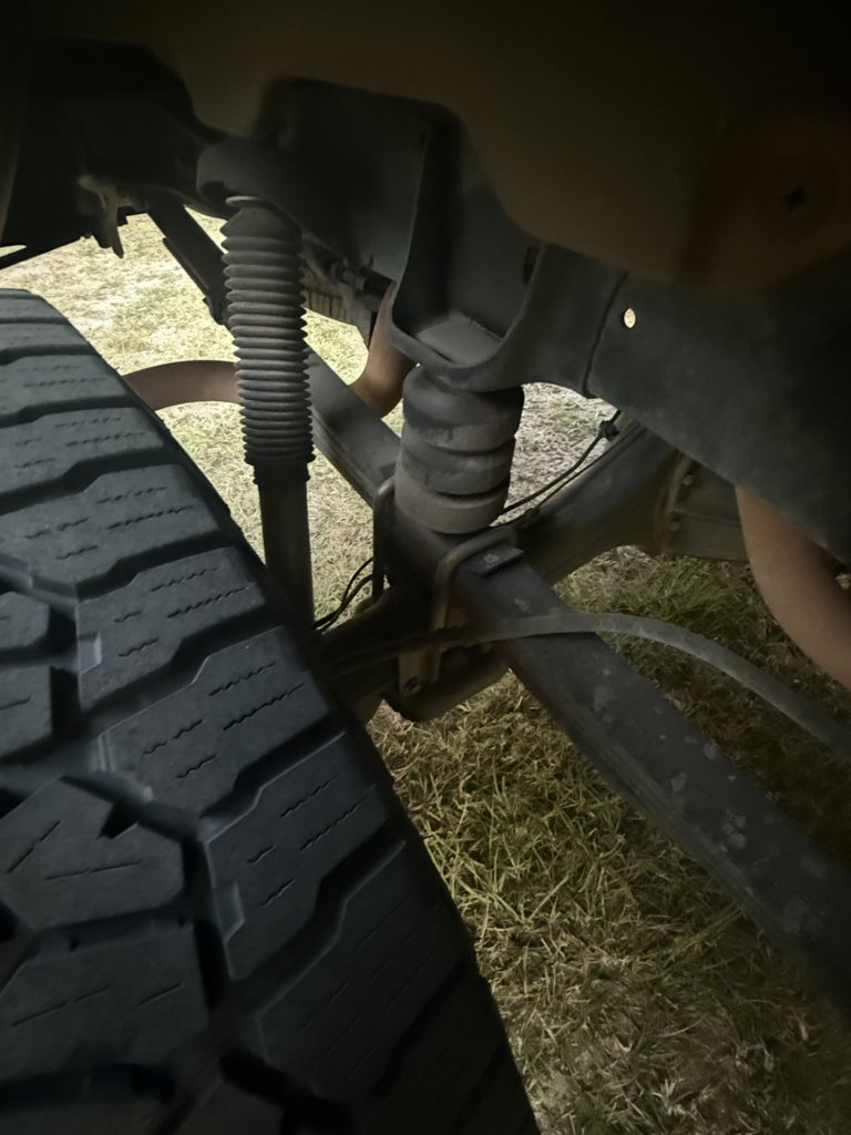

    I bought a 2015 Tundra that was already lifted. 2 Questions.

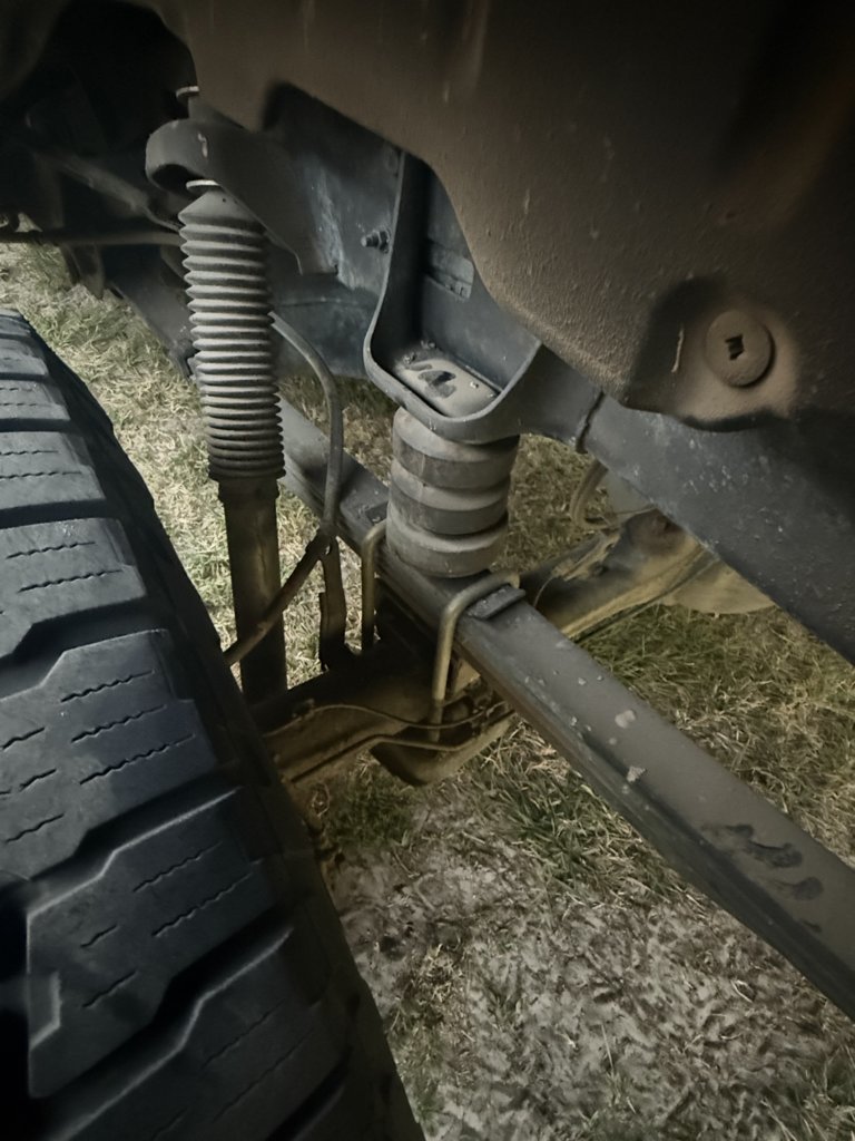

    Q1. How can I tell how much it was lifted? It has a 2 in rear lift Block and a spacer on the front, which bolted onto OE Struts.
    Q2. My passenger side Inner CV Boot tore. Should I invest in an ET CV axel? (To note, it does have a ~1.5 in diff drop.)

    1. It’s lifted 2” in the rear and double whatever thickness that front spacer is (probably 3”)
    2. That joint might be shot if it’s been exposed for a long time. Looks dry. Original axles are way better than any aftermarket ET ones. Most just put high angle boots on. But if yours are shot, grab some new OEMs and reboot, or get some ETs (they will probably fail much earlier than stock would). Also, diff drops are generally hocus pocus. They actually just change the angle of the diff.

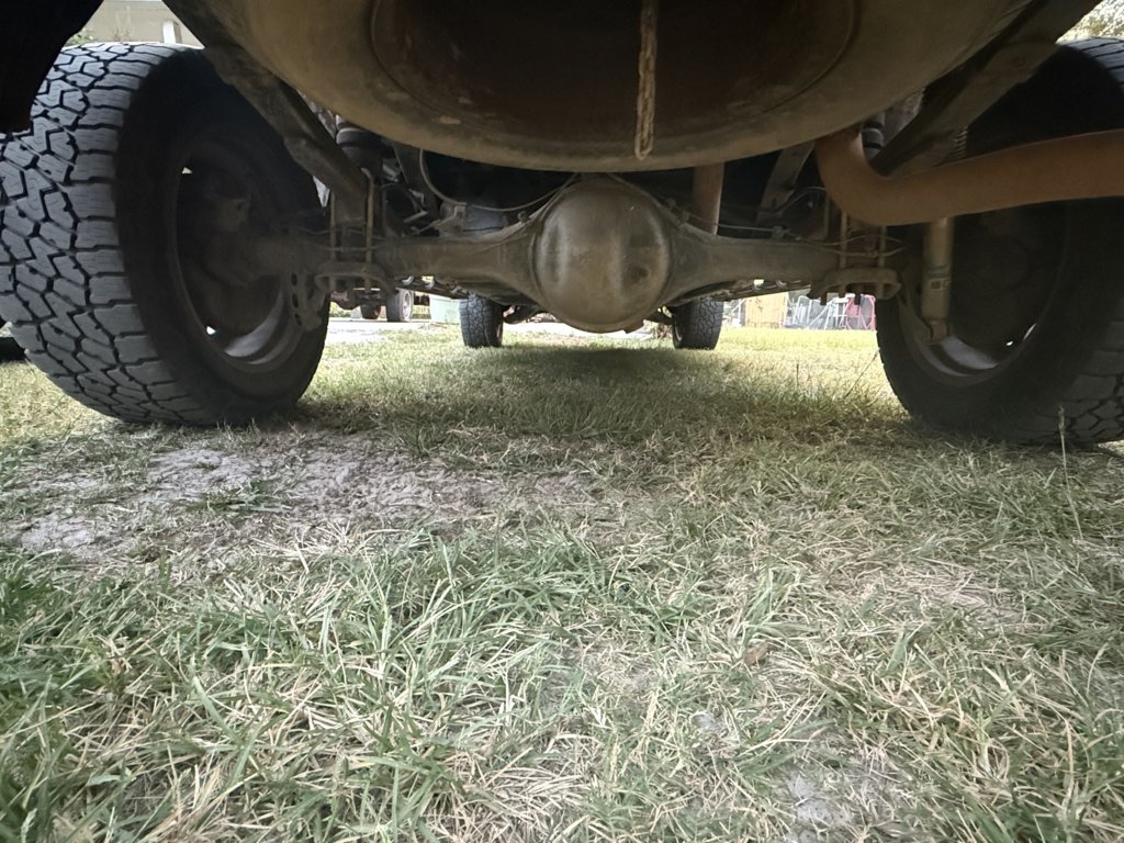

    Sounds good. I’ll take pictures of everything as well. Just to see if your eyes catch something mine didn’t.

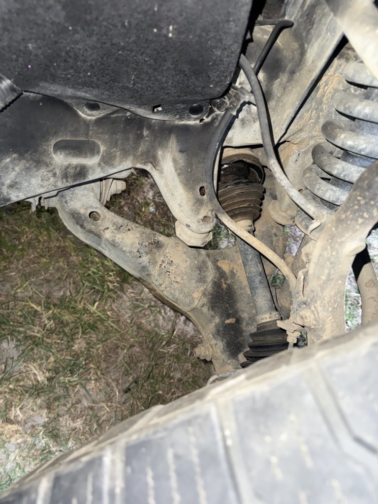

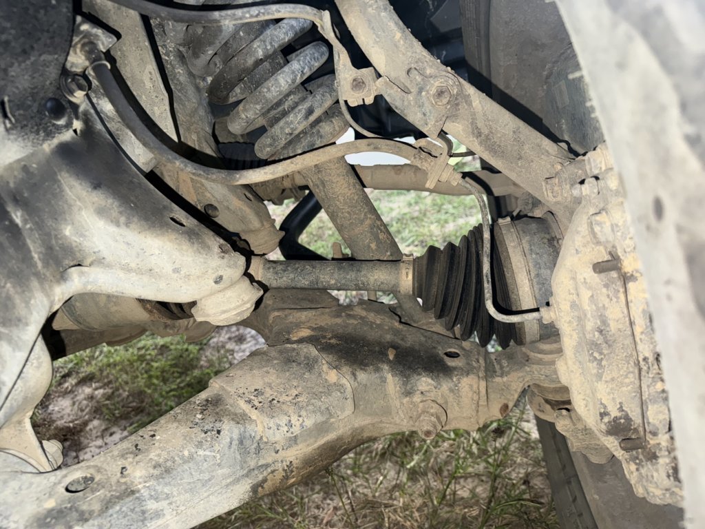

    And looking at my axel it has a slight bend, in the outer boot. That’s why I was curious if I needed ET CV Shaft or is that normal for it to have that about decline. Picture from front of vehicle has that ~1.50in of DIFF drop. I’m driving my wife’s car not but plan to work on mine tomorrow so if OE AXLE is fine I’ll buy that today before I hit the road Saturday in my truck.

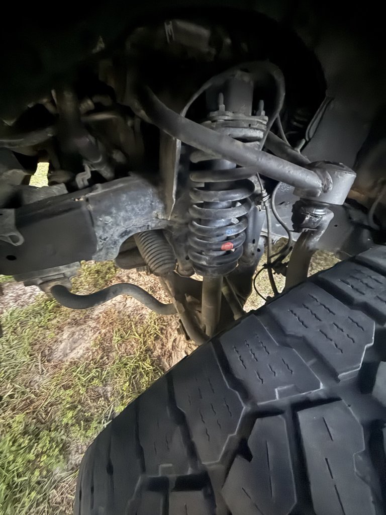

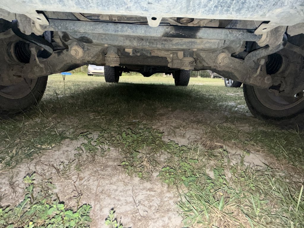

    Needs bump stop extensions or longer bump stops. The LCA's can travel up too far and destroy the shocks

    Hard to see, but it looks like the front sway bar is angled down at the rear. Sway bar drop blocks will help level it.

    There’s no pictures of the front strut setup. What’s that spacer up front look like, what’s it measure in thickness?

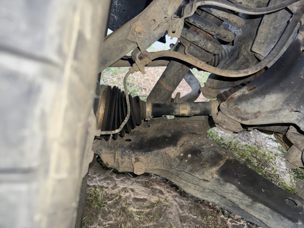

    I’ll have to measure it when I get hom. But here it is.

    That is a giant spacer, and those are aftermarket upper control arms.
    That's gotta be 4.5" of lift up front. No wonder your CVs are wrecked. Probably a kit for a 2wd.

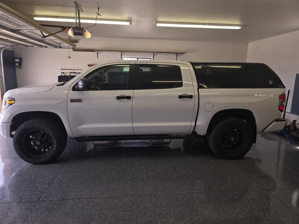

    Here was my truck with the same 3"/2" (spacer/block) lift:
    And here's it with 1.5" rear add-a-leaf + 2" TRD Pro Fox Coilovers up front:
    Truck drives so much better with less lift. CV angles are much better. And it has a modest 1.5" rake that allows it to tow/haul without excessive squat.

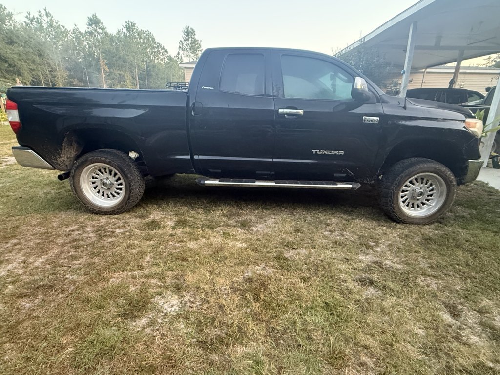

    but overall looks like your truck is lifted about 4” in the front and about 3” in the rear
