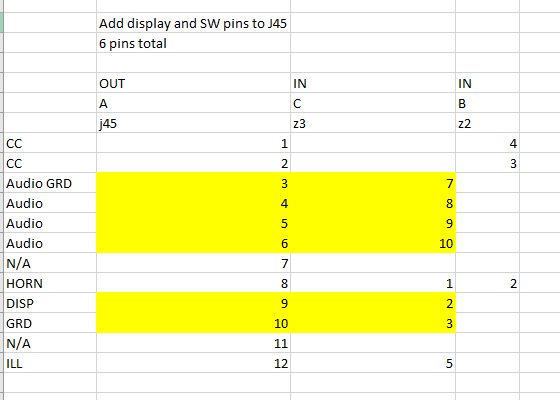

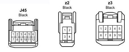

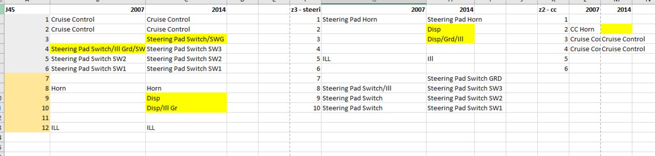

    My first stop was this thread to review the wiring diagrams to see what would work and what wouldn't.
    There are 3 connectors in question. J45, z3, z2. All three of these are part of the clockspring. A quick google search revealed that the clockspring design is unchanged between the 2nd and 2.5nd generations, therefore all the connectors should plug right in. z2/z3 are spinning side of the clock spring and they feed through the clockspring and output to J45 inside the wheel.
    • z2 - Cruise control
    • z3 - Steering pad controls
    Pin locations (Looking towards female side of connector)

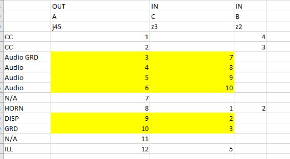

    Spending some time with the wiring diagrams I came up with the charts below. Listing which pins were used for what on the three connectors for 2007 and 2014 years.
    This snip shows how z2/z3 and J45 connect. ie. J45 pin1 feeds to z2 pin 4. I couldn't confirm what J45 pins 7 & 11 connected to inside the wheel but you could always test for continuity if needed.
    Here is a summary of the changes:
    • 2014 added SW3 and moved SWG to J45 pin 3.
    • 2014 added the "DISPLAY" button to the wheel via pins 2&3 on z3
    • 2014 removed a horn ground from z2 (this doesn't affect anything)

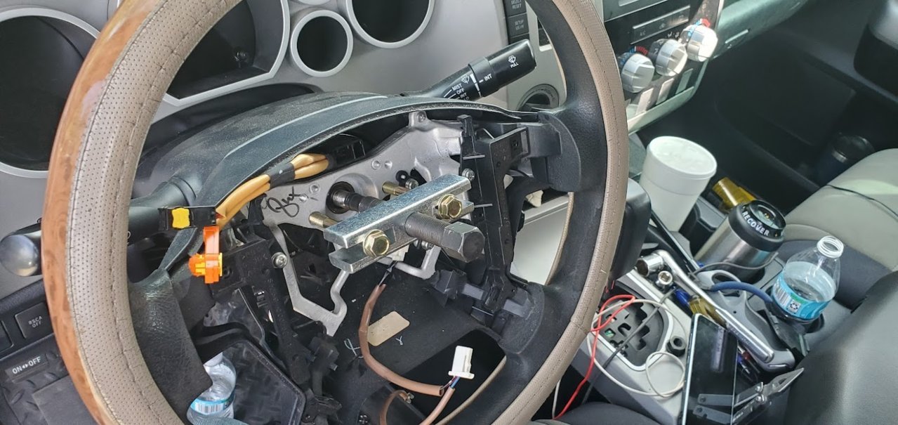

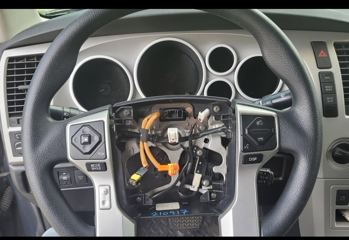

    Remove the Wheel
    1. Make sure wheel is perfectly straight before starting
    2. Disconnect battery, wait 5 minutes for electricity to dissipate, pump brakes to help dissipate.
    3. Remove plastic trim on either side of steering wheel, one surrounds cruise control
    4. Loosen 2 torx (T30?) screws that are now exposed. Note, they do not come all the way out. These hold in the airbag to the steering wheel frame
    5. Pull airbag towards you
    6. Disconnect airbag, use tiny screwdriver to pop up connector locks then carefully remove. Place away from your work area
    7. Unplug z2,z3 connectors
    8. Use 19mm socket to remove spindle nut. It's on there pretty tight. Use your legs on the wheel or have someone help hold the wheel still. Do not rely on the steering wheel lock mechanism, you will break it.
    9. Use steering wheel puller to pop wheel loose.
    10. Congrats your wheel is removed.

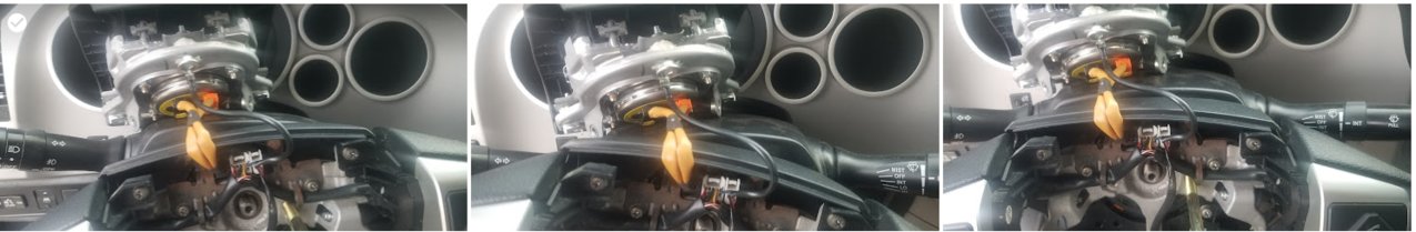

    Install the Wheel
    1. Put the new wheel on straight. See pictures below of difference in what one tooth off makes. 1st pic one tooth left of center, 2nd pic one tooth right of center, 3rd pic is centered. Don't be like me and remove the wheel and try to fix a 1degree angle, that is taken care of with an alignment.
    2. 19mm socket to put the spindle nut back on, torque to 37ft/lbs, pretty tight.
    3. Plug in z2/z3 connectors
    4. Plug in airbag
    5. Seat airbag and screw in, I couldn't find a torque spec for the torx screws but I tightened them very tight.
    6. Congrats your new wheel is installed.
    7. Plug in the battery and start the truck from the passengers seat (just in case the airbag does go off you don't want to be in front of it or reaching across it. Airbag check light on dash should come on and go off like normal.

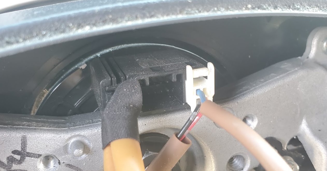

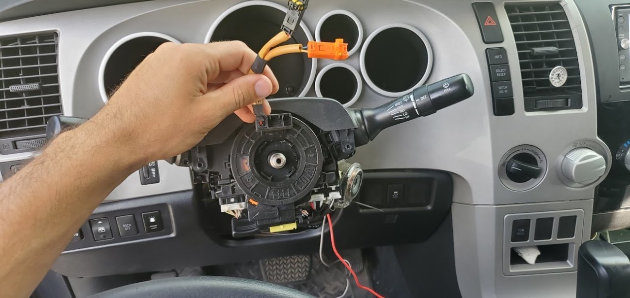

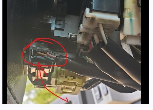

    Access J45 connector
    1. Start the truck and turn the wheel 90 degree to expose phillips screw behind wheel, remove screw
    2. Turn wheel the other way, remove that screw.
    3. Separate steering wheel column trim. You only need to take off the bottom, don't mess with the top.
    4. J45 is on the passenger side of the wheel towards the bottom
    5. Note: Airbag related circuitry is wrapped in a yellow sheath and should not be messed with.

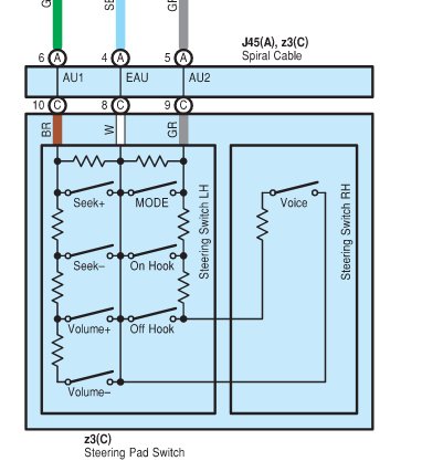

    The 2007 SW controls used 3 wires, SW1, SW2, SWG.
    • SWG is ground (common to all switches)(gets grounded into radio to limit interference)
    • SW1 controlled Seek +, Seek-, Vol +, Vol-
    • SW2 controlled MODE, On Hook, Off Hook, Voice.

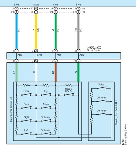

    Wiring diagram below. Quick note on reading wiring diagrams. In a section like this the circle with a letter inside it indicates which connector the pin is on. The green wire is pin 6 on connector (A), J45.
    Here is the complete wiring diagram. Note the resistor ladder. In order to not have 8 different circuits the way the SW controls work is by having 2 circuits (SW1 and SW2) that send different voltages to the radio, depending on what is clicked. For example, if you follow the wiring through the MODE button it passes from the Spiral Cable (clockspring), through the mode switch, then back out to SWG without passing any resistors. However if you press the Vol- button the circuit now includes 3 resistors. You can figure out the resistance for each button with a multimeter.
    My radio (Sony xav-ax100) accepts SW control input via a 3.5mm jack. Your standard set of headphones (without a microphone) are wired like this a common ground, and a left and right channel. To wire in the steering wheel controls to my radio we would wire SWG to the ground ring, and SW1/SW2 to each of the LEFT/RIGHT rings.
    My Sony radio allows me to set custom button setups in the setup menu. Basically you choose the fuction on the screen then press the button on the wheel. If you don't have this option you will need a converter. Something like this. But, mine can be customized, so I can save the $70.
    There is one issue though. Here is the wiring diagram for the 2016 steering wheel controls.
    It has SW3! A third channel to send voltages through. But our 3.5mm jack can only accept 2 channels. You could simply wire up 2 of the 3 SW channels and the ground but you would loose 4 buttons.

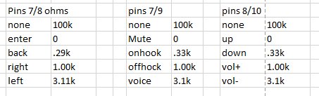

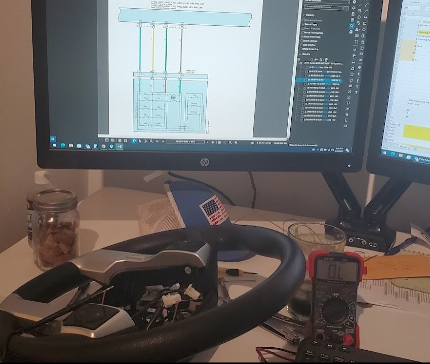

    First thing I did was test the controls on the bench. You don't need to have it installed to do this. Just hook your multimeter in Ohms mode up to the corresponding pins on z3 and press a button to find out the resistance. These were my results.
    So each set of 4 commands uses the same resistance ladder. After some experimenting I came up with a solution to be able to utilize only 2 channels of inputs. Simply tie SW2 and SW3 together! But wait. That means that the onhook/left button would send the same voltage, and the same for all the other corresponding commands. To solve this I added an additional 3.7k resistor coming out of SW3 before connecting it to SW2. This added 3.7k of resistance to every command, brining it up to 3.7k, 4k, 4.7k, 6.8k. It worked! Well, it worked 90% of the way. it turned out that the difference between 3.7k and 4k was too close so my radio couldn't differentiate between enter/back button. But, I didn't need the back button anyways so I just ignored it. The radio needs "clearly defined" resistance ranges".
    That's it. The whole process took weeks to plan and learn how to read wiring diagrams, order parts, rent tools, learn to use my multimeter, etc. The actual install was completed in less than 2 hours.

    Looks like I used a 3.7k resistor in my setup. This may be something you have to play around with and see what kind of separation of voltages your head unit is looking for. This is something you can do with the steering wheel installed; you are making the connection between the J45 (the connector at the bottom of the steering column) and the head unit after everything is installed. You may be able to find a different resistor that works. The issue is you have two sets of buttons outputting the same 4 resistances. You need to add a resistor to "shift" 4 of these up into a higher range. The issue is as you get to a higher range it seems like it is harder to tell them apart. (the difference from 0 to .33k is a lot easier to detect than 3.7k to 4k, even though they are both 0.33k jumps).
    Play with the resistors you have on hand. If you understand what you're trying to accomplish you should be able to guess and check from here. If you don't have resistors I recommend buying a variety pack from Amazon - I got a pack of like 100 in different values for like $10.

    Nothing crazy going on here, just a careful reading of the wiring diagrams. Learned everything as I went.

    I thought I had it working but it looks like this headunit is not sensitive enough to pick up the low ohms and has a hard time telling what buttons it does recognize apart. That said another forum said this headunit requires additional resistors to make sw1 and sw2 work properly.
    Two questions:
    1) Did you use 1/4 or 1/2 watt resistors? Sounds like 1/2 watt are for powered applications and since this is just signal/switches 1/4 watt should be ok?
    2) Did you put the resistor in sw3 wire behind the airbag in the steering wheel and then tie into sw2 or did you do this further downstream behind the raidio running an extra wire for sw3?
    Thanks!

    Can you share the link to the other post. I'd be curious to read that.
    These are the resistors I used.
    ELEGOO 17 Values 1% Resistor Kit Assortment, 0 Ohm-1M Ohm (Pack of 525) RoHS Compliant https://www.amazon.com/dp/B072BL2VX1
    I put the resistor on the connector exiting at the base of the steering wheel, prior to the wire running to radio.

    I am pretty sure I literally just stuck the resistor in the J45 pin holes, after the clock spring. J45 shown in the picture below, resistor is not in yet.

    @chrisf111 so I’m trying my best to understand the controls section of your write up. If my current original steering wheel already has controls would I need to go in on all this wiring or would it be a bit more plug and play? Also when you say you can program your controls via the radio is that necessary per your set up or for all applications?
