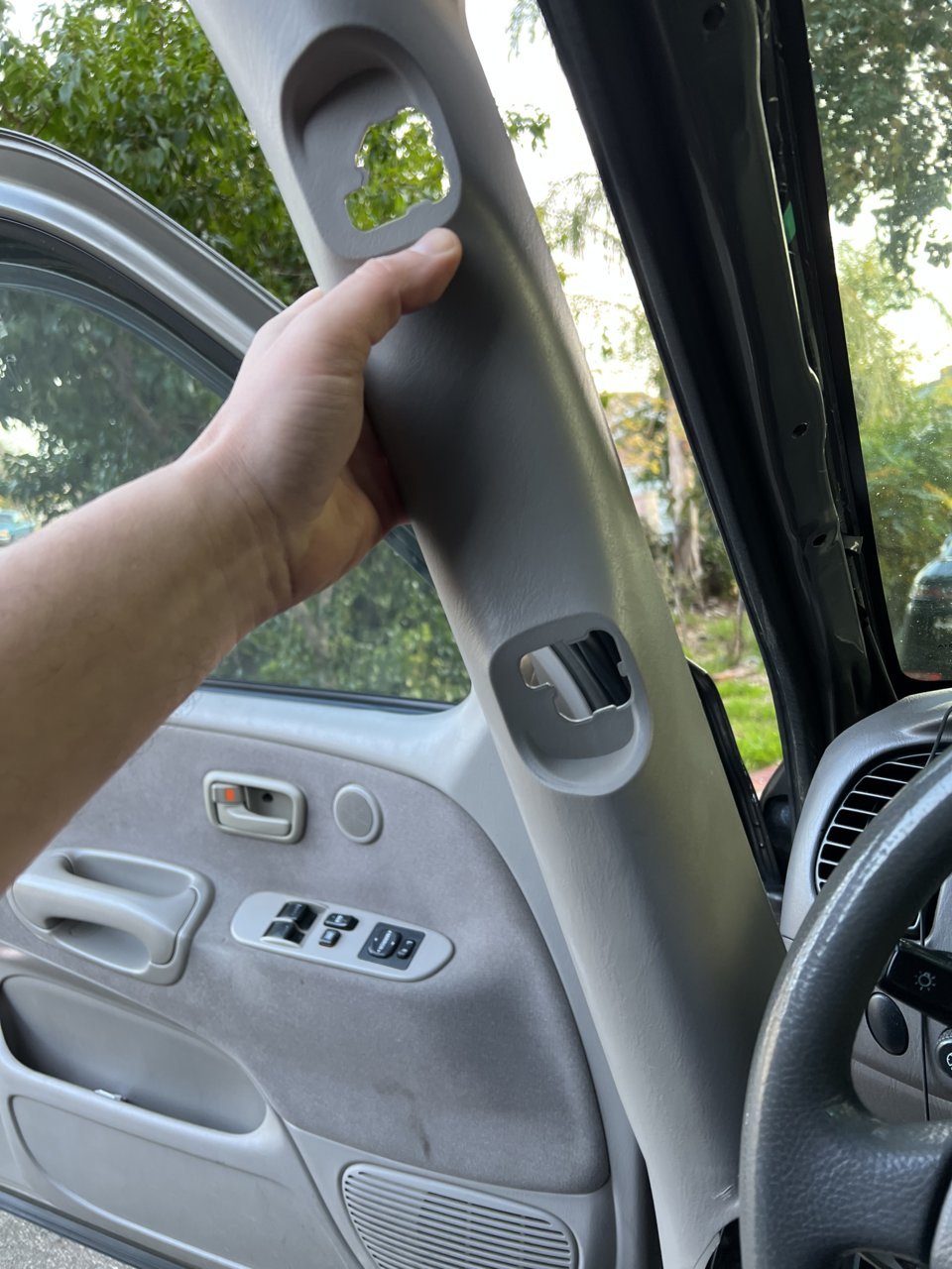

    Wanted to install a Ram mount and thought I should ask before I break anything. Need to remove this section…
    Took the bottom molding off
    The top section feels like I can remove easily but I’m wondering if the dash would get in my way? Before I pull anything apart, thought it be best to ask the Tundy fam.
    Thanks!

    It's good
    That comes off with gentle persuasion. Dash is no problem.

    I think down and back is the direction...

    Back towards windshield and up. Popped right out

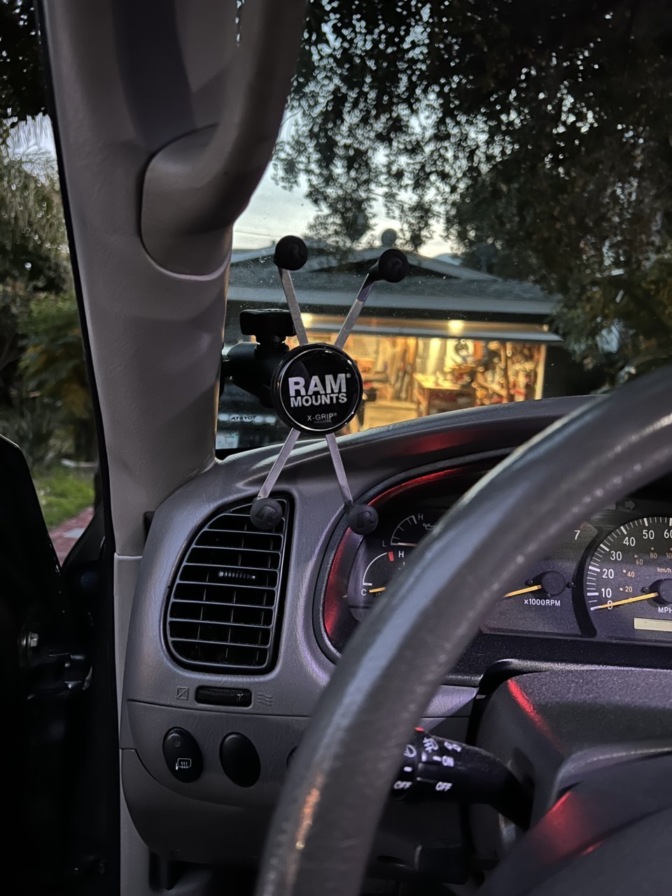

    Got the Ram Mount mounted. Came out great…

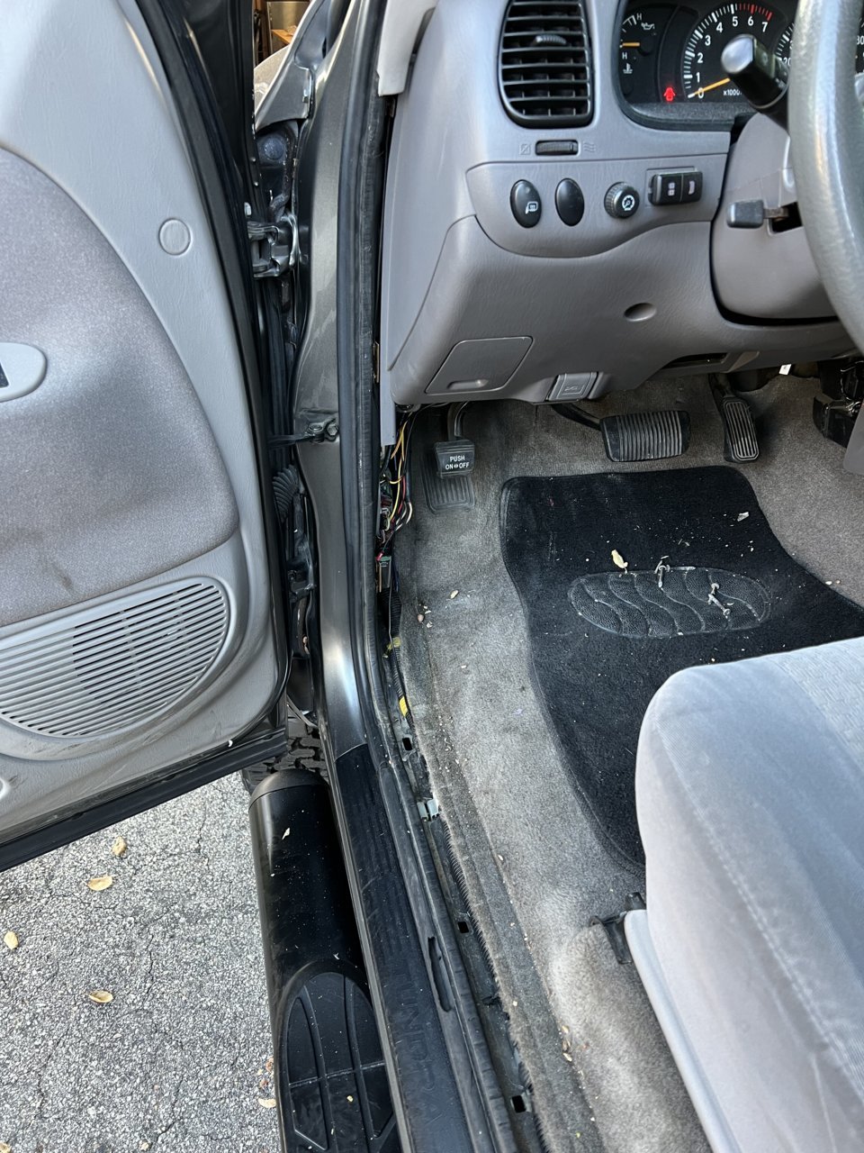

    BUT, I messed something up cause now the cab lights don’t come on when I open the driver side door. Oh boy
    Cab lights turn on with the back door open.
    What did I mess up this time?…

    And my headlights don’t turn off on their own when I turn off the truck.

    Locate the plunger for the front door, it has a door plunger on it just like any other appliance if I recall. Trace back from there. My guess is you're gonna find something disco'd behind the kick panel. I need to head down to my truck to take some pics in a sec, I'll check my wiring too and see if I can figure out what you might've done.

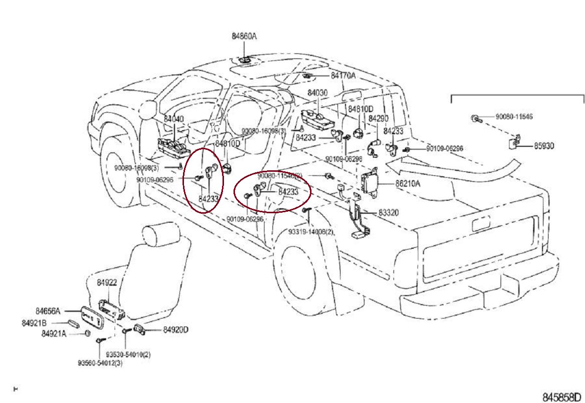

    So I just went out to take some pics of some oil leaking I found to get some feedback on here. I took a sec to check out how the interior lights turn on/off on my '06 AC and I'm thinking it may be different than yours.
    When I open my driver's door, about an inch or two below where its latch is mounted on the rear door, there's a round plunger. That thing is what trips my lights.
    I couldn't find a plunger for the rear door, so I'm baffled how it would fire off on yours. But pushing that plunger mounted on the rear door, below the front door's U-latch, makes my interior lights pop off and on.
    Nevermind: Just read your other post, sounds like your plunger is flaking out. If you have any contact cleaner (I love Deoxit!) you may try blasting it in from the backside and firing off the button several times.

    $23 is the full MSRP, so knock 10-20% off
    Part number 8423153010 (oh, and it may also come with 4 if the Qty field is correct)
    Per this parts page, as shown in this exploded, which suggests there apparently are two of them, though this is for your '03 and not necessarily my '05.

    PS - looks like that exploded is for the DC, but I cross-checked the AC exploded, it also shows same p/n. Here's the proof, both are reference # 84233 and it seems we only have one in AC, is it possible your short is actually with the wiring bulkhead between the rear door and cab?

    I believe that's telling you there are 4 on the truck. The MSRP is for a single part.
