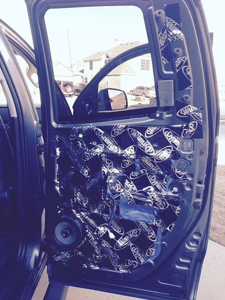

    If you want more door "feel", just overdo the sound deading as I did..:eek2:
