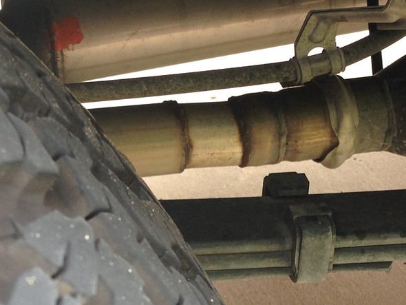

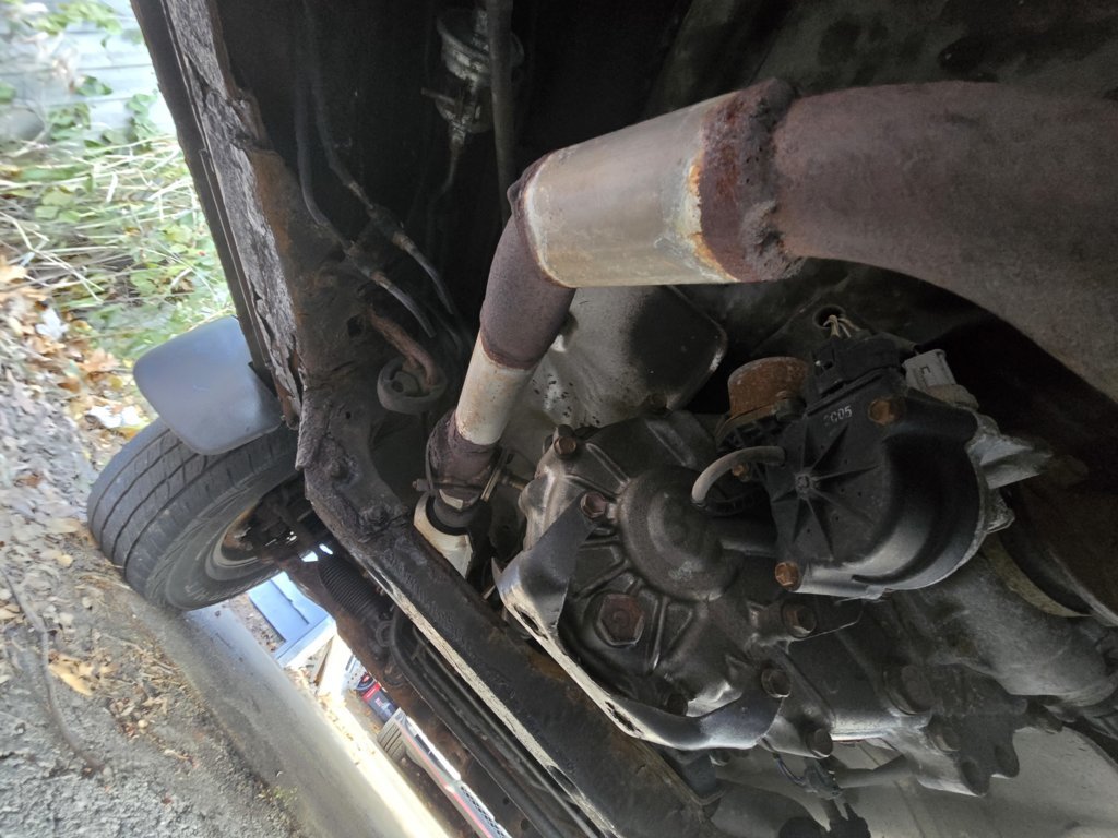

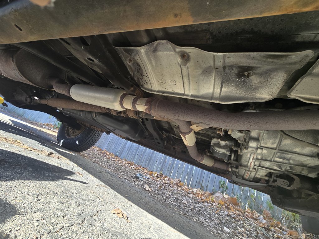

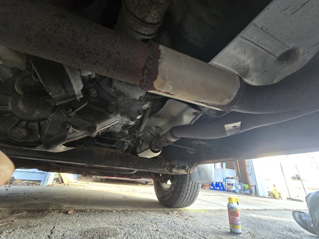

    The previous owner had the exhaust completely welded. Do I need to replace my whole exhaust to get my stock clamp connection back?20241203_122541.jpg

    Wait ... I swore I saw a picture and the Y-pipe is bolted to the cats, then Y-pipe is welded to glasspack?

    I forgot to add the other pictures but it's all one big piece.20241203_142301.jpg 20241203_142308.jpg
  23. Dec 10, 2024 at 4:09 PM
    shifty`
    Jun 20, 2020
    #48239
    31,522
    ATL
    '06 AC Limited V8/4WD
    Oh wow. That's fucked. Someone methed that up real good!
