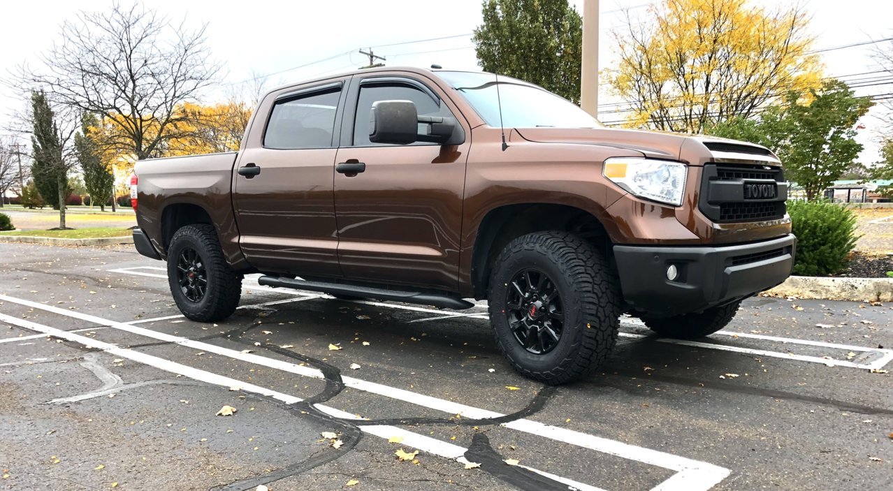

    I went 285/75/18 on stock wheels. They measure 34.8” x 11.4”
    All I did was add 5100 shocks in the front on the middle setting, I get no rub anywhere.

    Just upgraded the shocks and they fit? Looks about how I’m wanting mine to look. Looks great

    yes I changed the front shocks out and it was dead level. It came very close to the skid plate edges so I trimmed it back a little bit as a precaution.
    I already had the mudflaps removed, so I can not speak as to whether or not it would have rubbed those.
    In the photo I posted I have a 1” lift in the rear installed to give me back some of the rake I lost with the leveling shocks, but the tires fit in the rear on stock height.

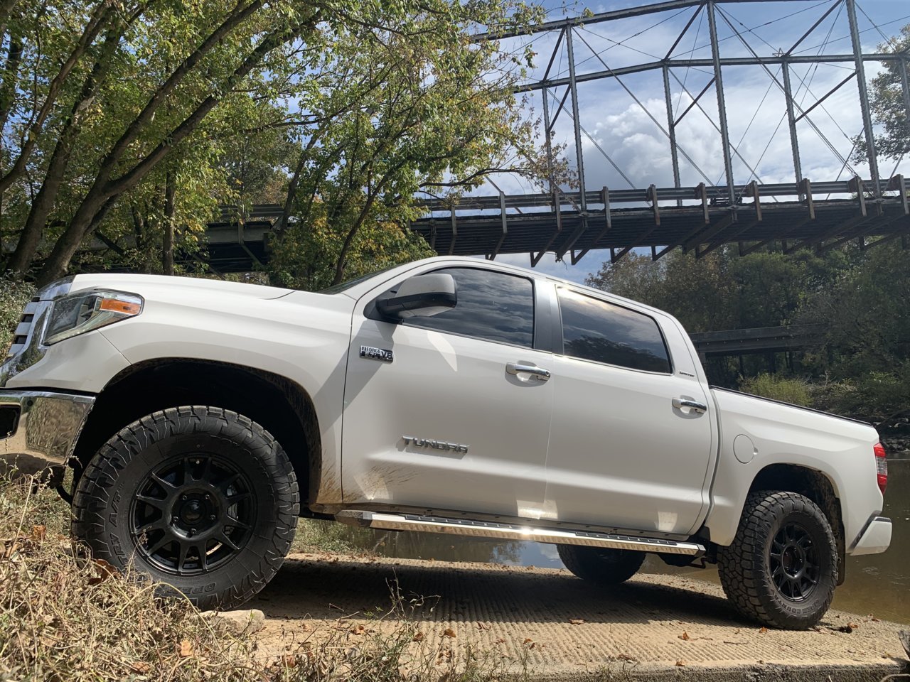

    I have a 2.5inch lift with 35. I took the mud flaps off and had to heat gun the front plastic down a little bit.
