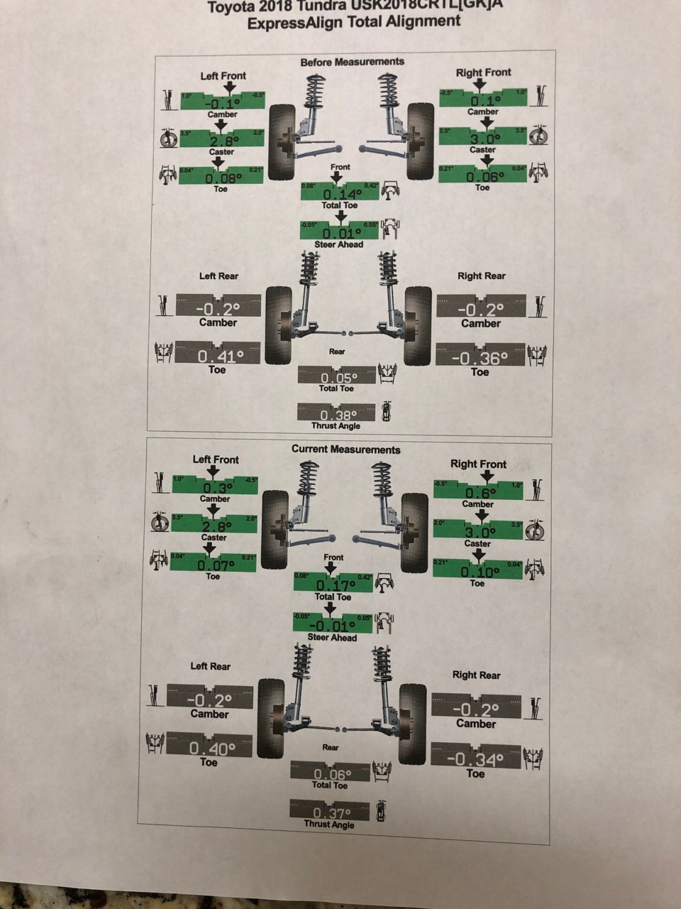

    Here is my spec sheet before and after alignment

    I brought it in to the dealer around 1500 miles the other day as the truck had a slight drift to the left and noticed slight feathering on the outside edges.

    I prefer your numbers before... people here prefer 0 camber but I actually have mine closer to -1 ..
    Either way cross rotations will fix your feathering issue
    My truck has consistent “lane drift” if the road has any kind of curve to it.. try to find a dead nuts flat road and see if it drifts..

    Why did they make your camber worse than it was before?

    Looks like they made it worse...not sure what the factory numbers are supposed to be but for any sort of lifted trucks camber should be closer to 0 or -.1, caster as close to 3 as you can get and toe .12 or so.

    I’m going to be honest with you, it drives completely different, and it feels as if there is 80lbs or pressure in the front tires, and I’m riding on ice, the least little bit of correction on the steering wheel while driving is already over steering.. I hate it,. And I agree with blizz86 as I have consistent lane drift, whichever the lane does or slightest degree in slope of any sort, the steering wheels moves to that side fast, not slowly. It’s hard to explain, .. Before , if you moved the steering wheel to correct, it would stay that way longer or return slowly. What do I do at this point? This is my first tundra and it’s brand new with only 1600 miles on it and had 20 when I bought it.? I appreciate everyone’s help as I know you guys have more experience with these Tundras and professional help..

    Danman34, I only brought it in for slight feathering and slight drift to the left. I specifically instructed them to only adjust if it was out of specs. If it was close, don’t adjust it.

    It wasn't out of spec and they just made it way worse. I'd make them put it back where it was.

    Conlons26, So What you are saying is that my geometry numbers before adjusting were nearly correct? How about toe and thrust angles in the rear? Or is that total overall degrees? Anyone can chime in .... I’m all ears!

    Yes. Your alignment was far better than it was before than the after. Don’t know what they were thinking but obviously didn’t know wtf they were doing. Rear isn’t goin to change since it’s a non steering solid axle.
