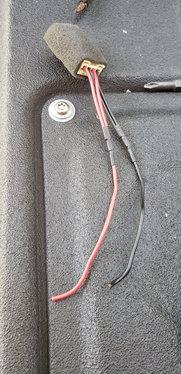

    The non jbl could still have an amp under the driver's seat, non jbl without amp have the front and dash speakers on the same wire single signal 4 ohm speakers in parallel with a bass blocker on the dash speakers. The split junction is about 6" from the dash speakers. There's nothing blocking the highs, they are one way cheapest speakers known to man..if you are not getting any highs, it could be that your unit might not produce enough power for the speakers, it's probably doing 22watts rms to run a 200watt speaker.

    Yes, I figured out the tweeter wiring today, just cut the wires right before the tweeter like your pic of the harness.

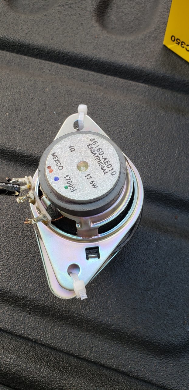

    The door speaker probably has an inductor mounted to it that filters the highs. And/Or the dash speaker will a capacitor mounted on it.
    The wires going to the door speakers are carrying a full range signal, it will be that actual speaker that will have a filter on it.

    Thanks, yes figured this out today - the dash speaker has a filter mounted on it - then the wires to it and the door are full range, which is actually the same way my new JL C1 6x9 components work - they are sending a full range signal to the 6x9 and just an inline filter for the tweeter rather than a real crossover... not sure I like that, but the better component 6x9's go too deep to fit unfortunately...

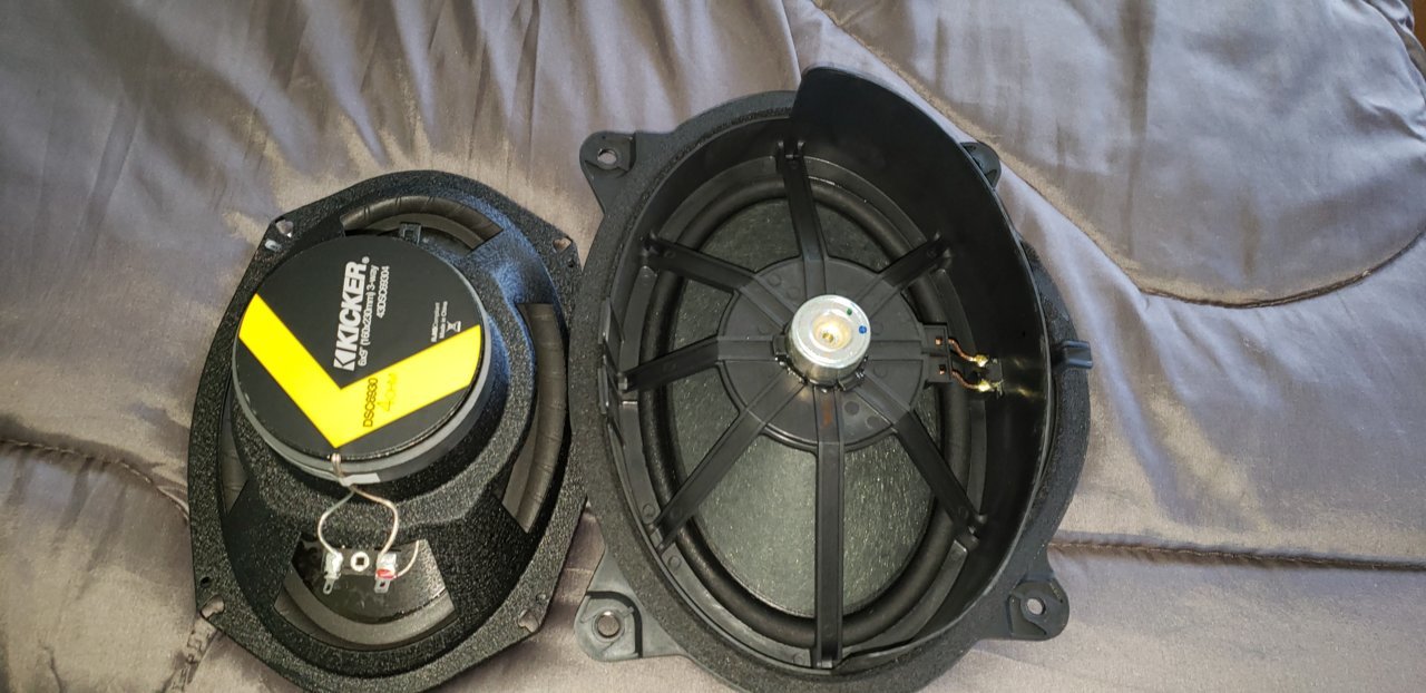

    Does anyone know any hacks for how to fit another 1/2"-3/4" of 6x9 speaker depth? My JL's are already touching the window frame (they are spec'd at 2 3/4" mounting depth) and I'm using standard 1" mounting adapter brackets; if I put a spacer the the woofer will be driven into the sharp edge of the door's speaker grille - that 6x9 shaped edge. Do guys dremel the door panel or anything like that? Any other options?
    I have a much nicer 6x9 component set with a real crossover that I initially bought and would rather run, but the woofer goes 1/2-3/4" too deep to fit unfortunately.

    you can try to dremel but it's pretty tight with 6x9 adapters. if it's not the door, the speaker magnet is gonna touch the window glass behind. lower the window all the way down, not much space to work with imo.

    If you have a router and a flush cut bit then you can make your own.
    My speakers mounting depth is 2.95". I used some clear acrylic and was able to get the right depth. But I'd think there are some adapters on Amazon that should work of your speakers. Just finding the specs of the adapter would be the hard part.

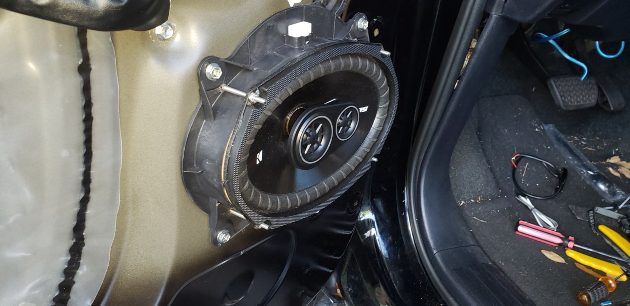

    I used different bolts, however, the magnets sits on the window guide, is not hurting anything.
