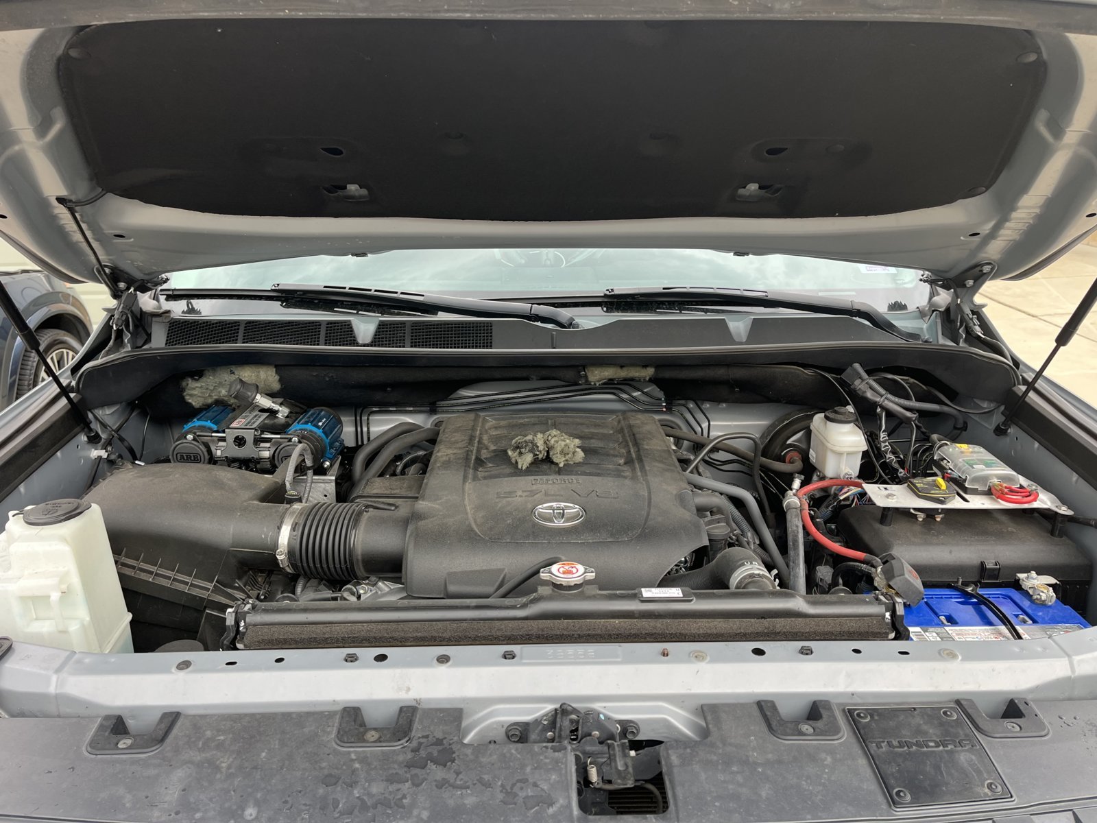

    I went to check my fluids and found a nasty friend has been making a home in the engine bay. Left a nice pile of insulation on the engine cover for me.
    No known wiring concerns yet, thankfully, just the first signs of insulation gathering.
    I’ve read a few kinds related threads on it, but curious if anyone has some tips and tricks they’ve had good success with, to keep them deterred. I don’t love the idea of spraying stuff every week. The Honda wiring covers seem like a possible step worth considering. Curious of other input though.

    mothballs, mint oil on gauze, and very accurate gun shooting :p

    Peppermint oil has worked great for me. I have deer, fox, squirrels, raccoons, and fox that I’ve seen. I also put a k&n cabin filter in, it has steel mesh on it.

    Since the critters are already in that area, I would definitely check the cabin air filter to see if they've made it inside yet.

    If my truck is parked for a time I can see seeds from chipmunks that have been stored in a side engine crevice just below the cover.
    During the pandemic when truck was basically parked, they chewed through the black rubber tubing for the winshield washer fluid. That was fun finding out.
    They also shredded the cabin filter. Good thing the blower motor is an easy unplug unscrew and drop to clean out below the dash. I now pull the cabin filter if its going to be parked for a time.
    Not going through that again.
    I have read if you leave the hood open a bit un latched they won't enter. If your truck is covered in a secure area maybe thats another option. I don't have the option to try that.

    Kinda ghetto, but you can carry some rechargeable lanterns and place one under the truck when you park and pop the hood and put another in there. Mice and rats love the dark and hate well lit areas

    Peppermint oil from Amazon. Drill a hole in the top of a pill bottle lid to allow a controlled release of vapor. I used 3/16 on my first go. Still had plenty of oil left after 7 months so I might open it up more.

    I keep a DIY bucket mouse trap in my garage year round. It's not the most PETA friendly trap, but it's hands down the most effective. *Picture is from the web, but you get the idea*
    Aside from that, I have gotten my truck sprayed with Krown rust preventative for 5 year in a row. Knock on wood, but they've left my truck alone, and it's parked a lot. I barely put 5000 miles it in a year. I don't know if they just hate the oily texture, or the smell, but that shit gets everywhere and I'm hoping they just don't want to chew on wires that taste like oil.

    I do something similar and put an inch or so of antifreeze in the bottom in the winter. In the summer, I'll take the MIG gun and fill it with Argon/CO2 mix. Since I have no dogs the antifreeze is safe.

    Discovered the start of a nest about 2 years ago. Cleaned the mess out of the engine bay and zip tied cotton balls with peppermint oil in each corner. Refresh it with a few drops every month or two. Haven't had any repeat visitors since. Works for me.

    Bastages! Peppermint oil has not been effective for me, but an ultrasonic unit (so far) seems to be working. I would also consider the steps in the "mouse proofing" link above to prevent cabin intrusion.

    One tip for folks getting critters into the cabin air filter — you can buy fine copper mesh. Rodent’s hate chewing it— causes a galvanic response in their mouths. I have wads of that stuffed into the cowl openings under the windshield that direct air into the cabin. Absolutely no problems, and no critters for 3 years there. I do get some in the engine bay, though so looking for further solutions.

    Why doesn't copper wire stop them?

    Yeah, that’s a good point, which I also started thinking about. I know they supposedly like the insulation mostly, but I also see people posting on how they chew through wires. The copper mesh is very flexible and easily stuffed into voids and crevices. Maybe it’s just the barrier that helps, maybe they don’t know how to get their mouth/teeth around it. Not sure, but I do know that nothing has gotten into my cabin air filter cavity and I have found mouse scat in the engine bay.
