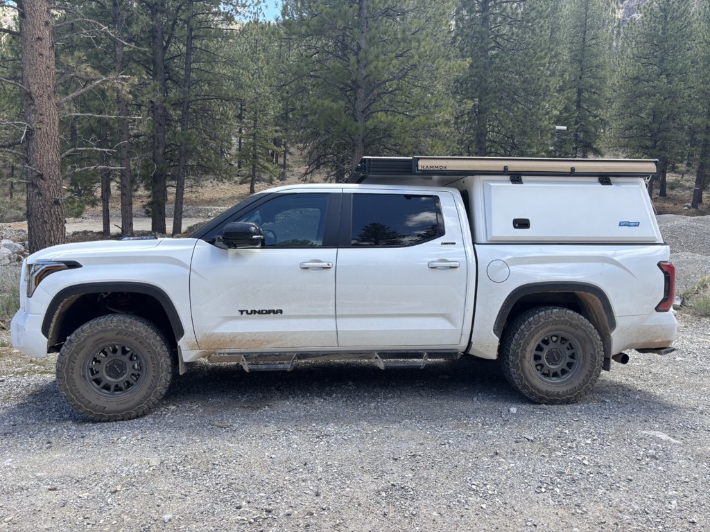

    Hello All,
    Looking for advice/anecdote for correcting squat on a 3rd gen, while preserving the original ride as much as possible. Truck is a 2024 limited crewmax lifted with the OEM 3" front/2" rear Toyota kit. I have about 900 lbs bolted onto the bed in the form of a camper, drawer system, fridge, heater, awning, and other overlanding style gear which is basically permanent. The squat really shows up however when I add an additional 250-300 lbs of water/gear when camping; then it starts to feel like you're driving uphill all the time and there is obvious lost ground clearance. Since the majority of the weight is constant I would intuitively think a stiffer rear coil spring would be best (most durable, simplest, not sure about ride); for example Dobinsons offers multiple rear coil springs specific to load for a 2" rear lift.
    • C59-841V (50mm-2") 0-110Lb Load
    • C59-843V (50mm-2") 220-440lb Load
    • C59-845V (50mm-2") 550-770lb Load
    • C97-147VT (50mm-2") 800-1000lb Load
    • C97-145VT (50mm-2") 1100-1300lb Load
    A local offroad shop recommended airbags which may be more appropriate given the difference in squat generated by putting 150 lbs of water near the rear of the bed (easiest to load and access), but they admit they haven't dealt with this specific scenario. thoughts? experiences? thanks!
